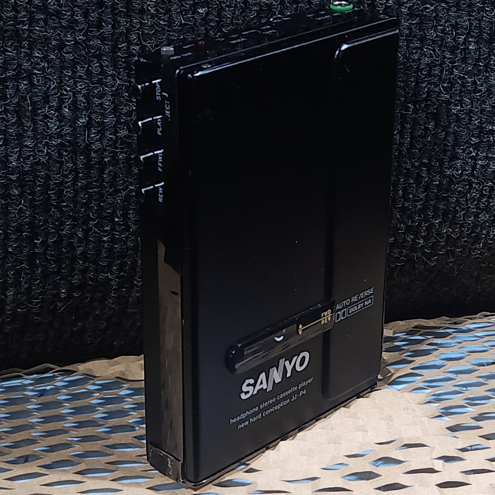

    First item up for sale , FROM CANADA : SANYO JAPAN - JJ-P4 - NEW HARD CONCEPTION - SMALLEST PORTABLES EVER - CASSETTE TAPE 1987 FOR SALE
    THIS UNIT WAS SERVICED APRIL 2026.

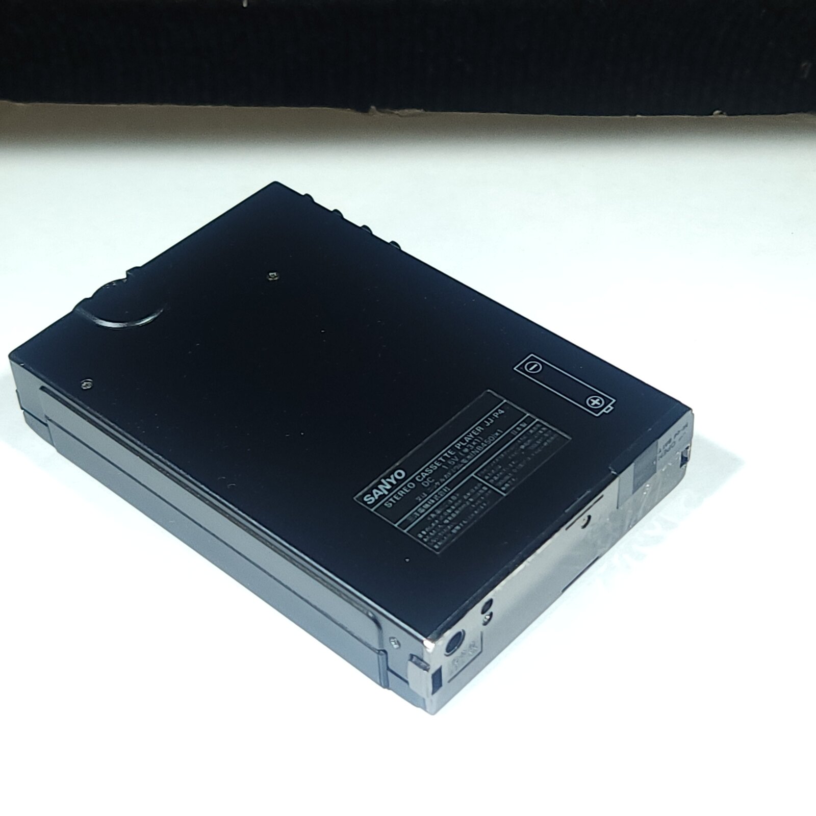

    I BOUGHT THIS IN JAPAN THE LABEL ON BACK IS JAPANESE.

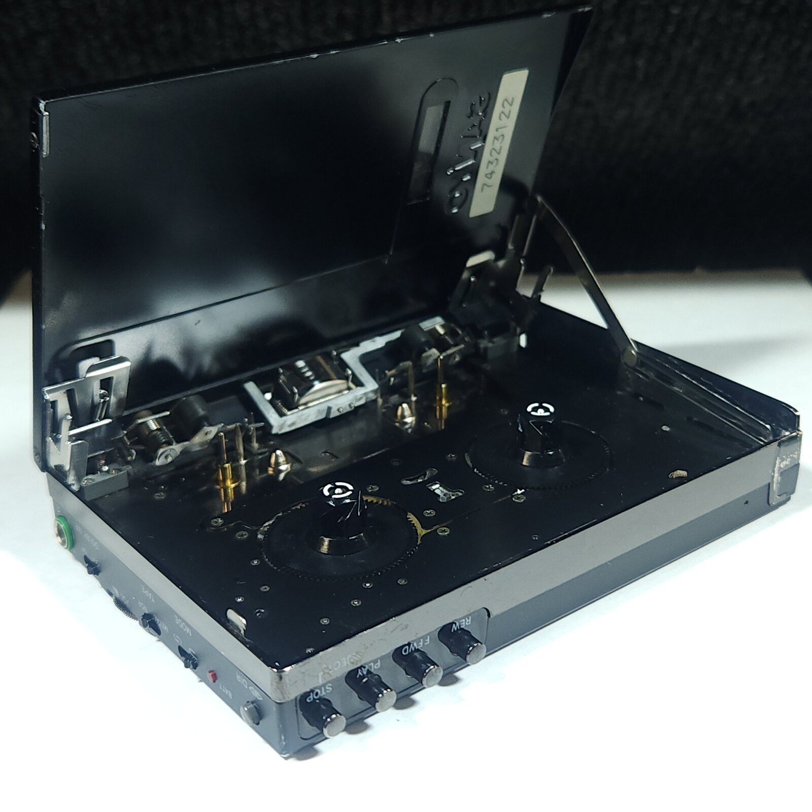

    NEW BELT INSTALLED, OLD BELT WAS TURNED TO GREEN BLACK GOO*.
    NEW PLASTIC COGS ON THE UPPER DRIVE DECK WERE INSTALLED
    AS MANY OLD UNITS HAVE FAULTY PLASTIC THAT CRACKS / TEETH TEAR OFF FROM AGE / MATRIX OF PLASTIC USED. SOME ARE A NYLON TYPE THAT DO NOT BREAK. THE TRANSLUCENT TYPE ARE THE MOST PROBLEMATIC. WHEN ONE OR MORE OF THESE COGS TEETH BREAK IN SOME MANNER, IT CAUSES A HOST OF PROBLEMS LIKE NO AUTO-REVERSE, NO FF OR RWD.. ECT. POOR PERFORMANCE OVERALL.
    THIS UNIT IS A THIN TYPE OF METAL THAT BENDS VERY EASILY
    BUT IS SUPER SLICK AND LIGHT / SMALL. BEAUTIFUL ENGINEERING.
    THIS UNIT IS ONLY TAPE PLAYER NO RADIO, NO BELLS AND WHISTLES
    LIKE BASS EXTEND. BARE BONES.

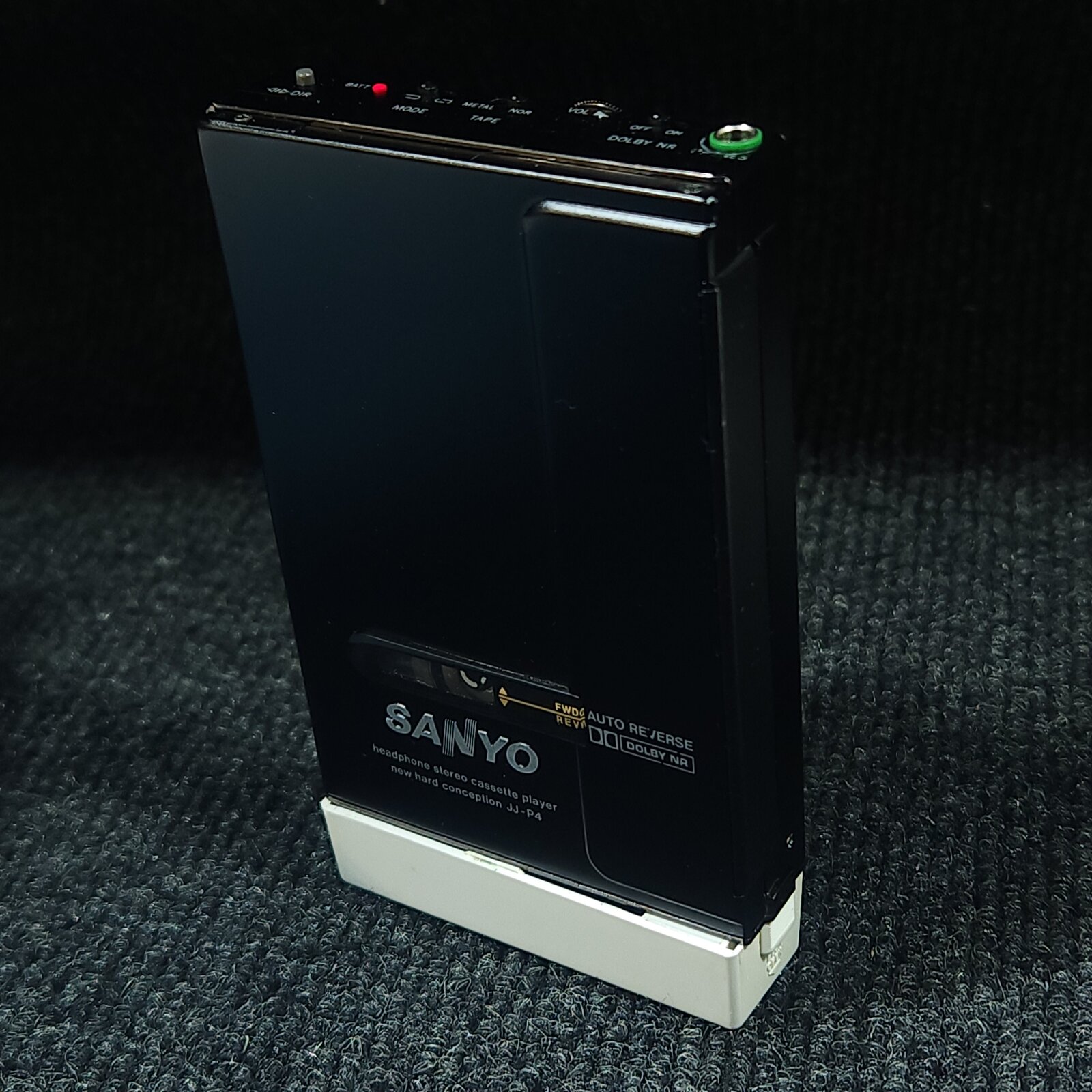

    I INCLUDE THE WHITE BATTERY CLIP ON FROM ANOTHER UNIT THAT WORKS WITH THIS UNIT BUT NOT THE ORIG BATTERY CLIP.
    NO POWER ADAPTER IS INCLUDED - BUT EASY TO SOURCE.
    AS SEEN IN THE VIDEO THE AUTO-REVERSE HAS SOME
    INCONSISTENCY. BUT PROOF OF BOTH DIRECTIONS HAS BEEN
    RECORDED AND SOME MORE PATIENCE IN FINDING THE ROOT OF THE ISSUE IS OBVIOUSLY POSSIBLE SO I'M SELLING THIS WITHOUT FULL
    OPERATION GUARANTEED.
    *THE GREEN SUBSTANCE IN OLD BELTS CAUSES AN ENAMEL BUILD UP
    ON THE SENSITIVE BRASS COGS REQUIRING INTENSE , CAREFUL CLEANUP.

    Like most of these units, the more I use them after service the more they start purring , and I can see closer potential issues
    the Auto Reverse is starting to work more, I think there is a bit of friction in the bottom plate that moves
    the mode switch , so I will look closer to see how I can make it glide every time without this unknown
    random resistance that causes it to hold mid switch of the reverse sometime sticking , sometimes going
    back forward - - so this is a potential 'for sale' I would like to offer a unit that plays as intended without much
    hassle- as a good working item , is predictable and stress free which these can be mainted as .
