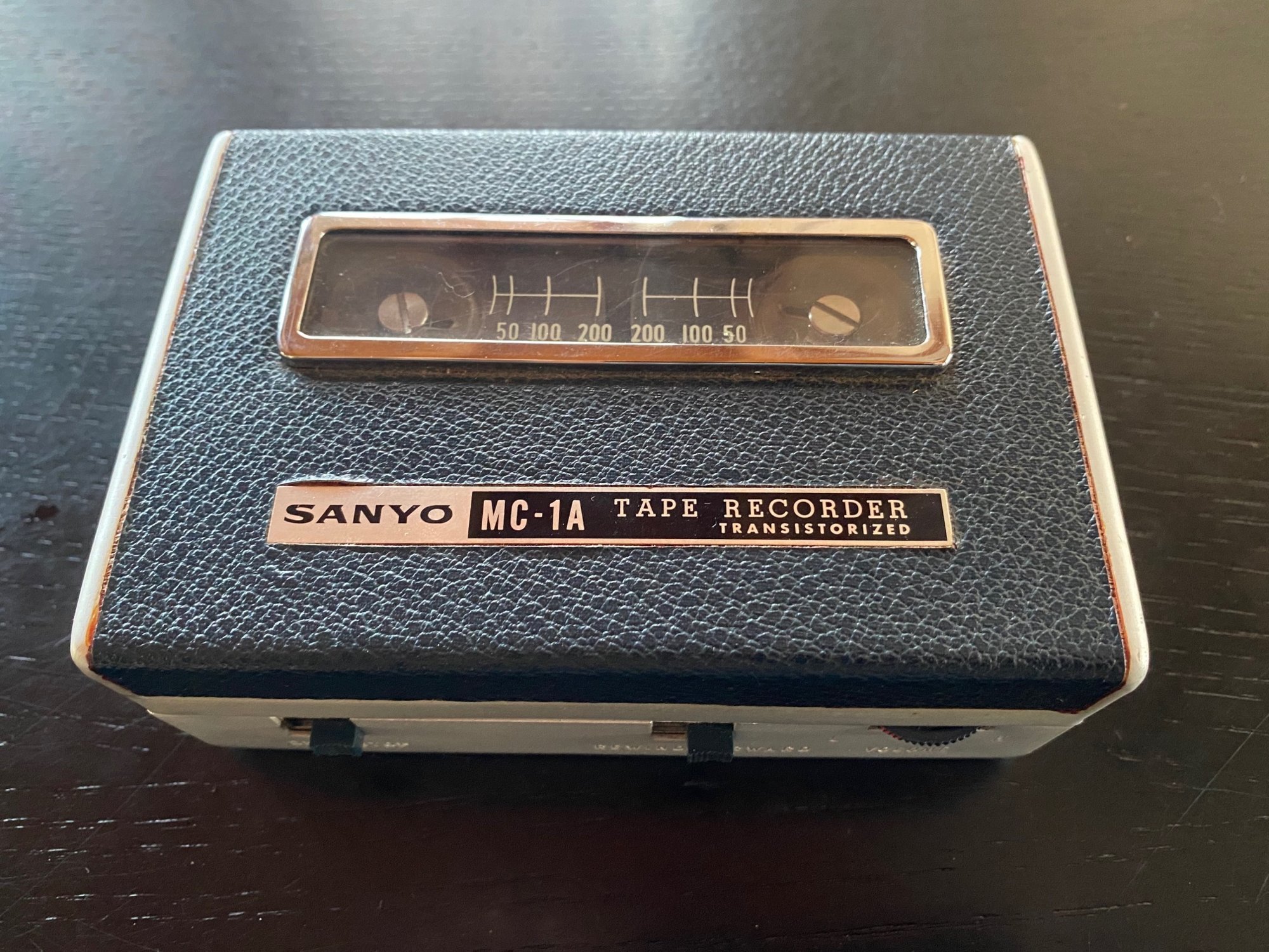

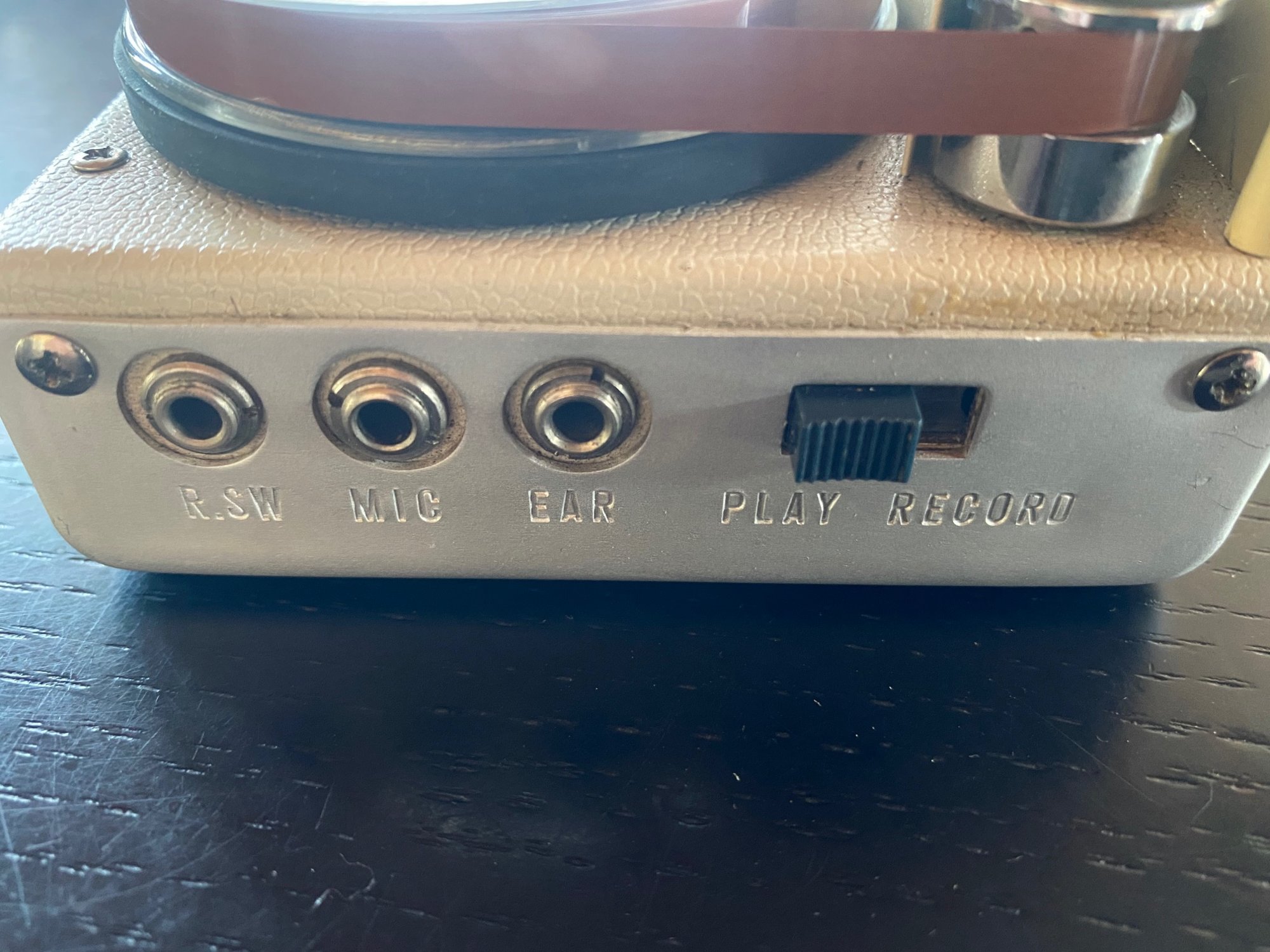

    hey folks,

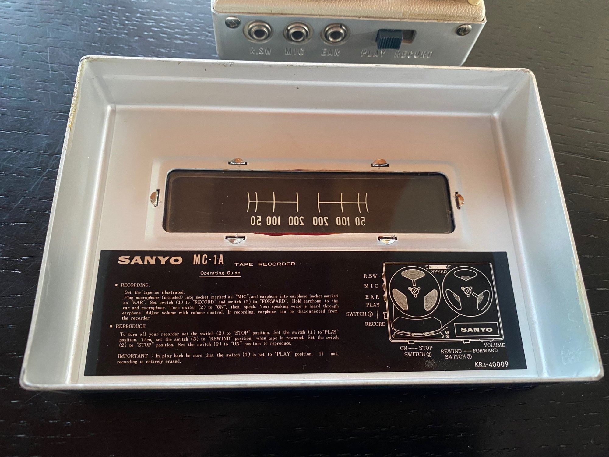

    i want to share this beautyfull pocket reel-to-reel Sanyo MC-1 with you:

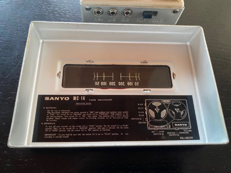

    ...check out those instructions inside the lid - so Nagra-like !

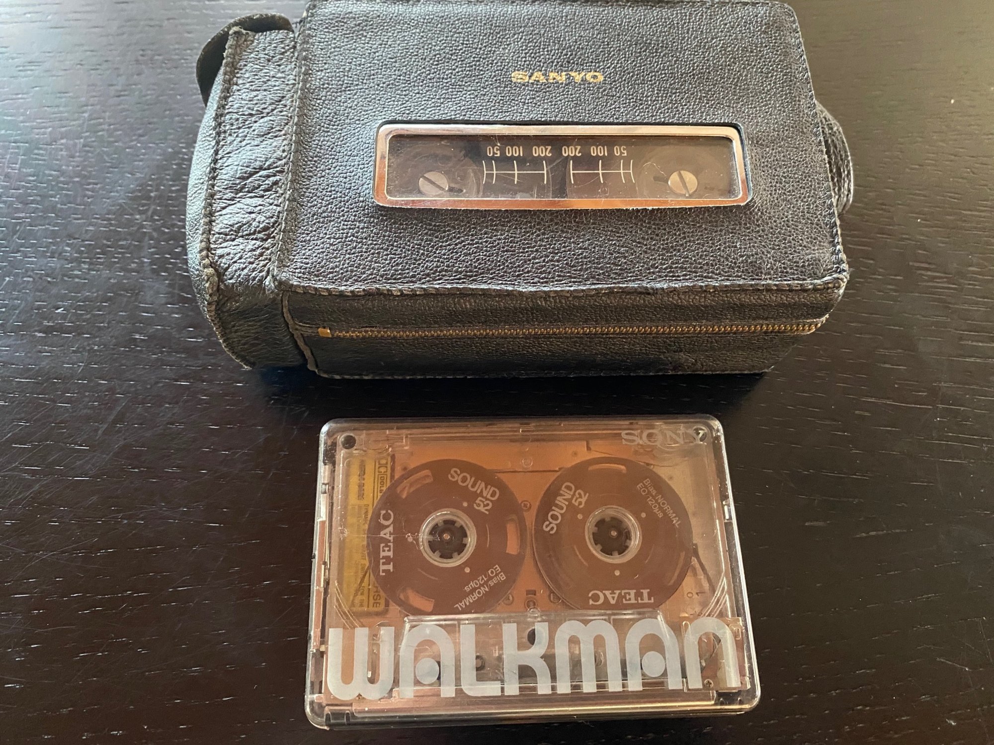

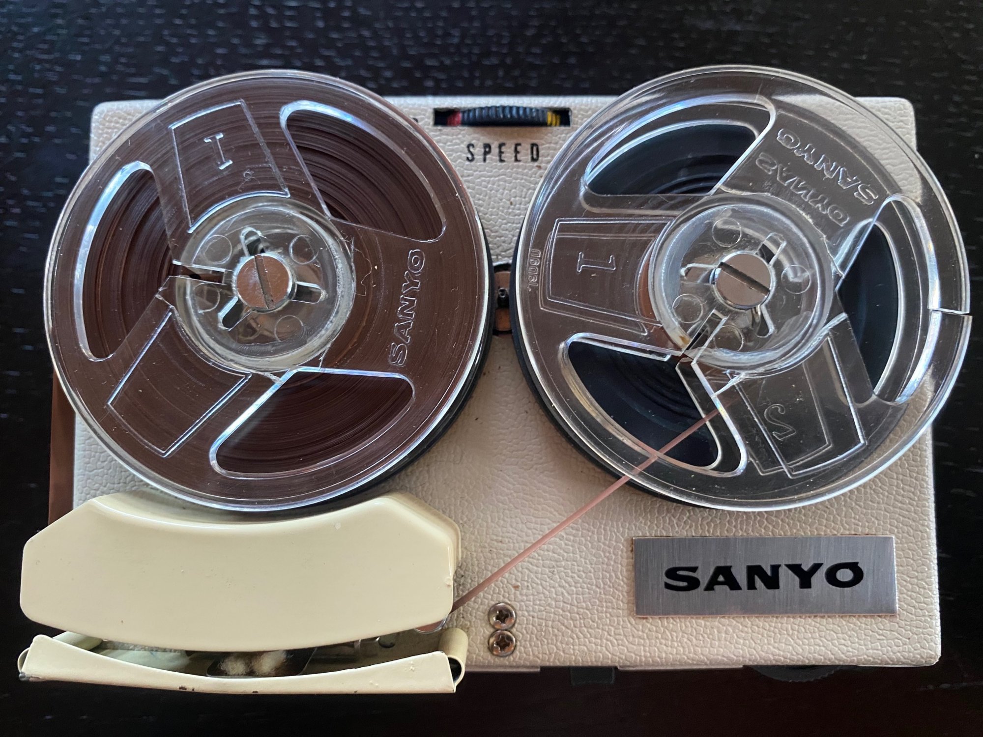

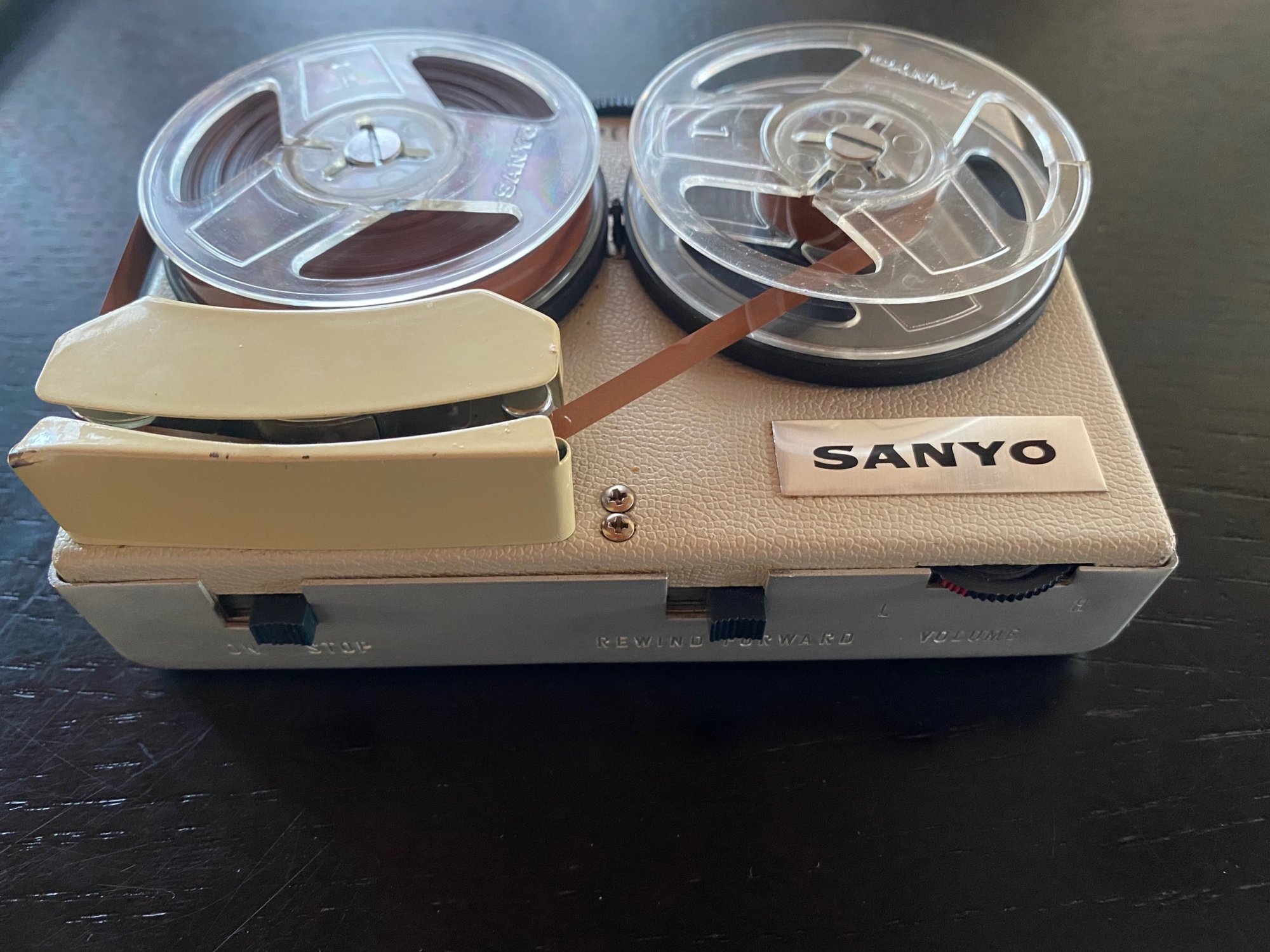

    ...and with a real leather case - check size compared to a Sony WM-504...

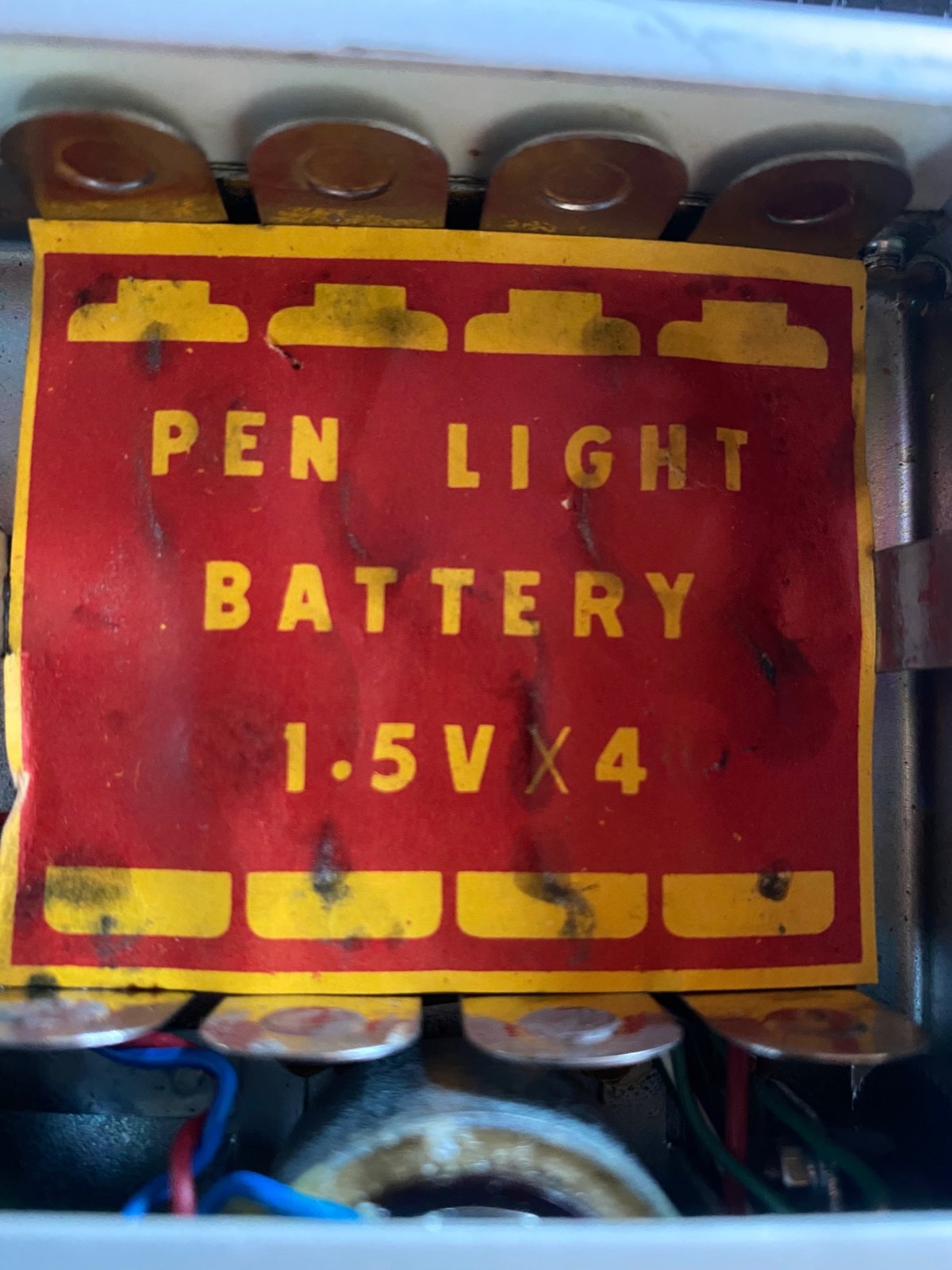

    it's working but i have a problem with the batteries. it says "PEN LIGHT",
    wich are like AA-cells, but something like 3mm shorter so the contacts get
    bent terribly - anybody knows a solution ?
    i can't just put 6v from + to minus, as theres a mid-contact 3V wich gets
    used for the motor in play/rec- mode (...same thing in the Aiwa TP-60)...

    Regarding the batteries Ím sure it was intended to use AAs. However, sizes wereńt quite as controlled back then especially when batteries were Zinc Carbon.

    today i found out, that the AA ENELOOP recheargables do have this mm less so they fit perfect, even in the other ones.

    Back to batteries the usual complaints about Eneloops is that they are too large in diameter.

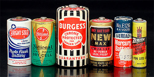

    I love those 60's open reel recorders, especially the small ones, they always have the tape still with them and usually some 50 year old recordings. Check out this guy's battery collection is super-cool, you can see the small height difference with the penlight batteries.
    https://www.ericwrobbel.com/collections/batteries.htm

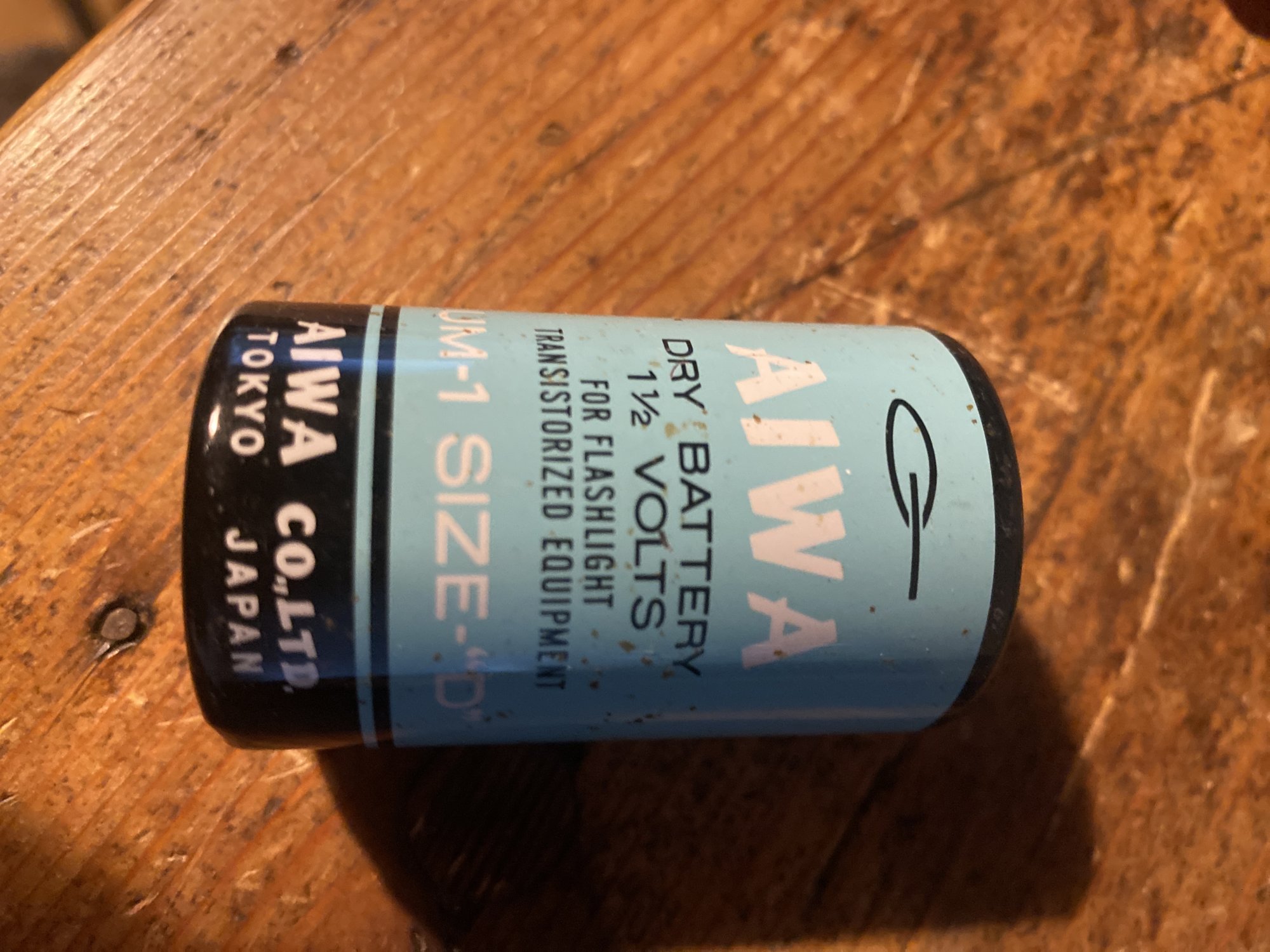

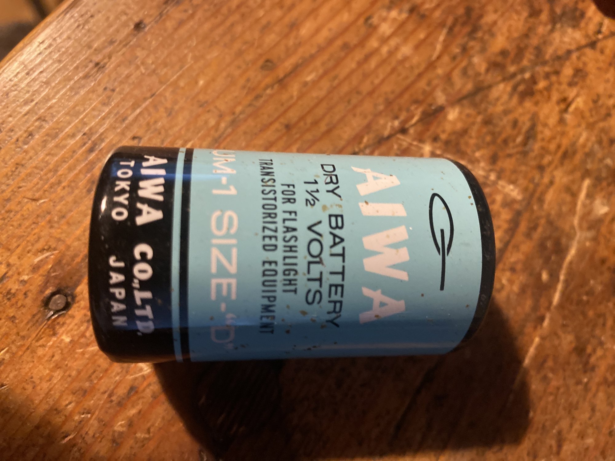

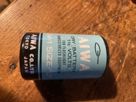

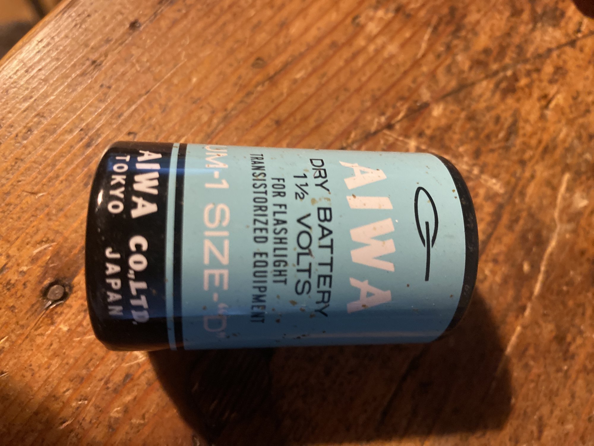

    gosh, what a great site - is there anything this guy doesn‘t collect ?

    He's got a great site, maybe he visit's here? The packaging for the batteries is stunning, so beautiful, whatever happened to cool packaging, I'm afraid with globalization everything is getting homogenized and creativity has taken a big blow. I also miss the early days of the internet when there were a ton of webites like his that were taken away when the parent companies decided free hosting wasn't a good plan.
    Cool battery autoreverser!
  14. autoreverser
    1,939
    ...there should be a 9v block same type somewhere as well - have to dig it out. you can have it if you want...
