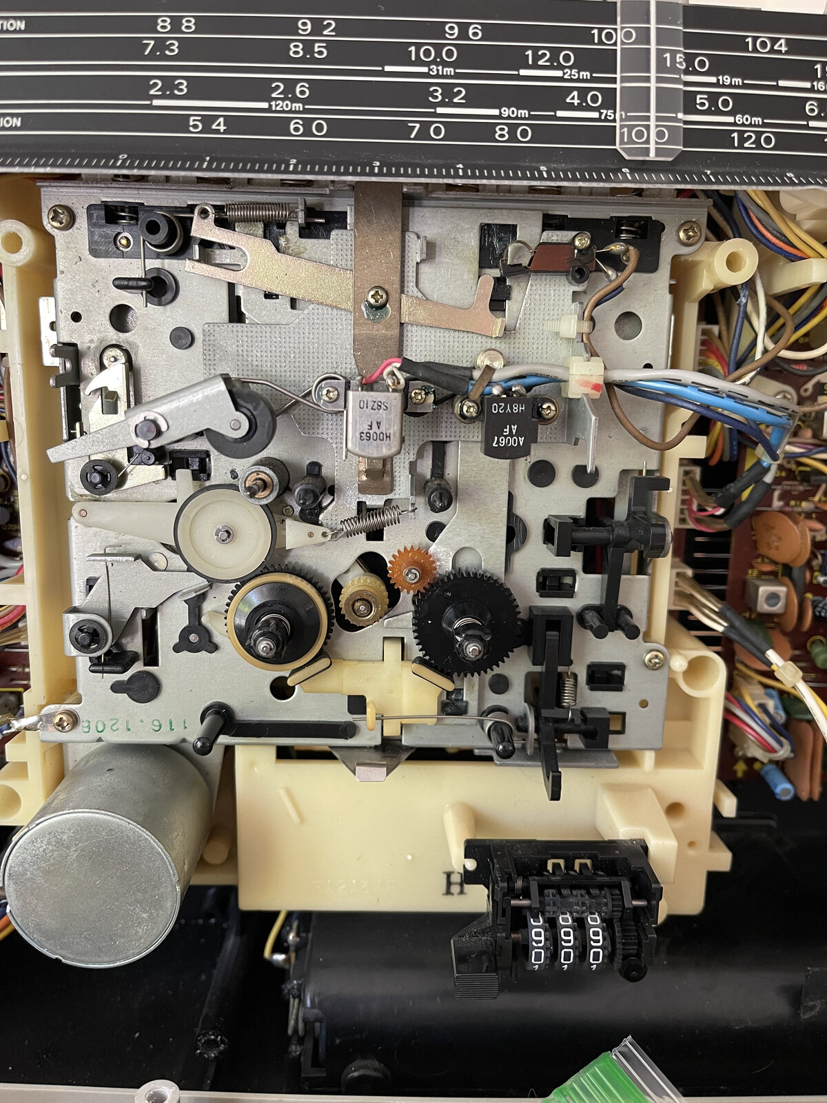

    Hello ,
    I recently purchased Sharp GF-8585
    and having trouble with tape mechanism.
    When I press play button is does not stay in place.
    Any idea what it can be and how to fix it ?

    thanks for reply !
    buttons are moving OK, they just dont lock in place

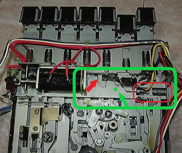

  4. Silver965
    Silver965 Well-Known Member
    734
    Torino
    hello I do not have this boombox but turning on the net I found a video showing the rear part of the mechanism ... check that this part of the mechanism is free and that the two metal parts move freely sometimes due to lack of a spring one of the two parts does not move properly .... those two parts are used to hold the keys in place
    Video
    Sharp GF-8585 X GF-8585X Service Narrated 96 Pictures till crumbled rewind Idler gear - YouTube
    Stereo2Go
    Sharp GF-8585 X GF-8585X How to service with new belt, capstan tire, Idler tire 113 picture's | Stereo2Go forums
