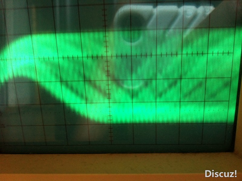

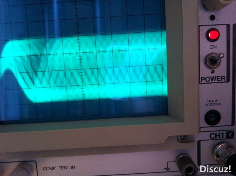

    The eyepattern shows vertical "jaggies", something I have never seen and I am experienced
    with lasers. I posted this problem over @Kaosun, the owner of this forum guesses a detoriated
    coating of the inner lenses but I am not shure as the glass of my D-50 does not show an orange hue as a symptom. Unfortunately I do not have the photograph of the eyepattern and once posted it @ kaosun. I cannot log in@ kaosun anymore -some silly security questions I never made and therefor cannot answer as well as no administrator to reach. So i cannot see my photograph or load it down. But Maybe someone from here can, I think I saw member

    @Herbert, these are your photos transferred here from kaosuncd.com:
    If anyone will be able to help you, that would be Kaosun himself; he is the admin of kaosuncd.com, contact him for login help thru eBay or use his direct email.

    Hi, thanks to all, especially for retrieving the eyepatterns!

    I will show the pictures to a friend who is a retired Sony technician, who did also
    repair CD-Players. The blurred waveform indicates that the coating has rotten,
    but another indication for the rot that the visible part of the infrared beam beam should be orangeis missing. One can spot it in the dark, still a small, red dot. (Never look into the lens,
    always from an angle.) But the jaggies are strange, So I hope something is polluting the signals from the photodiode electronically… Will add pictures pf the bumped lid ASAP.

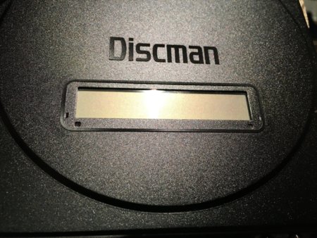

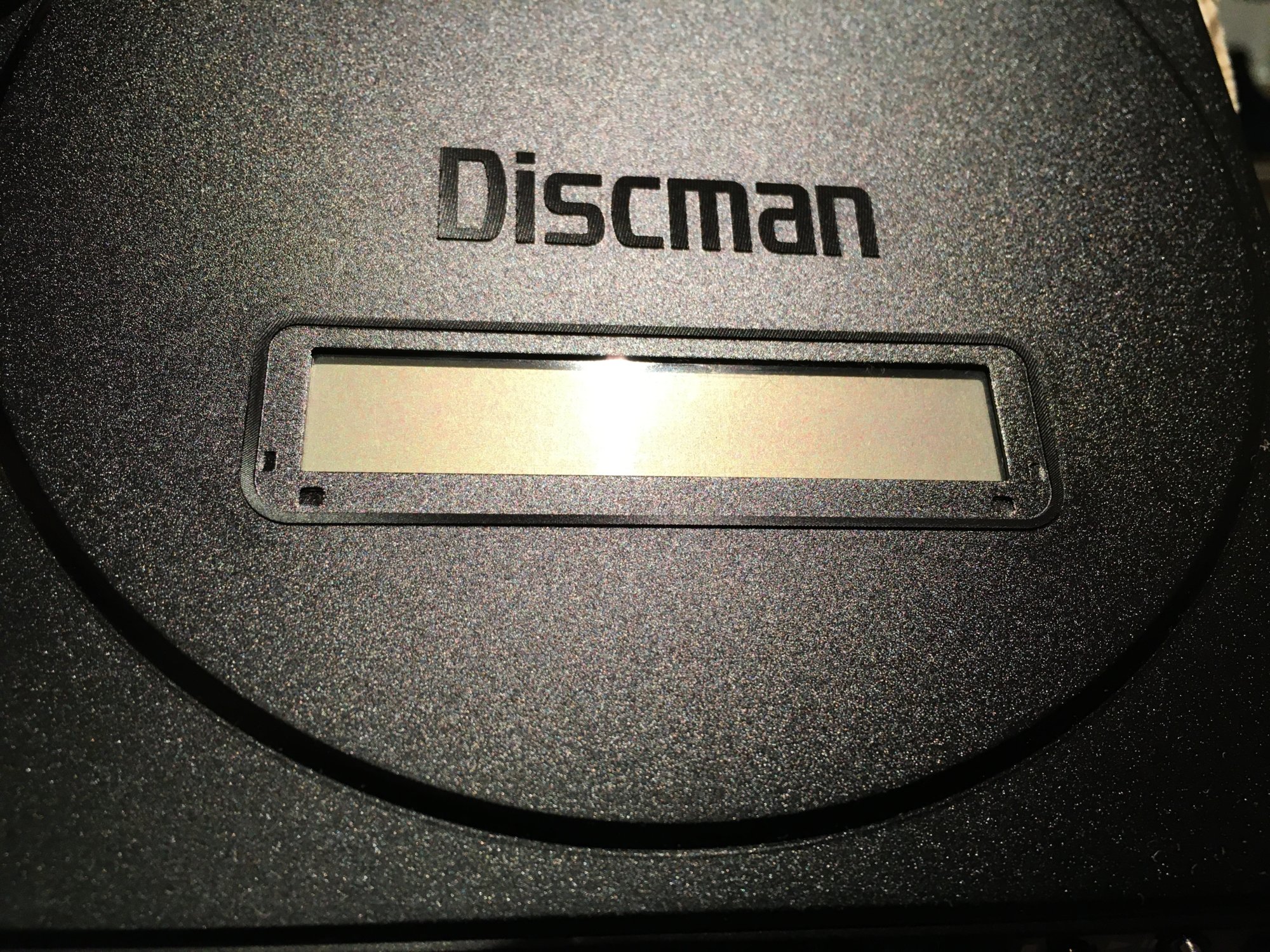

    As promised, a photo of the bumps around the LCD window of the D-J5 // 50.
    It is the dark areas around the left and right edges edges of the bezel
    that follow the shape. They are very faint on the photograph and look more like stains.
    BTW The glass of the LCD is missing for the moment as I am making
    a new one from a special acrylic that is scratch-free.

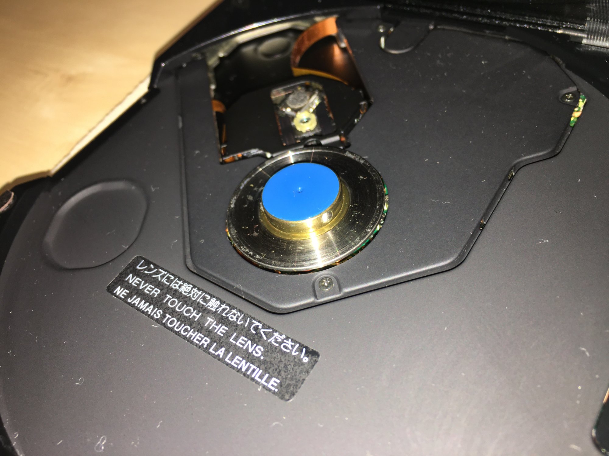

    The other image is the mod of the disc-table, replacing the original
    plastic clamper (that fell off) with one made of brass...
