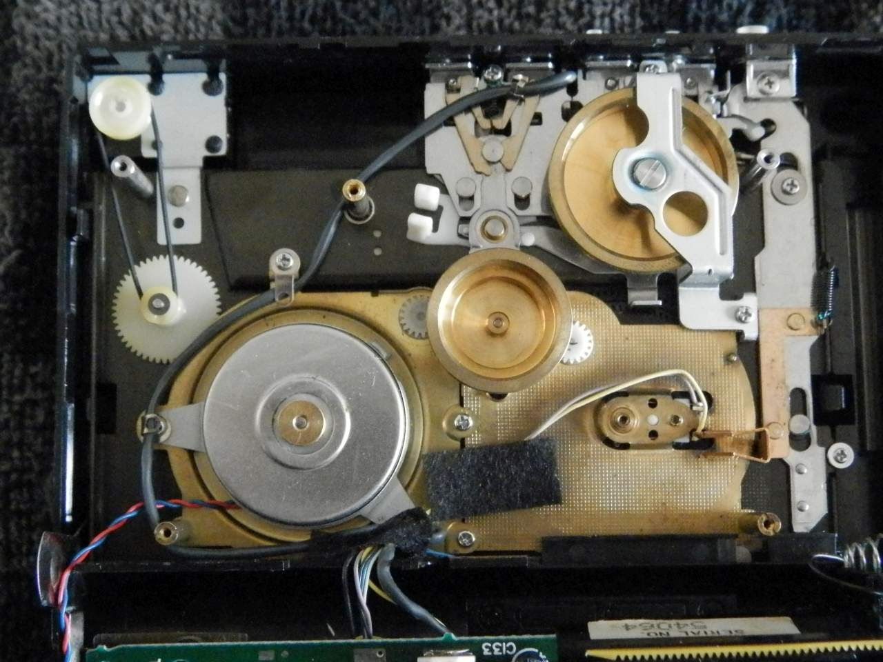

    Check the inside of the WA-4000....1986 quality build...brass baby, brass

    Well i actually think the output is pseudo-stereo, so double mono....at that time you also had the MDR-E212MRV remote which had two jacks, one mono 3.5mm for earphone, and one 2.5mm stereo for the remote. These we an accessoire to the TCM7 and other mono recorders with the remote input.
    This 212MRV has two buds and ofcourse i had to open it up to see how it was hooked up. And basicly both drivers work in parallel, so pseudo stereo.
    I think this arrangement can also be found in the WA2000 and WA4000 but Sony already did it on the circuit board.
    Because the radio is mono, also no stereo FM but that it records on both channels is funny. But both output jacks on the 2000 and 4000 are switched stereo jacks.
    Maybe i'll get that paper sm but seller has to drop his price.
    I'll have a closer look at the head when she is openend up again. To many other babies need attention.
    edit: just did a quick check but it looks like a full track mono head, that would explain why it's recording on both L&R...never seen a full track mono cassette head, for tape delays/echo's yes but in cassette format?
