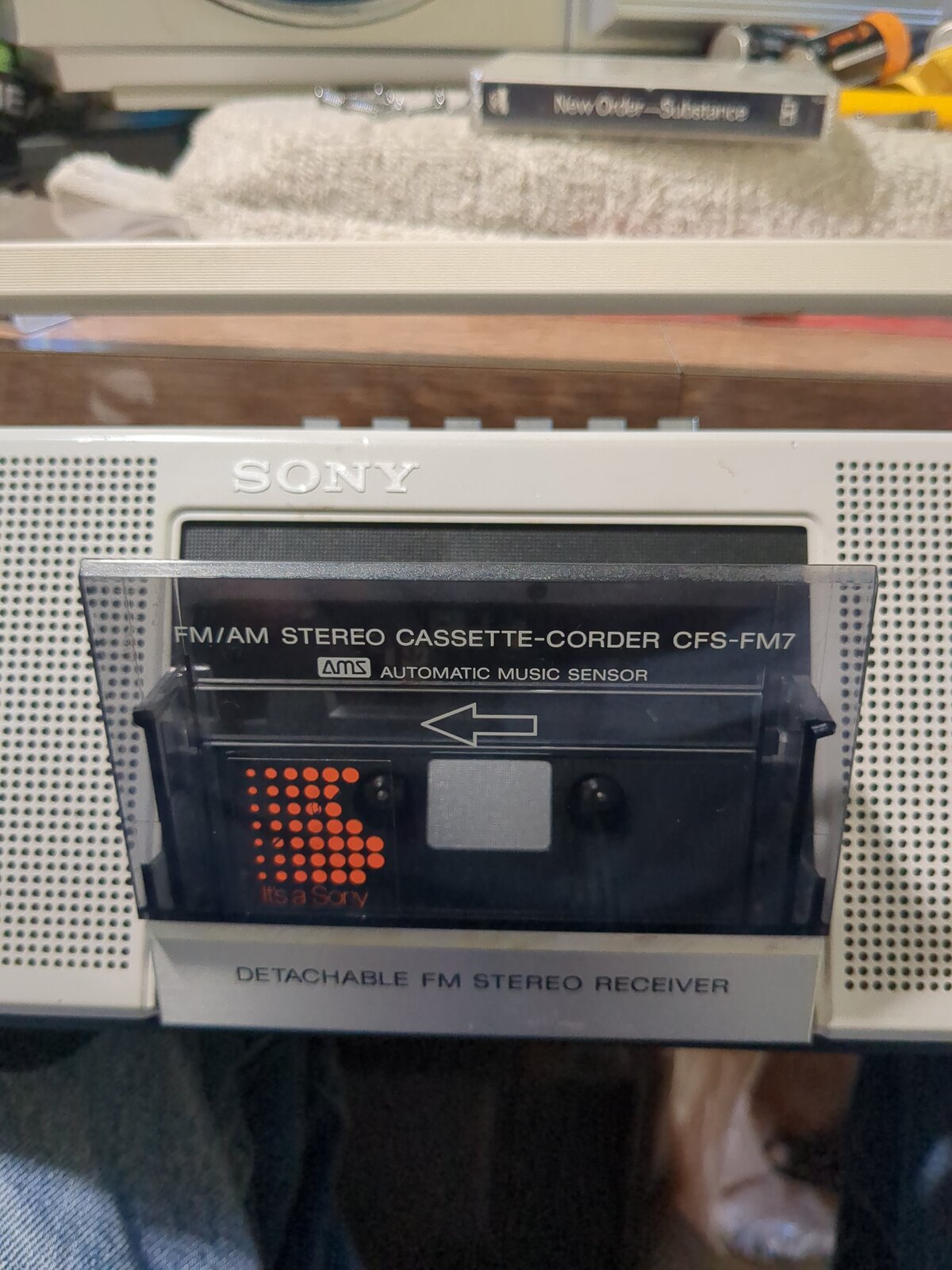

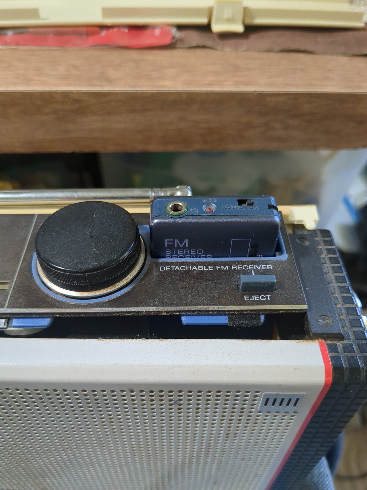

    Sony cfs-fm7 with Sony srf-7 FM stereo receiver insert.
    Top
    Read under the door.
    Yes it pops out when you press the button

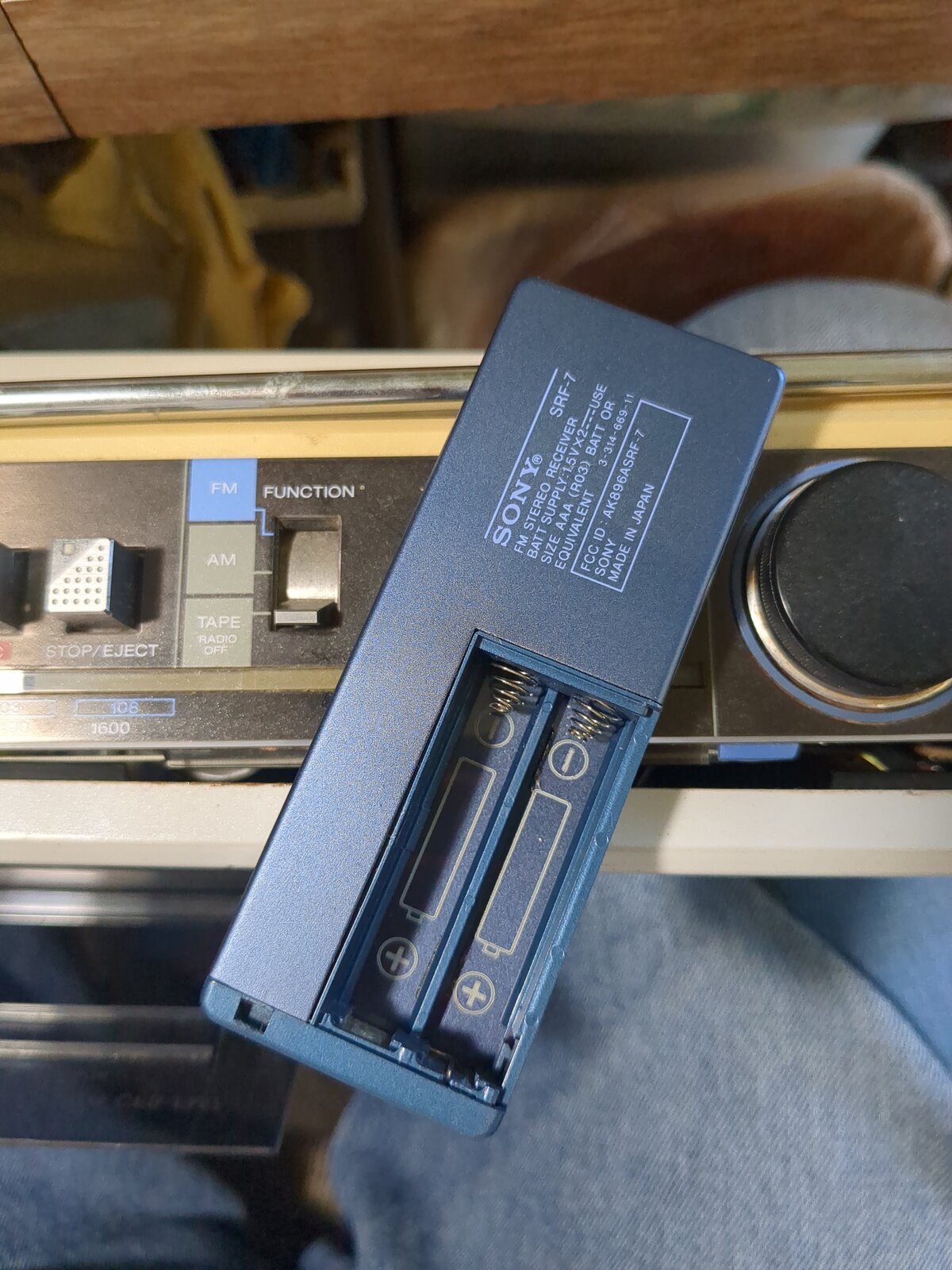

    Yes, my example is missing the battery cover and there is one on eBay for $154 for just this blue thing. FM receiver ridiculous price.

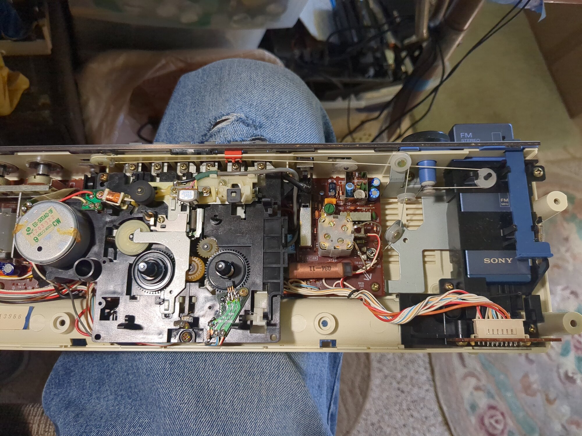

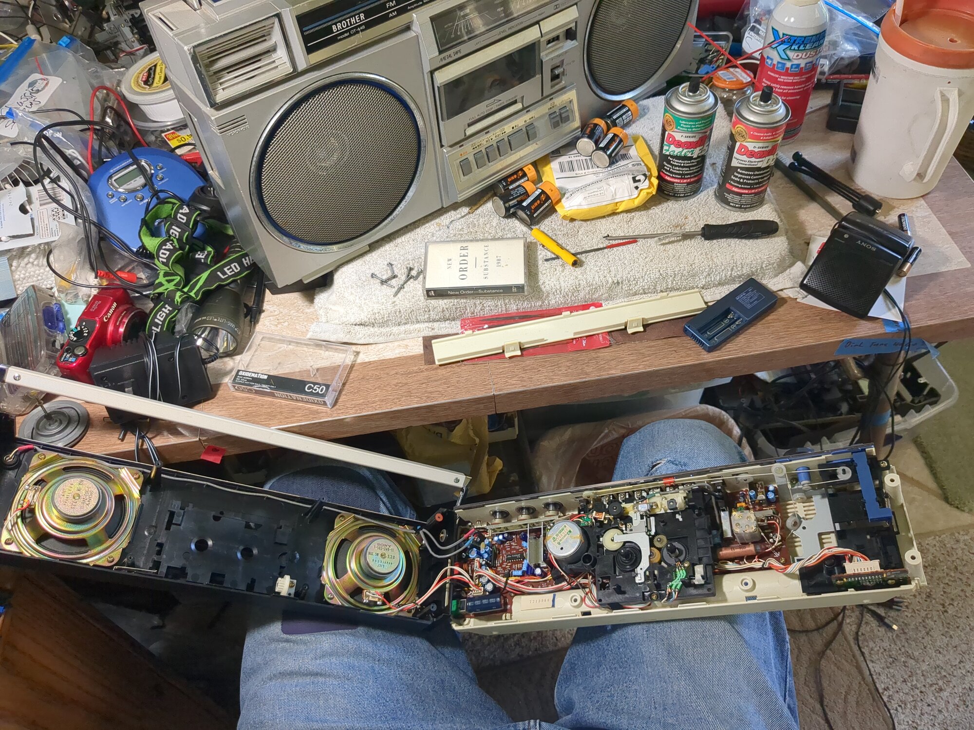

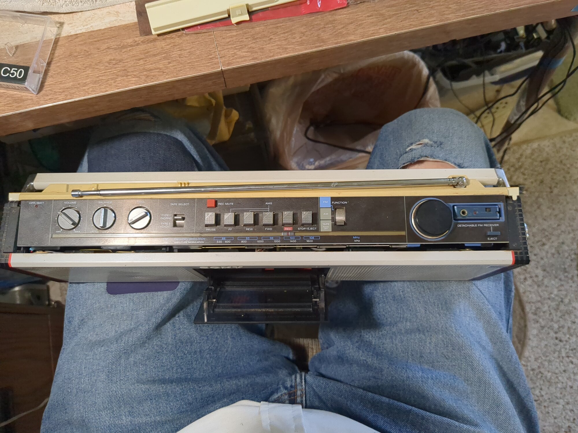

    You take eight screws out the back and you can flop it open like this after you open the cassette deck door.
    Mr. X, take note there's a lot going on here. You have a complete cassette mechanism next to that you have your Am tuner and next to that you have the receptacle for the FM tuner pop out. Srf-7 unit notice the wire is going back to the Am radio which obviously does not pop out. Therefore, you have sound with the main unit am only without the blue FM unit inserted and of course the cassette deck. With the blue Sony srf-7 installed. You also have FM stereo.

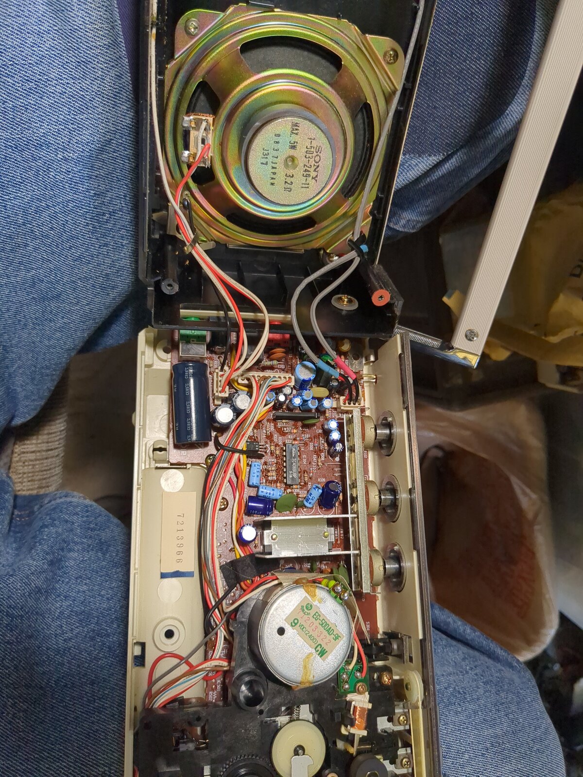

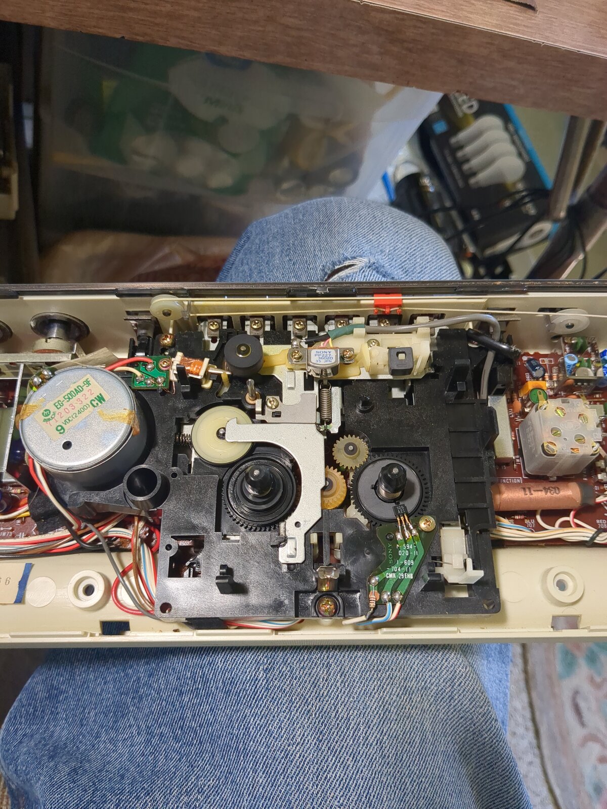

    Just one speaker the amplifier and the cassette deck motor. No date code on the motor only those numbers.
    Cassette deck does have amss therefore you have the little pull-off solenoid near the pinch roller to assist in that operation. Also, there is a speed control over the rewind spindle I believe magnetic pickup.

    Once you get past the video scrolling up, go to the third picture upwards and zoom in on that and you will see that the tuning cord goes under the circuit board to rotate the variable capacitor tuner and it then goes under the cassette deck and then returns back up to the tuning indicator and then it travels across and it returns and goes back under the circuit board again. Can you see that?
