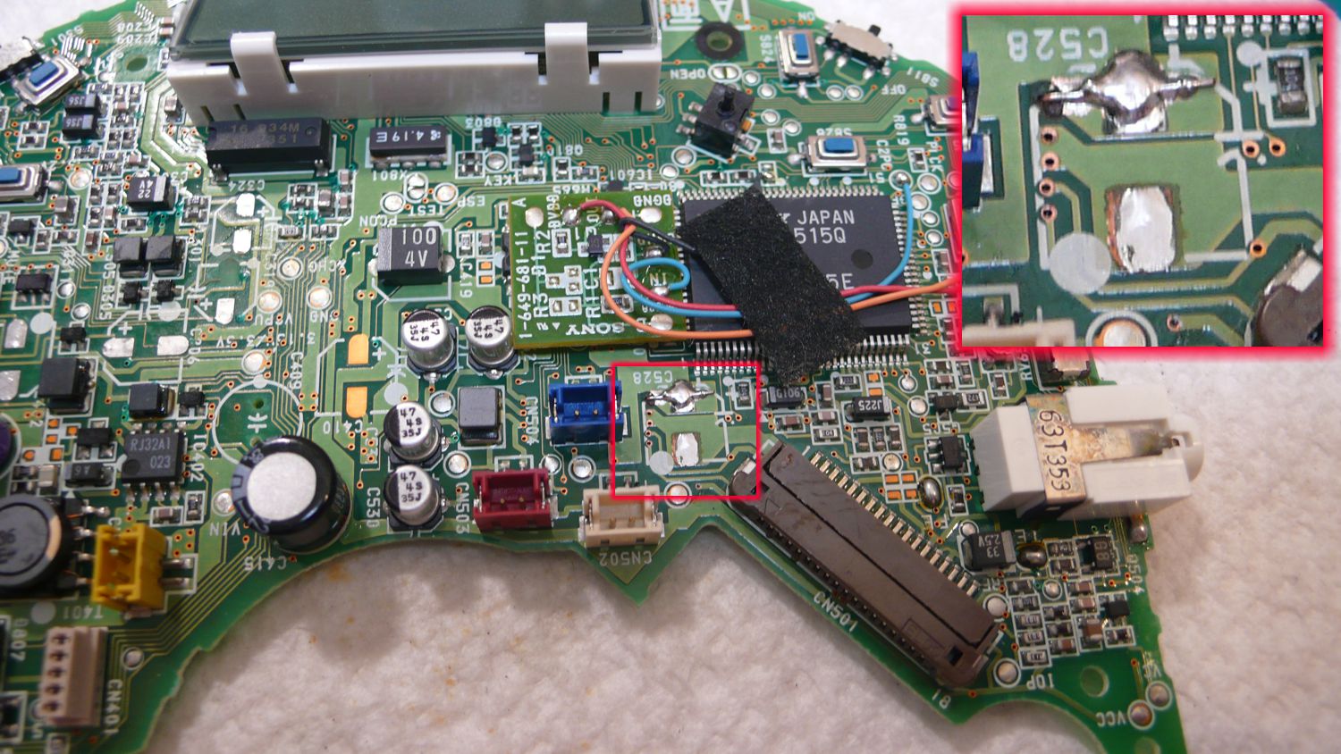

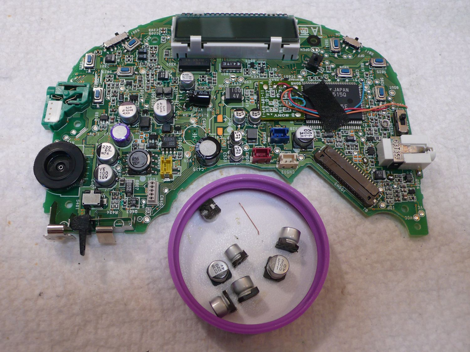

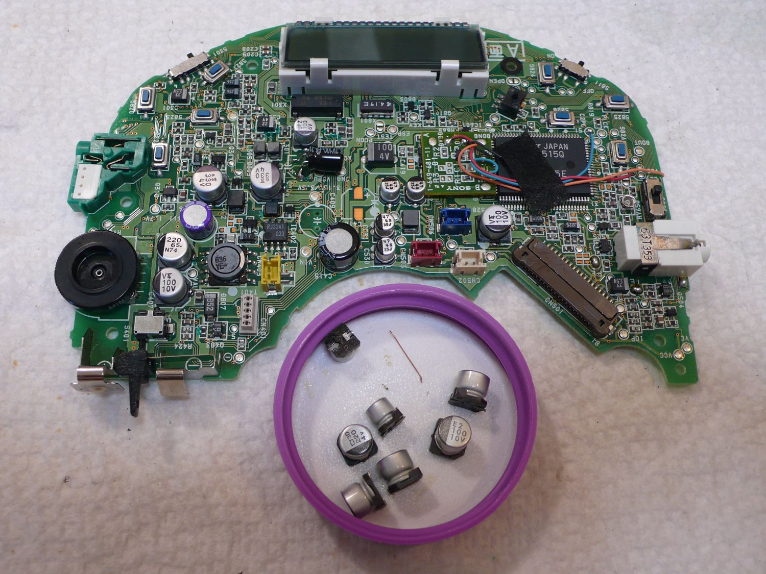

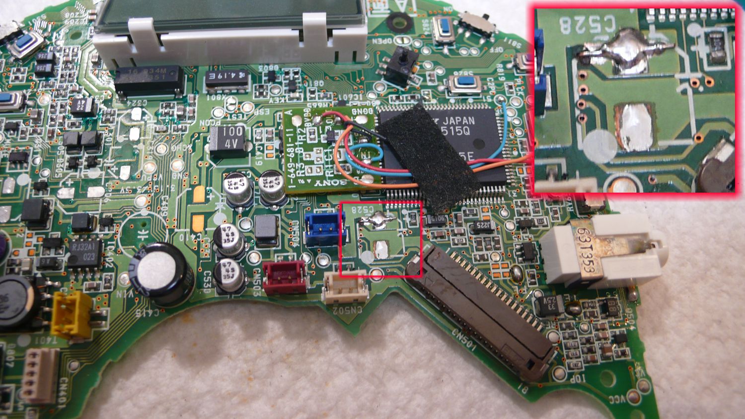

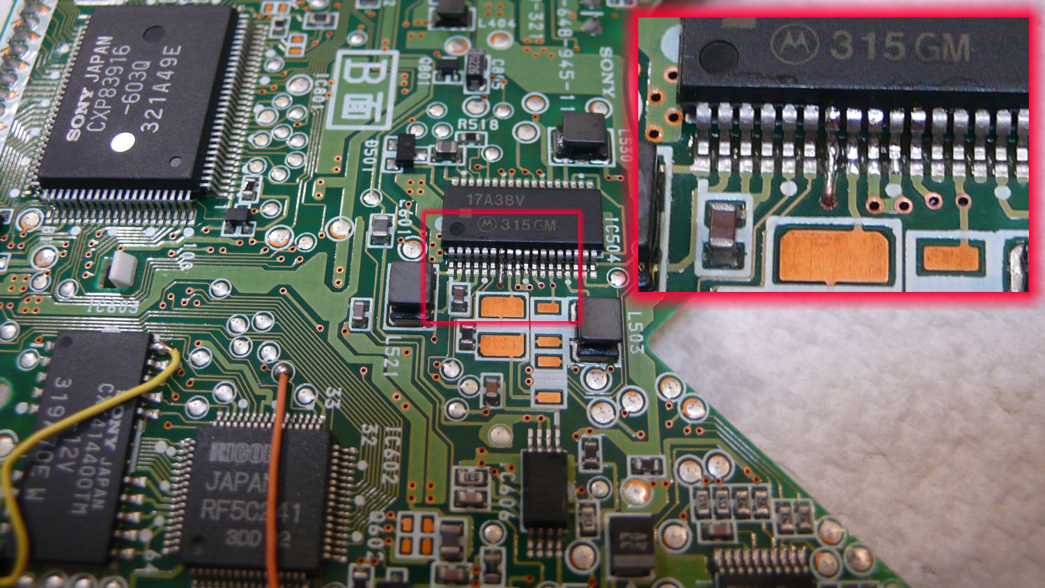

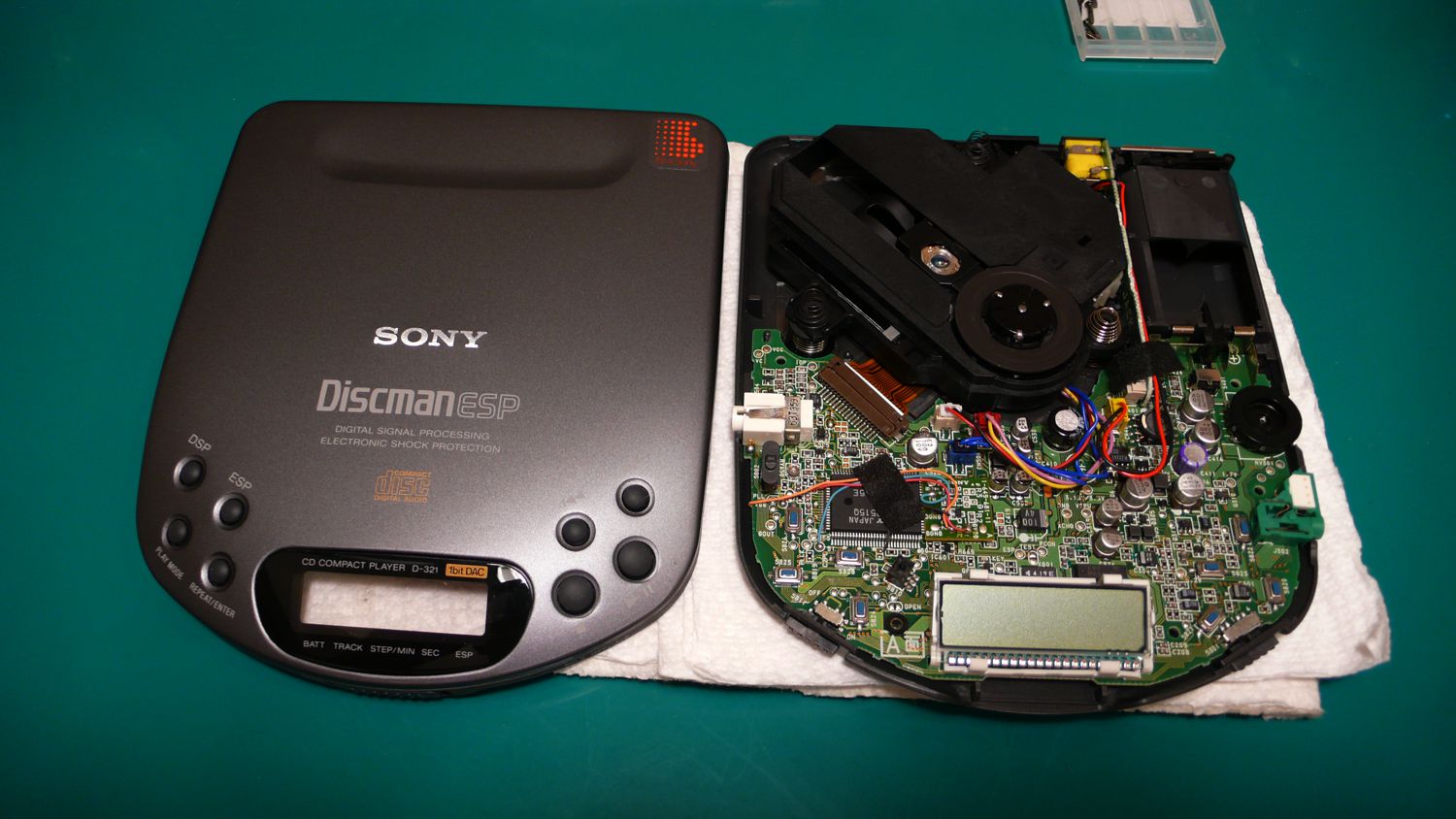

  4. Jorge
    1,786

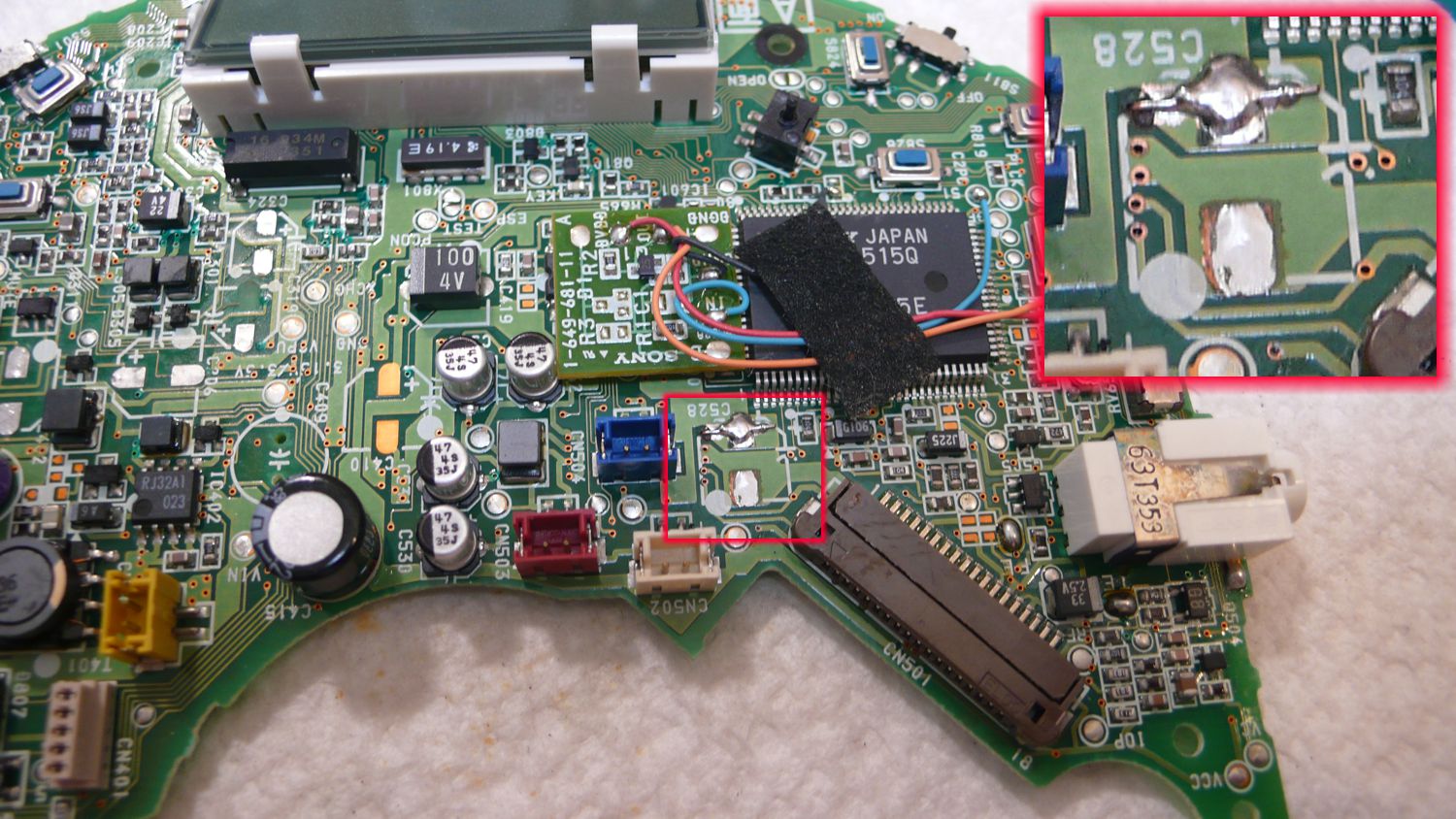

    I was going to bet that changing laser won't solve the problem, but I see that I am too late for that. My next bet - once Kaosun responds to you Q it will be similar to what he said about D-66 Discman here:
    Recapp all SMT caps and further clean the leaking polluted areas. Every D66/Dt66 can be handled. Even if you do plenty circuit analysis, you'll find it's still problems related with caps and leaking. Be very careful of each operation.

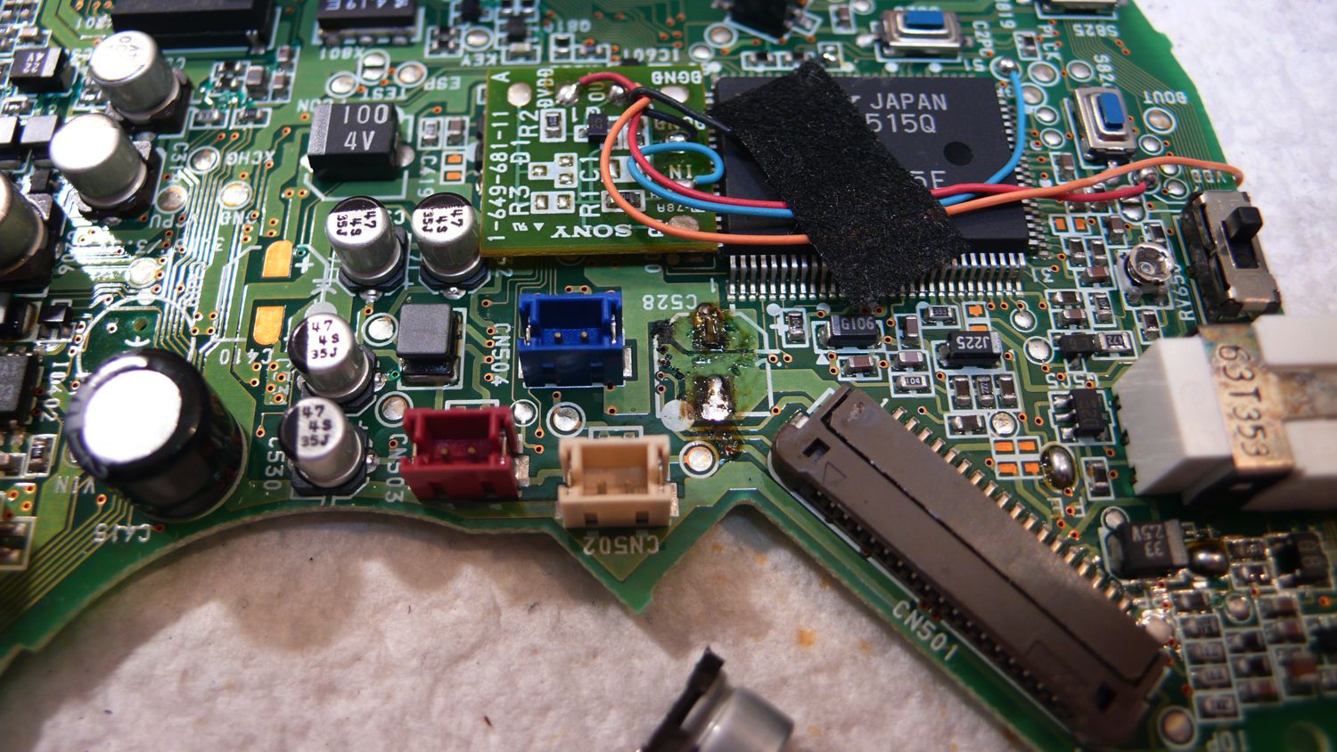

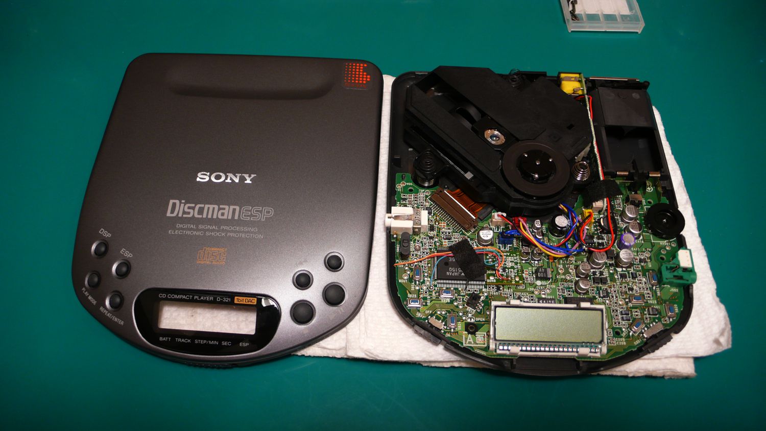

    D-321 is beautiful, one of the last Sonys worth having. Velvety all-metal lid, an option to turn off that awful Electronic Shock Protection, nice grommets for the laser. But it is not the famous D-311, so reviving these makes sense only for your own collection. Here is my D-321 as received, cold-dead:

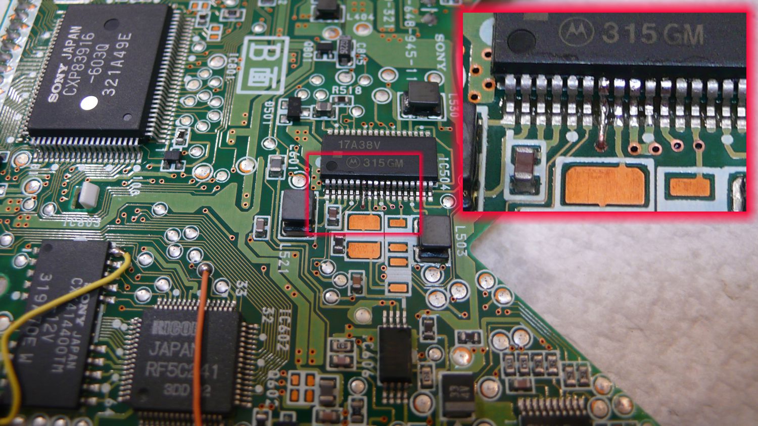

    Except for the four 47uF, all SMD caps leaked pretty badly. One example - land and via under C528 got damaged, connection to the driver MPC17A38V was restored by copper wire:

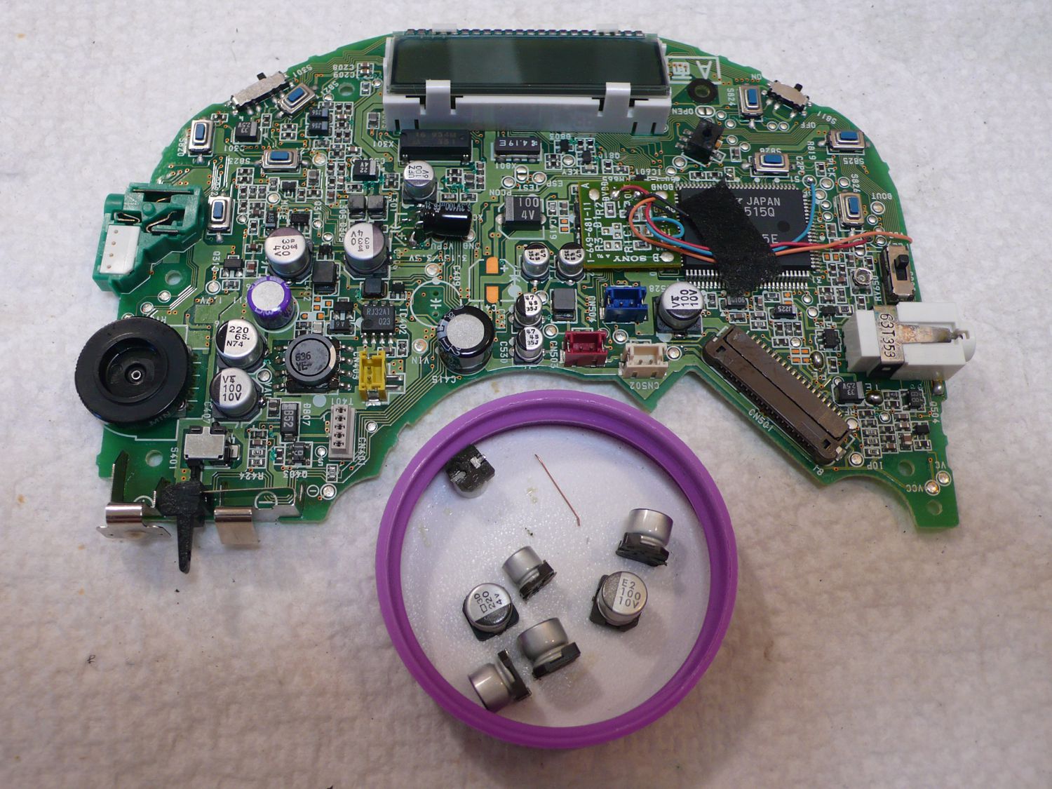

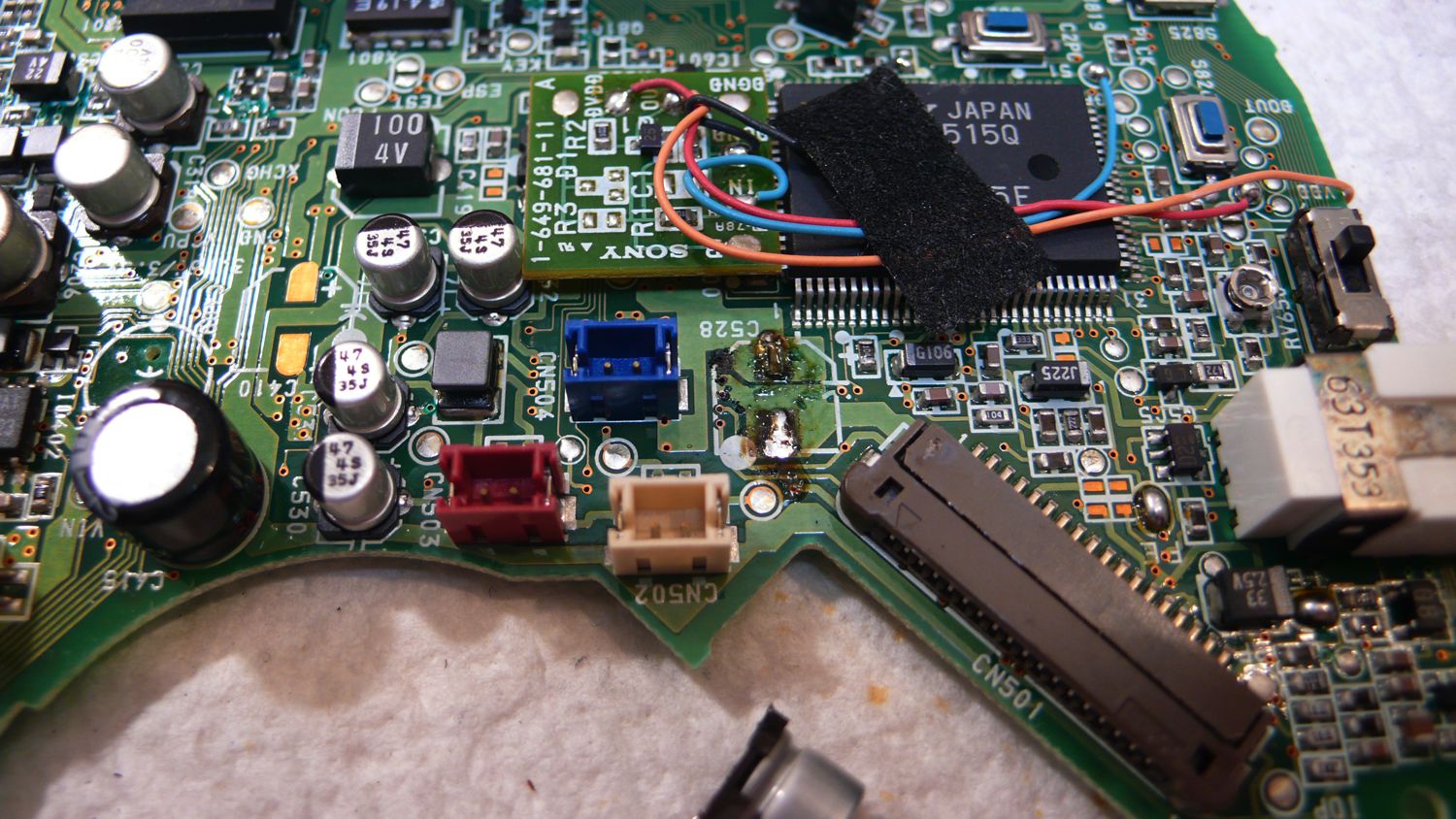

    recapped:
    yours will be different, all I can add is that hunting for those damaged traces and vias is quite difficult. I use Leica dissecting scope for the job and still usually miss a few spots on the first try
    Hyperscope and Eryan like this.

    Thanks a million times for the detailed pictures. I kept running some test with my player and found out, that the focus coil does indeed work, but only if the player is sideways or upside down. In that case, the any CD on the player is read and played without issues. But as long as the player is upright, it is unable to read the CD.
    I realized that the focus coils can move the lens only downwards, but not upwards. I tested the laser on another player, and the coils worked OK. So that discards a damaged focus coil on the player, leaving only the traces or the driver itself. I could not find anything wrong with the traces, but all I could do was test for continuity with my multimeter. The C528 was leaking a little, but I could not see any considerable damage to the traces. I have replaced all caps, except the 47 uF (I am not skilled at soldering SMD caps, and those are tiny).
    Since I could see no damage on the traces, I started suspecting that the driver itself could be damaged, which would be a bummer since it is almost impossible to find a replacement (the driver on this unit is apparently very unusual).
    Your repair gave me new hope. I'll check the traces again and, just in case, will use thin enamel wire to connect the focus coil pins in the driver directly to the corresponding pins in flat wire connector.
  6. Eryan
    Eryan Member
    33
    Bavaria, Germany
    Jorge, I prayed to the pagan gods of electronics for help, and they sent you with high resolution pictures. The same trace you repaired in your unit was also damaged in my player and I completely oversaw it. The repair was completely nerve racking. The hole you used to pass a wire from side to side is completely blocked on my playery so I had to use thin enamel wire to connect the pin on the driver directly to the capacitor pad on the other side of the PCB. Soldering the wire to the driver took a lot of time, several attempts and a healthy dose of swearing (I have no microscope unfortunately, and I was really worried of damaging the driver with my less-than-stellar soldering skills). But somehow I did it, and now the focus works as expected. As a matter of fact, I am listening to the player while writing this reply.
