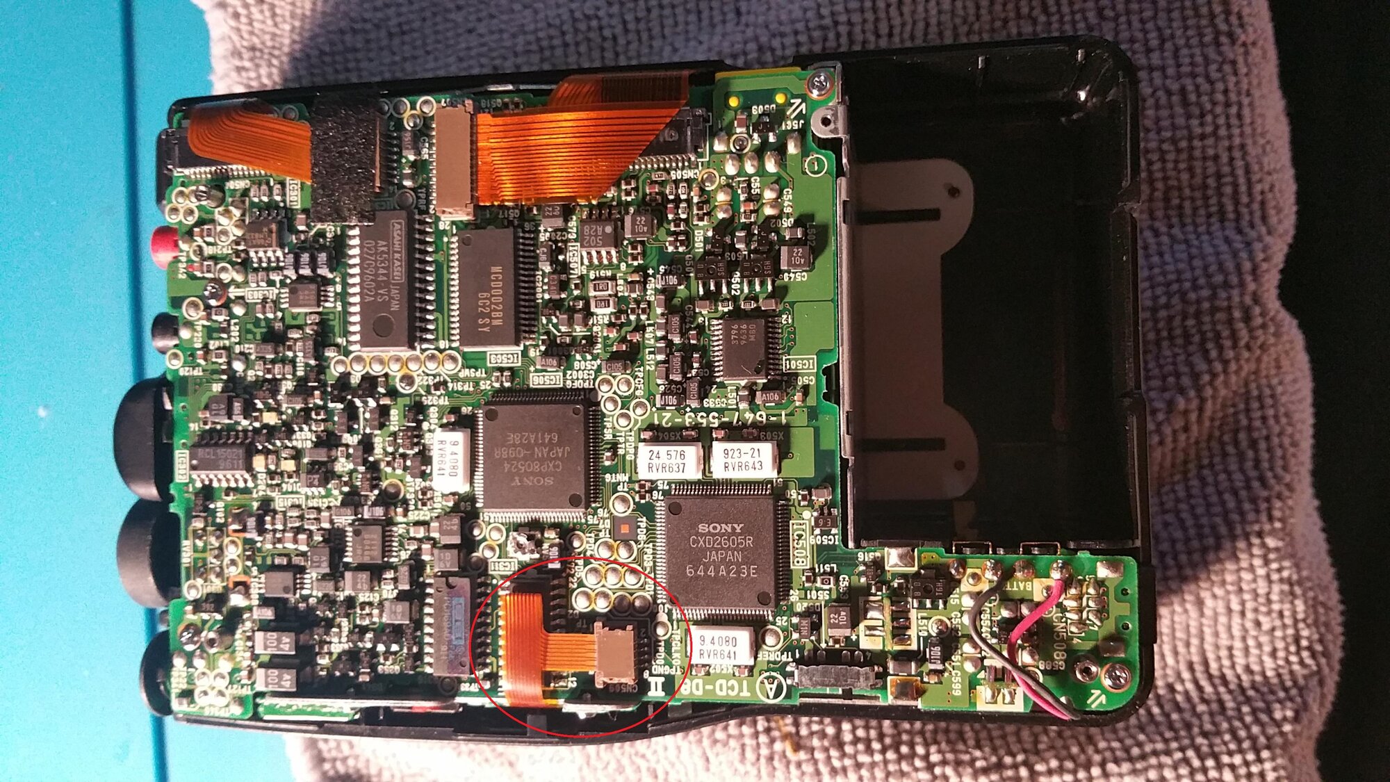

    Hi,
    My TCD D8 lowers its volume randomly without me pressing the button. It does it mainly in normal mode BUT it also does it in Hold mode, which I don’t understand . Anyone ever had this issue ? Anyone knows how I could fix that ? Maybe the little button on the board has some problem that I could easily fix ?
    Thanks for your help !
  2. Valentin
    1,969
    I recommend doing a simple test: remove the flex cable going to the buttons PCB (see picture attached) and see if the problem persists.
    Also you didn't mention one thing: do you have AVLS on ? That will lower the volume automatically if it's turned on.
    On the TCD-D8, this switch has 3 positions: ON, OFF, LINE OUT. It needs to be set to OFF (middle position).

    Hey so I tried your trick and it works. When the button is unplugged, no more weird random volume changes. So, any idea now what could cause that ? Just the button possibly that has a short circuit ? I’m not an expert lol so I’m just saying words I don’t even know about. If you have an idea how to fix this issue for good while letting me the ability to change volume (so not disconnecting the buttons) I’d be happy to know !
    (Also, I tried to air clean the contacts before plugging the cable again, with a little air blower. Problem remained after that still.)

  6. Valentin
    1,969
    Ok then it means you probably have an issue with one of the buttons if it works fine with that board unplugged.
    Only thing I can recommend is spray some contact cleaner in the buttons and then press them a couple of dozen times.
    But be careful to spray just a very small quantity, otherwise you'll get a mess of contact cleaner everywhere, including in the mechanism.
    Unfortunately to remove that PCB you need to take the chassis out of the plastic case.
    It's not that difficult, you need to remove the door and the REC level knob. It's up to you how to proceed further.
