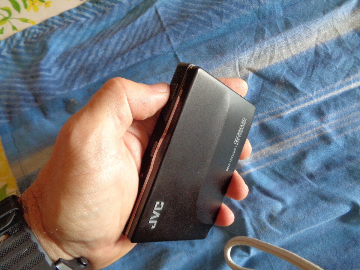

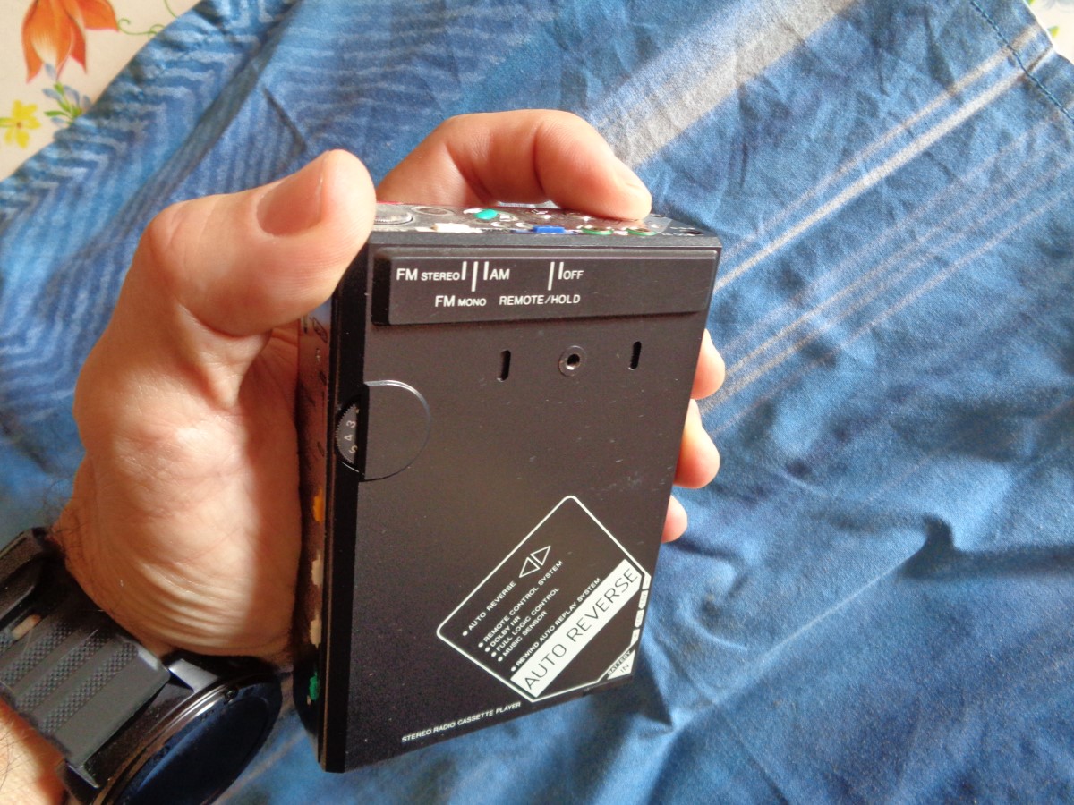

  6. Silver965
    Silver965 Well-Known Member
    736
    Torino

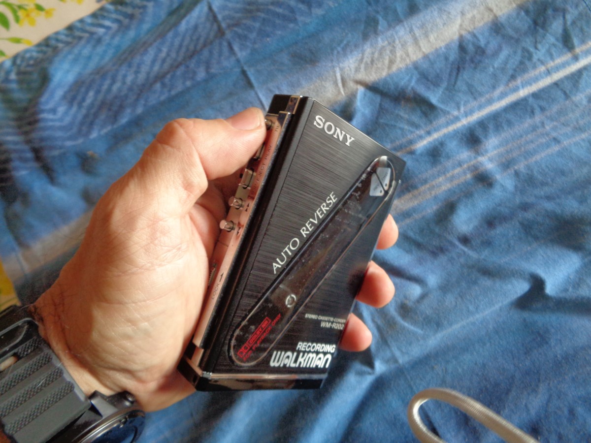

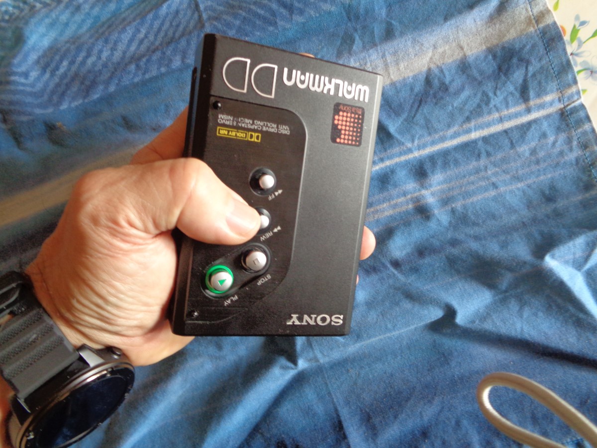

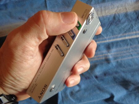

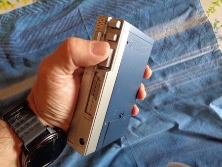

    Ok then instead of starting from the measures why not starting from the handling or the ergonomics ... in general a Walkman is used with one hand ... I use the left one .... and with one finger ... I move the function keys ... Play etc. etc ... Here are some examples

  7. Valentin
    2,035
    Very good point @Silver965 !
    In my view, the best ones in terms of ergonomy are going to be the slim ones. Would also consider how well one fits into a pocket if it is to be used outside.
    Of course, for some this may not be an important factor or a problem at all, but it should be considered nonetheless.
    One other aspect is mechanical control or full logic. From ergonomic perspective, full logic is to be preffered.
    From the ones in your pictures, I choose the JVC. The DD11 and TPS-L2 will not fit in a normal pocket, but the button layout is good.

    I think the DD1 (mine) was meant for the right hand the buttons are pushed with the thumb and are well spaced ... the tps l2 is for the right hand but if you have a small hand it is difficult to hold and press the buttons. ... also the wm 20 is for the right hand and with the same finger you can also control the volume Like the Wm 2 but to the nearest keys ... The jvc is made for the left hand and with only one key for all functions except the volume controls it with the index finger ... Also the wm r202 and for the left hand like the wm 702 ..... Aiwa J09 - T09 you control the volume even with the thumb only ..p09 you control with the thumb the keys and with the index the volume Etc..etc .. Remote controls were a nice invention but not all of them were provided

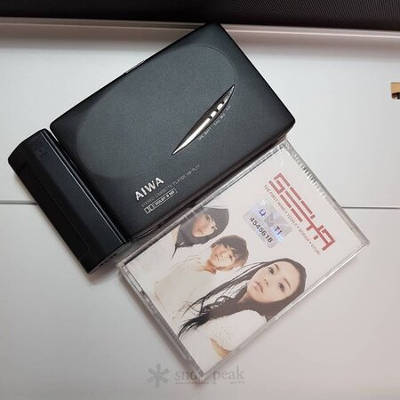

  11. TooCooL4
    3,664
    With regards to physical size, the smallest I ever owned was an Aiwa HS-PL77. With the battery pack removed and only using the internal battery it stood at the same size as a cassette case, in fact it may even be a little shorter. It also had remote. unfortunately it got stolen back in the 90’s.
    Being so slim, the W&F was terrible if you jugged it about too much while walking around. The unit did not sound to bad to me in the 90’s, but I wonder if I would think the sound quality is still good these days now that I am used to better.
    I bought an Aiwa HS-PL707 a while back as it looks like the HS-PL77 but with better BBE, the W&F is still terrible on the move so it never get's used.
    Attached is a picture of the Aiwa HS-PL77 I found on the internet.

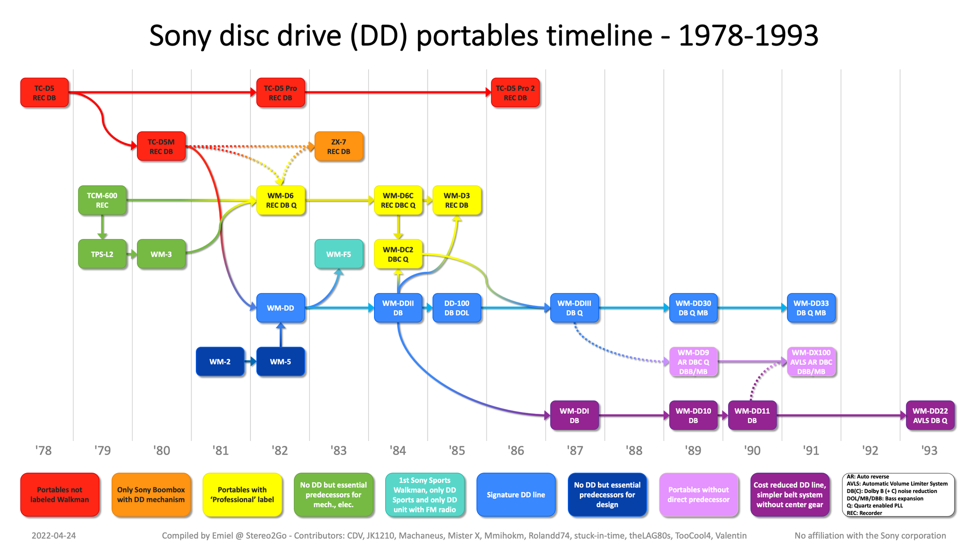

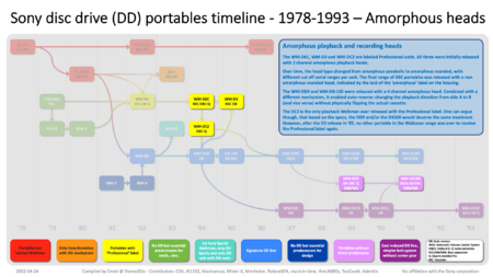

  15. Emiel
    1,115
    I started to add more details to the Timeline.
    The goal is to have it somehow animated or clickable.
    Let me what you think!
    C83, Silver965 and Valentin like this.
  16. Valentin
    2,035
    Both animated and clickable sound like good ideas to me. What I imagine it like is the following:
    - animation showing them faded them making them clear one by one in a chronologial order (so at the end they're all clear);
    - if you click/hover the cursor over to offer some additional information in a small text box;
    It's up to you how to do it in the end, these are just ideas/suggestions.

  18. Emiel
    1,115
    August '22 update to first post: new table and timeline.
    Corrected a few items, like the servo IC of the DD22.
    The DX100 and DD22 are now more clearly linked, through both the PLL and Servo IC.
    More important: added text to clarify the relation between units to the graphical timeline.
    There are still a few unknowns (?), please provided feedback to complete the overview!
    Valentin likes this.
  19. stuck-in-time
    394
    Jakarta, Indonesia
    I think for completeness' sake the other model variants can be added? The WM-D6C and WM-D3 appear in some markets as TC-D6C and TC-D3 (I think the equivalent TC-D6 doesn't exist).
    And regarding the predecessors:
    • TCM-600 can be expanded to include TCM-600B (black version) and maybe TCM-100 & TCM-100B (not sure if there's any difference between the 600 and 100)
    • Add the BM-12 between the TCM-100 & TPS-L2
    Emiel and Valentin like this.
  20. Emiel
    1,115
    Thanks for the response!
    Update Aug. 16 - I added the alternative model names to the overview table, see first post.
    In the table I captured all different colours per model, black and silver for the TCM-600.
    The BM-12 I need to read more about, on my to-do. There are some threads here about the TCM-600 and BM-12, mono to stereo and differences I need to digest.
    @Machaneus : your feedback about this would be greatly appreciated.
    stuck-in-time likes this.
