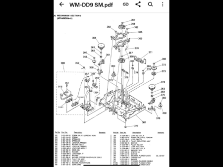

    Hi everyone, I think this forum may be my last hope to try and get my much loved Sony DD9 working again. So far over the past 2 years its spent over 18months at 2 so called specialist in London that were unable to fix it.

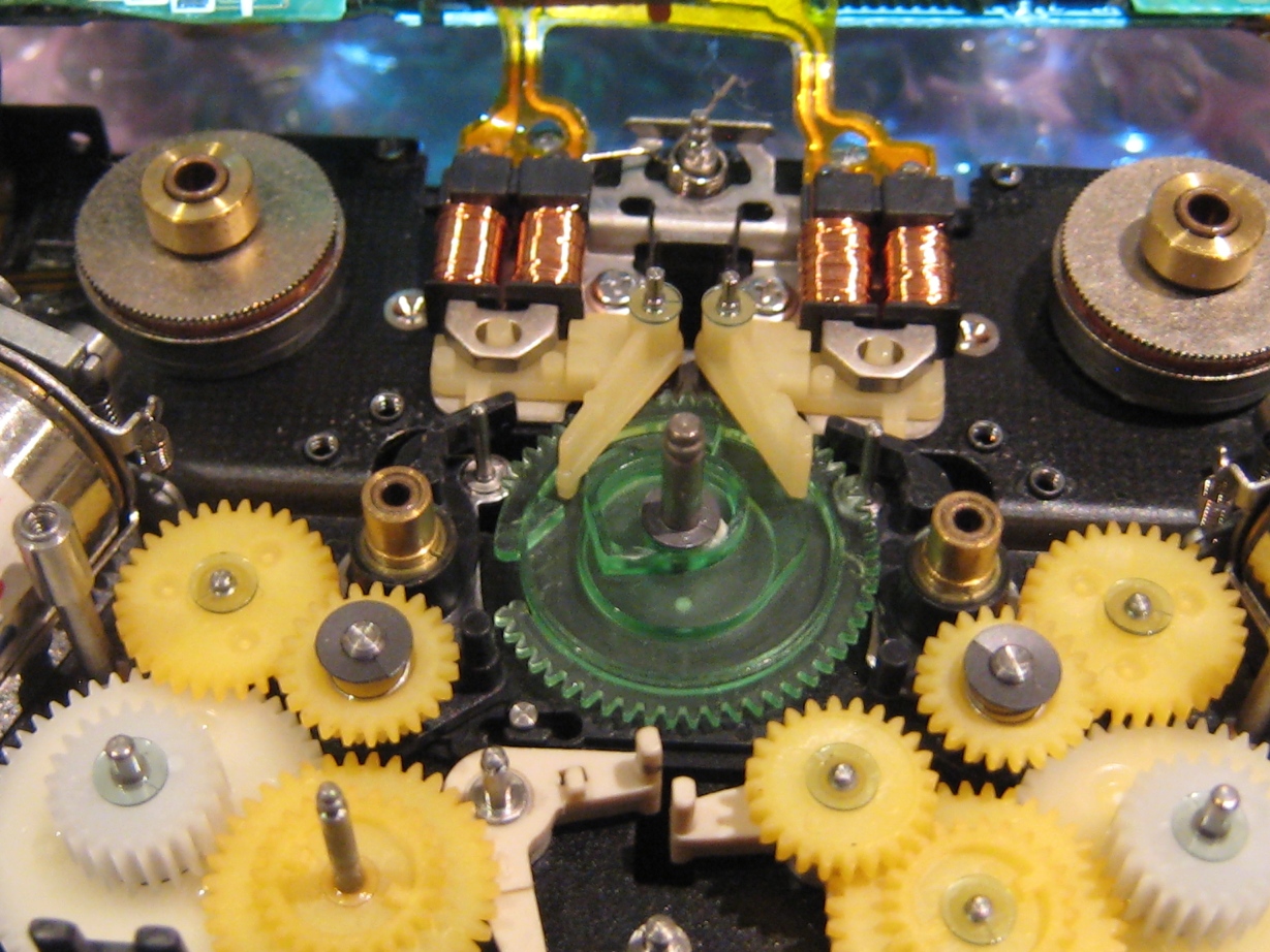

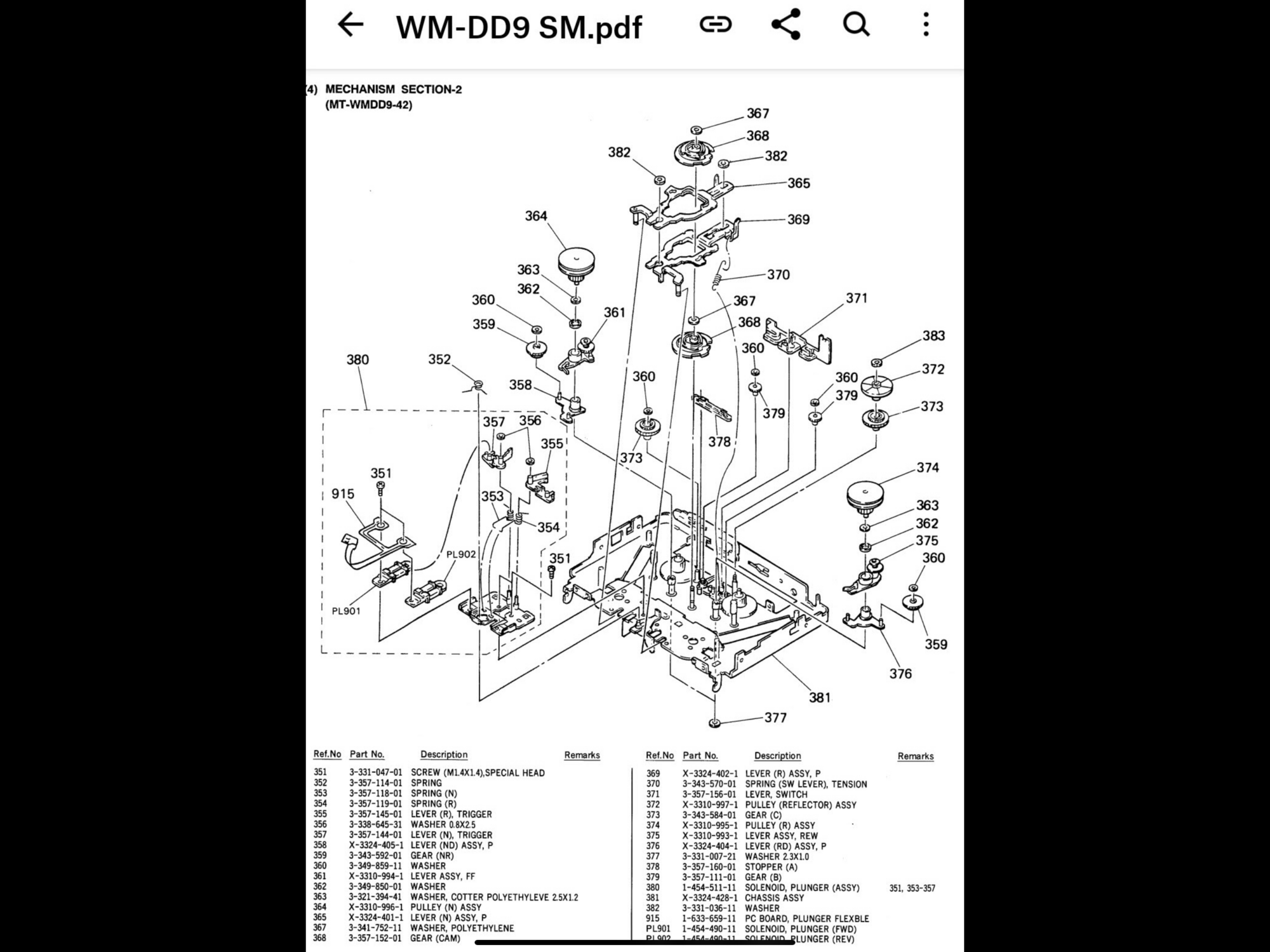

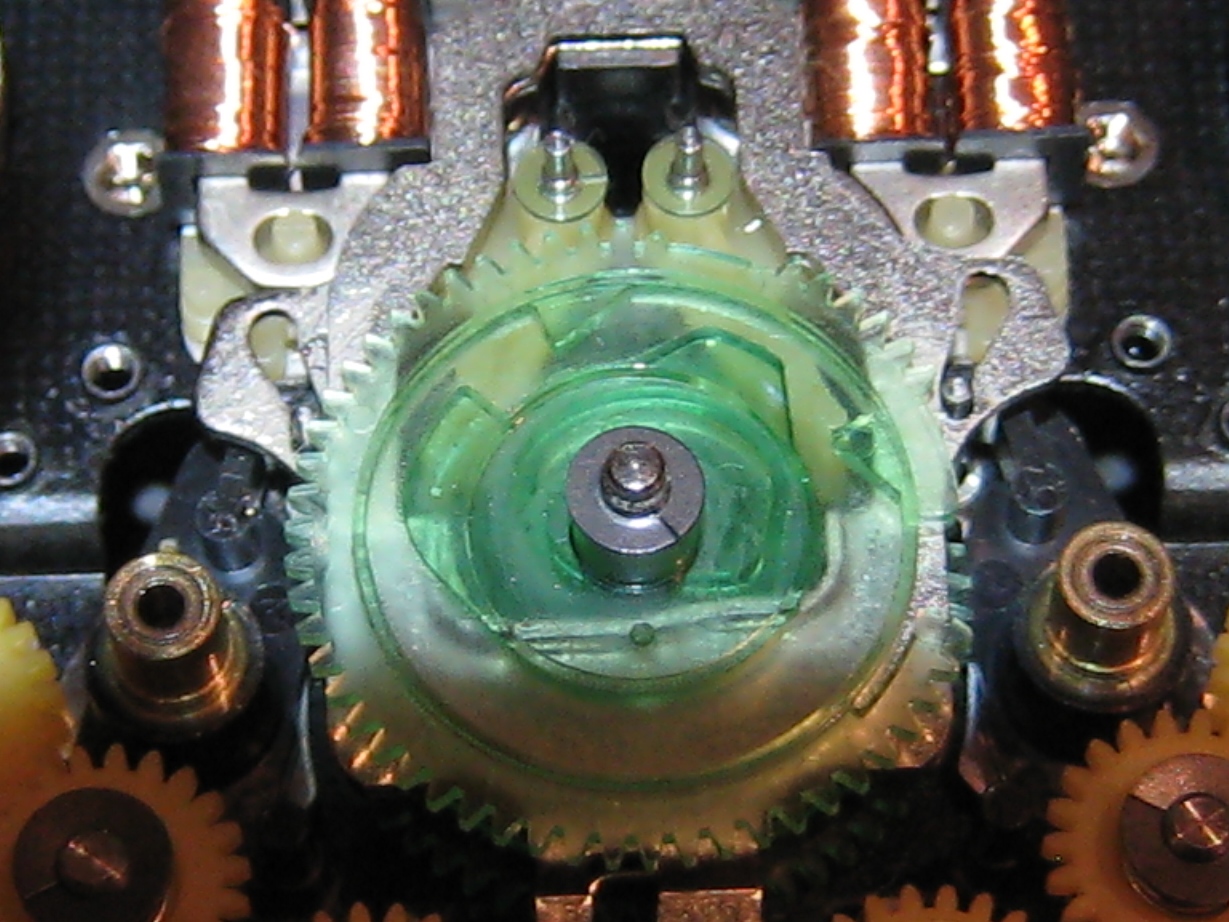

    The last specialist thinks he found the problem, a cracked gear (part 368) on attached diagram and thanks to help from Roland on the Facebook Walkman Group we think its the green transluscent gear in the middle of the attached picture.
    Can anyone please help…

    I suppose you are talking about that green cam gear that's broken. It's unfortunate, because the only place you are going to find that gear is from a donor unit.
    I can confirm that 3D printing is not an option, it just does not have enough resolution to print such fine details and the final 3D printed product is fragile compared to the original.
    These types of gears can only be made using injection molding, but that's also not an option, unless you make at least 1000 pcs.
    Marian Mihokm did a center gear replacement for the DD series (DD9 is different from the series with a center gear, although still a DD). I read that thread and realised it's not simple to make such a gear.
    I suggest to post in the "Gear that you want" section of the forum and ask for a donor DD9. Maybe someone has one that has other problems and is willing to sell it for spares.
    By the way, where is that gear broken ? Are you talking about that slot in the bottom ? It may supposed to be that way.

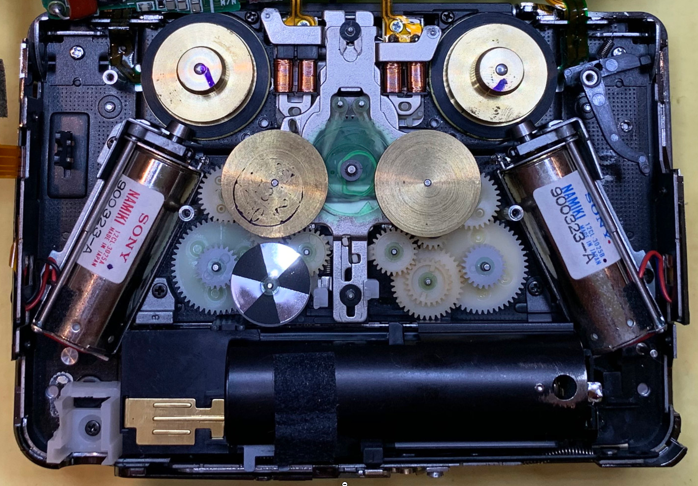

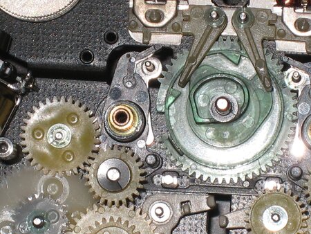

    Here are some photos which I took while repairing a DD9 a few weeks ago. There are two of the green gears, one on top as you disassemble the unit and one on the bottom. They appear to be the same part number and so, I assume they are identical. There is a slot and a short section with no teeth on the gear.
    Firstly, what is wrong with your machine? What are the symptoms?
    If you do have a broken gear, are they both broken or is one intact?
    If the problem is a broken gear, it looks as if your options are to repair it or, possibly, make a silicone mold using the good gear and cast a resin replacement. However, I'm not sure if a resin replacement would be accurate enough and it could be too brittle.
    I agree with Valentin that 3D printing is not an option at the moment. However it is a technology which is still in its infancy and developing fast. Maybe in a few years time a 3D printed replacement will be feasible.

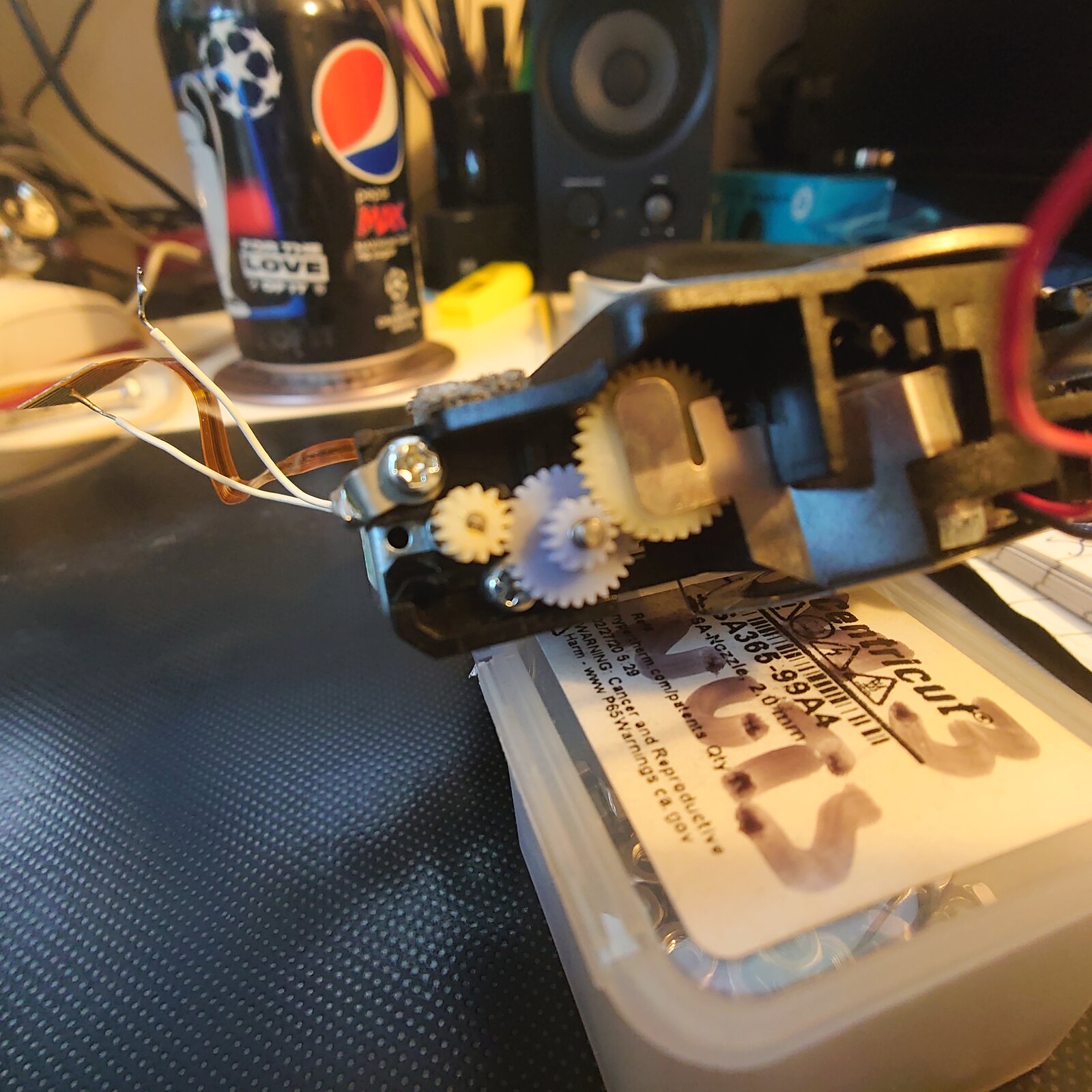

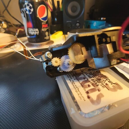

    I have access to a resin 3d printer, that I made a gear for my Philips AZ6897 portable CD player.
    That fixed the fault of the original gear that had fallen to bits. The grey middle one is the one I drew and printed.
    I`m offering, if you can send the gear (or the player) to me, I`ll see if I can get one printed.
