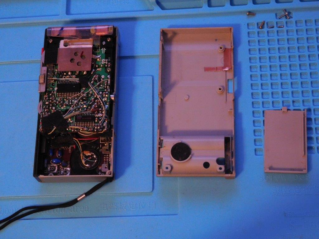

    I thought I'd fix the "cassette does not work" issue by replacing the belt and that went fairly easily although I don't know the belt size for this model and my box of belts is limited in the 2"-4" range. I think it takes a 3.5" belt but if anyone knows let me know.
    Changing the belt did the trick and I zippered it back up but then I noticed it was missing a reel sprocket, bummer but it gave me a chance to order another recorder for a few bucks to try to use it's sprocket. Other than that the motor turns and the radio works pretty good, I can tell from the switch it will need some Faderlube to cure some issues but otherwise a nice 80's cassette oddity.
