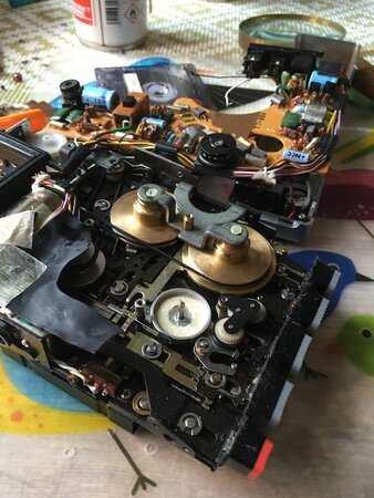

    Dear forum!
    I'm restoring av SONY TC-55, an early mono tape recorder. It's exceptionally well built, all metal, shiny brass and cast aluminum. Almost no plastic at all. It also hows several interesting similarities to the 10 year later TPS L2.
    So far I've put in new belts, everything is cleaned, polished and carefully lubricated. Fast forward and rewind works perfectly. Play works also, but the speed goes up and down a bit. All switches have been cleaned and there are no contact malfunctions.
    It does have a speed potentiometer (and presumably some regulation/governing) but I've yet to see a schematic. I've changed the old trim potentiometer to a new one but the problem persists. The motor feels strong and runs evenly (but I haven't been able to check RPM directly on the motor).
    Still, after 4-5 hours, I'm running out of ideas. Has anyone fixed this one? Or got a schematic? @Deb64 ?

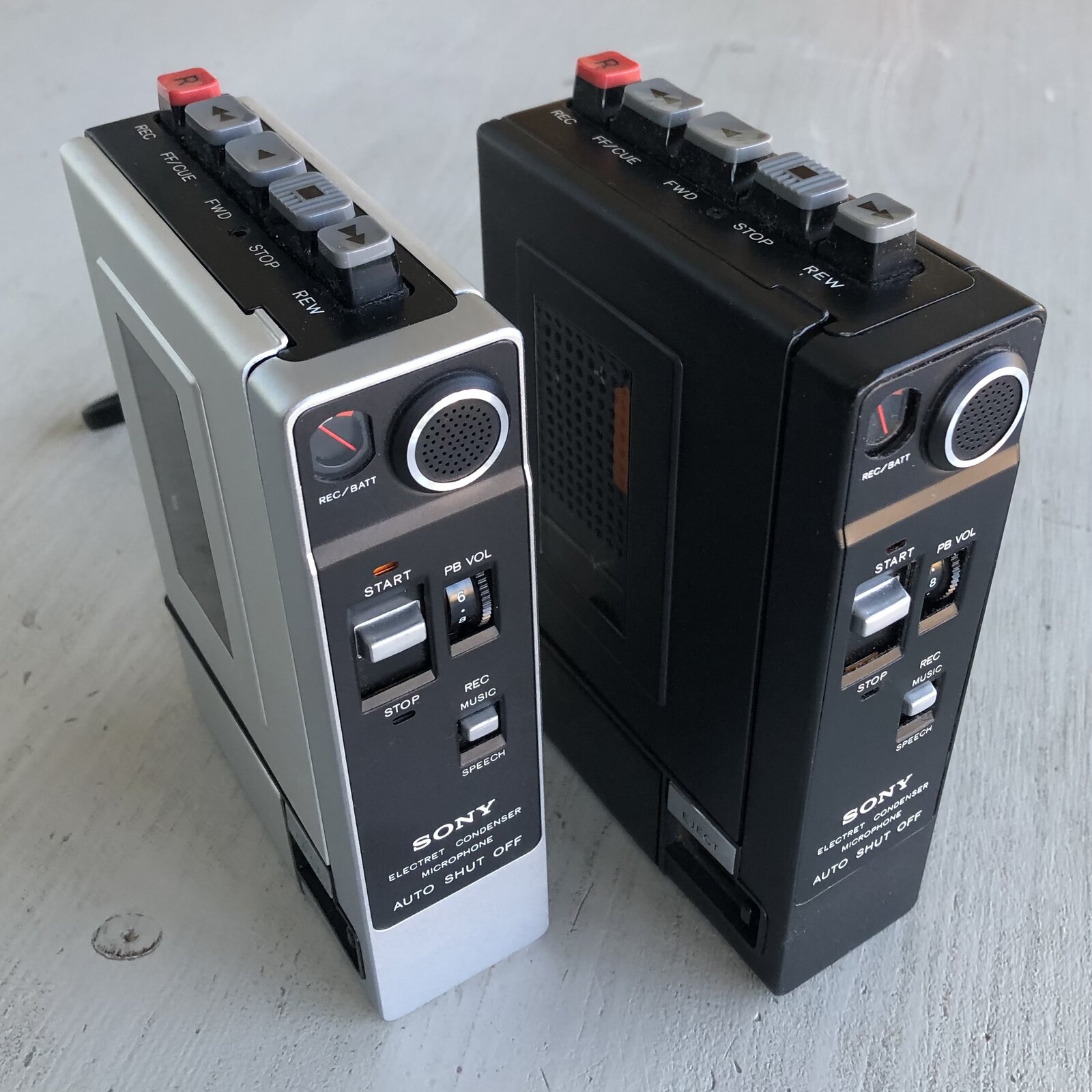

    Great little machines, aren’t they? Built like a tank and weigh about as much. Picked these two beauties up on eBay some 15 years ago when they were still going for no more than five Euro’s a piece (those were the days).
    As far as the wobble goes: not a tech myself, but Deb64’s advice about the pinch roller makes sense. Here’s my own layman’s two cents worth: Are you sure it isn’t the cassette?

    Thank you all [ @Valentin @Arky Malarkey @Deb64 ] !
    I performed a 2nd, and then a 3d cleaning+ lubrication and gradually things improved.
    Notes: Taking everything apart and polishing (even shining metal, and even on the inside of bushings) helped more than I would've thought initially.
