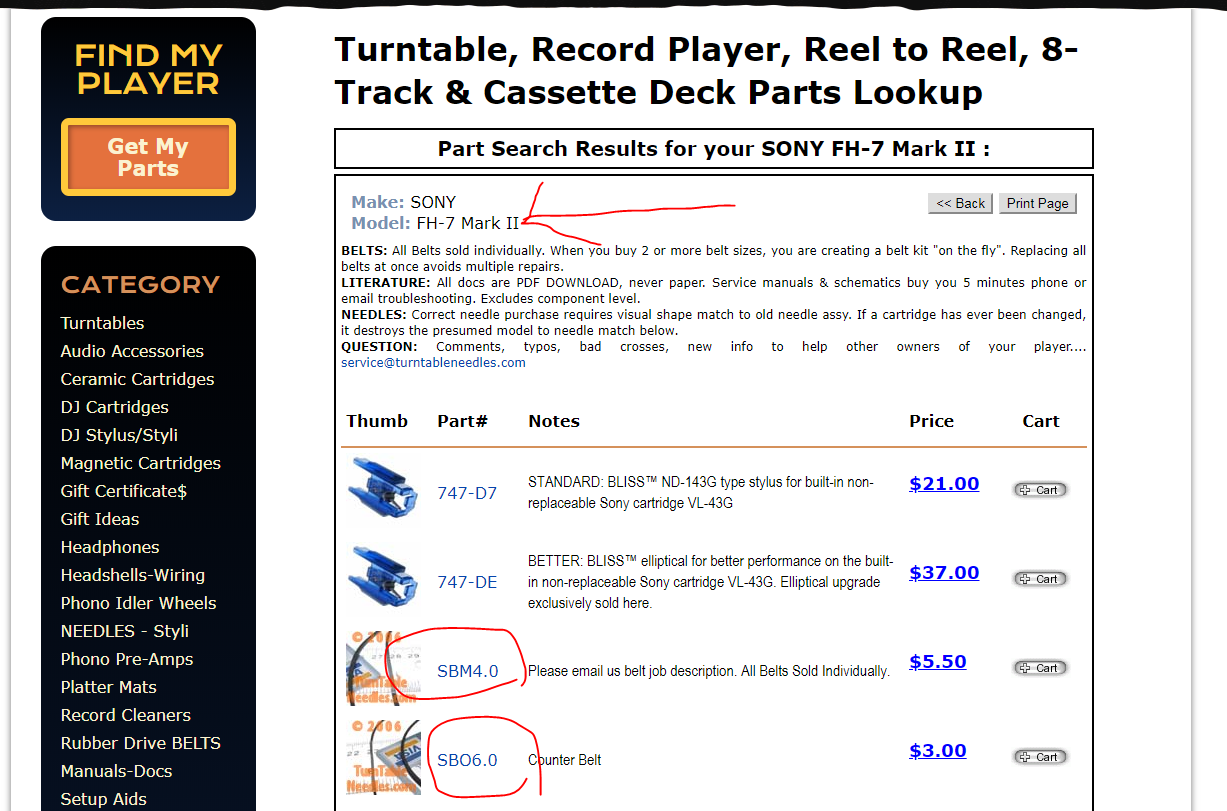

    19,115
    These guys have been kicking around the internet since the beginning, I haven't a chance to use them yet but they really push their made in Japan Belt Sets.
    http://www.marrscommunications.com/
