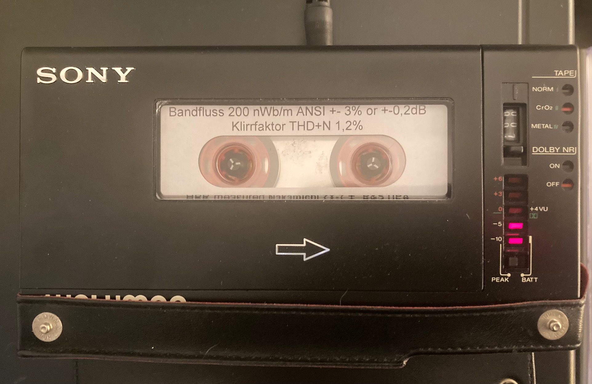

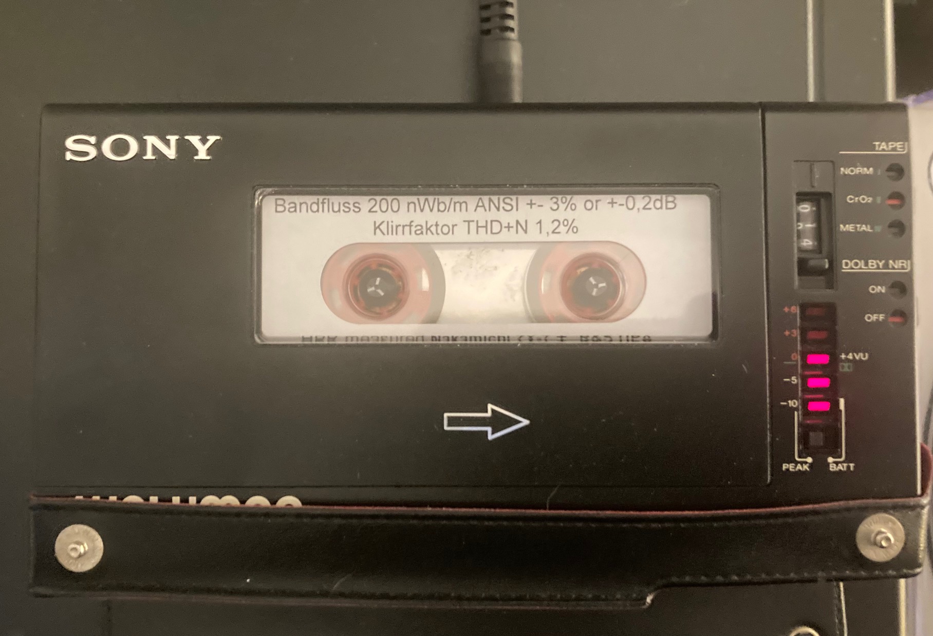

    Before doing that, though, I thought I would try the Dolby cassette in my D6—connected via the line out to my receiver tape-in. Guess what, the level meter drops a unit when the receiver is on, and jumps back up when receiver / tape loop is off, same as the KA1ESA...

    From calibrations done before on D6/D6Cs the difference between measuring directly (multimeter 10MΩ input) and with 47kΩ load is about 20-30mV RMS.
    Given the Dolby level is in between -5dB and 0dB marking on this VU-meter, it can indeed drop from 3 LEDs lit to just 2 lit, especially if HK3490 has only 10kΩ impedance on line in.

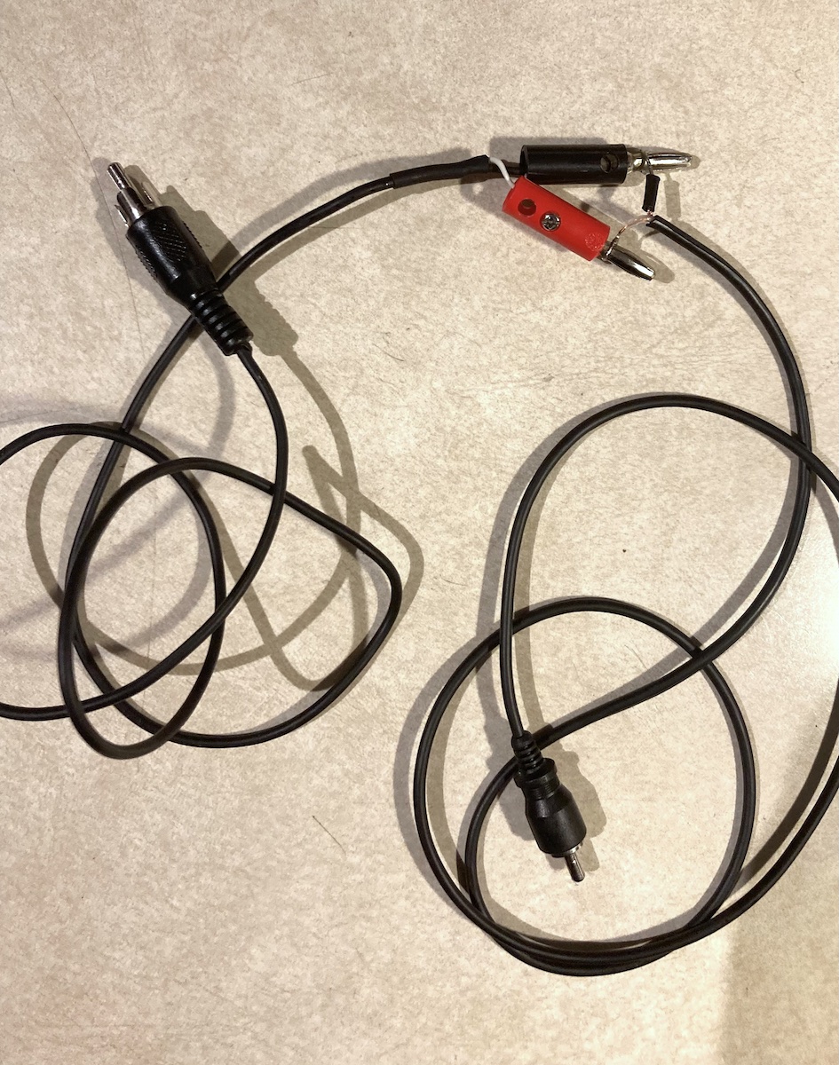

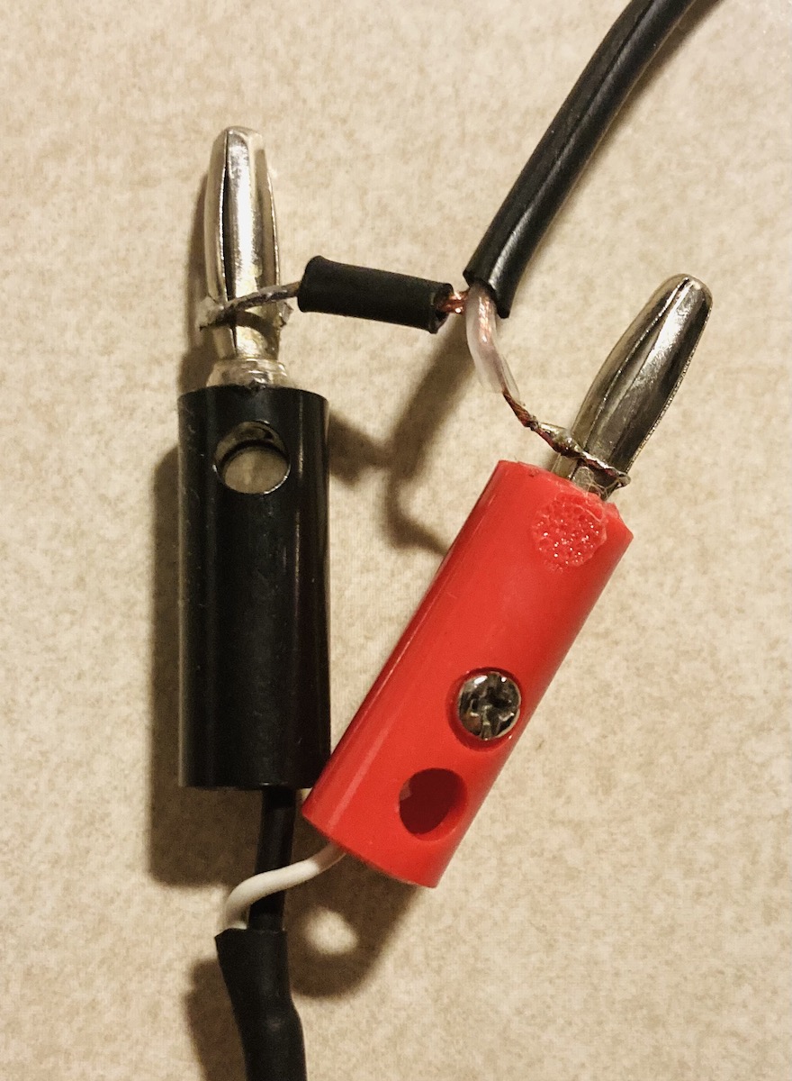

    Following up on the levels measurement on my KA1ESA. After giving all the inputs and switches a clean on my receiver, I made a testing cable to measure voltage drop on line out from the deck when connected to receiver tape loop (see pics).
    First of all, checked the playback levels on the deck again and confirmed:
    Levels on Dolby chip = 388mV
    Levels on line out (with 47k load, unconnected to receiver) = 432 mV
    Then, using the testing cable pictured, measured level at line out connected to receiver's tape loop (no load):
    With receiver off = 430 mV
    With receiver on = 390 mV
    So, a voltage drop of 40 mV
    VU meters still behaving same as in post #18 above...
