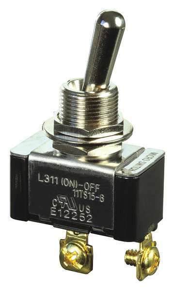

    I'm not an expert but before I watched the video I was thinking Moniter Switch and then I saw you had a toggle for that switch. For my used and abused equipment, toggle switches hold up the worse. I'm playing with a new to me boombox with several toggle switches on it and they all need a good cleaning to get it working right. On the 3 position switch I can kind of hold it between two detents and it will work ok but the 2 position switches are really tough. I think you can just squirt some contact cleaner in there and work it good but you may need to pull the switch apart, some of these are fully closed or open on the back.
    If the monitor switch is stuck in a "source" position, you should be able to hear your source playing through the player.
    Just be careful, that's a beautiful tape deck.

    The switch might not be open on the front, the lever may be on a ball that is closed similar to this one so no spray is getting in there. Some of the older style switches that slide more than pivot on a single axis are open but yours looks like it may be like this one.

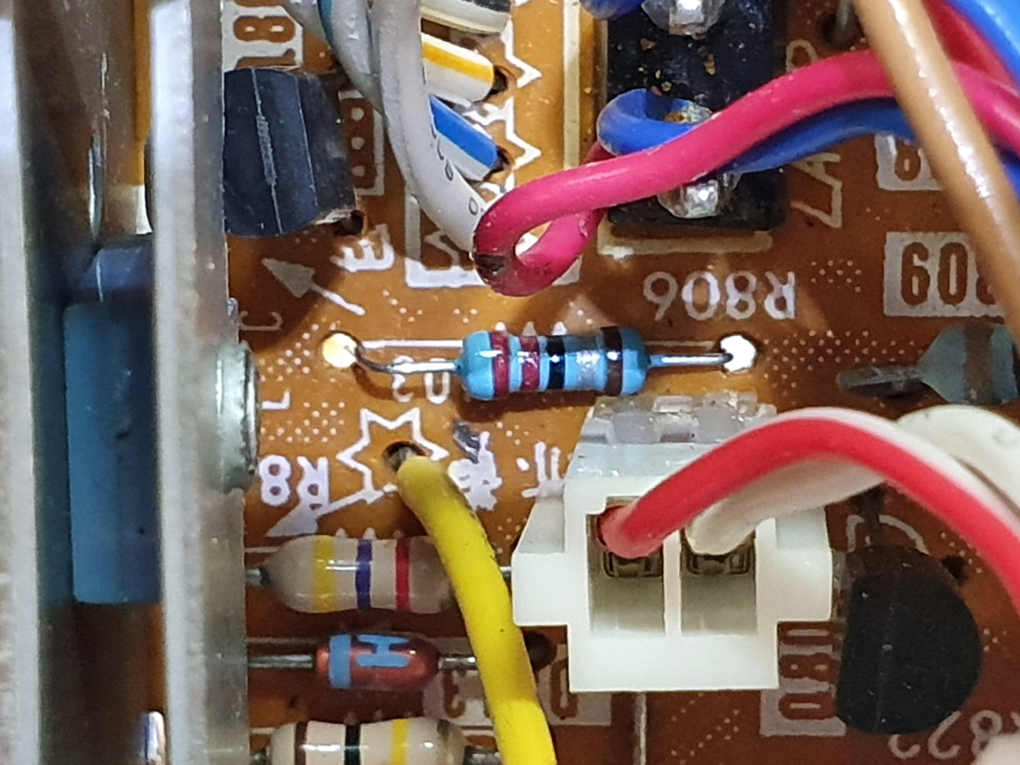

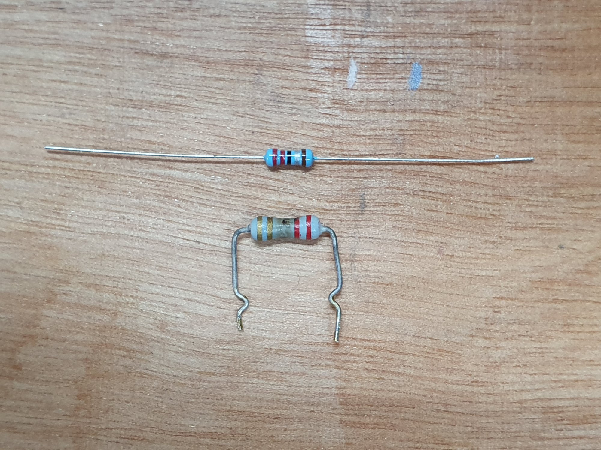

    Problem solved. Dead resistor on 14v rail. Deck is up and running again:nodding:
