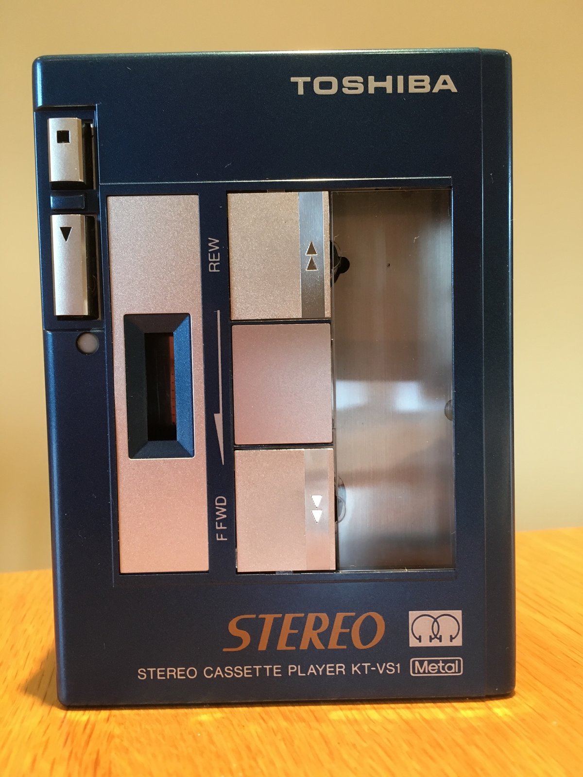

    I had one of these 2nd generation Sony Walkmans back in 1981, and was considering finding another. I’m just wondering how robust the mechanism is in this model and what tends to break, and what issues tend to crop up in the electronics..? My latest purchase is a Toshiba KT-vS1 (pictured), which looks great, but the ff/rw functionality being via pressing facial paddles which in turn physically press down the spindles to engage the gears is, in my view, a major design weakness.

    Toshiba KT-vS1 is a good looking design walkman. This design is common in many Toshiba walkman units including AS series, RS series.... All Toshiba walkman with this design suffer the same problems:
    1- the FFW and REW button are problematic most of the time. This related 2 different issues: crack in the gears and a crack in little black spool cap
    2- the tape and Dolby selection buttons on the better models (AS, RS series) usually break during the repair. You have to be very careful and expert not to break these buttons
