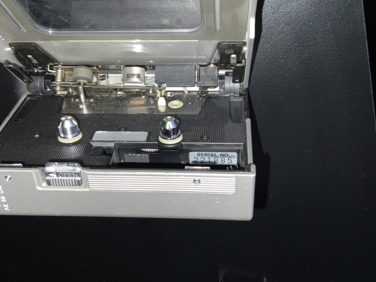

    Serial on my wm2 is 221885.
    works great with new belt.
    Valentin likes this.

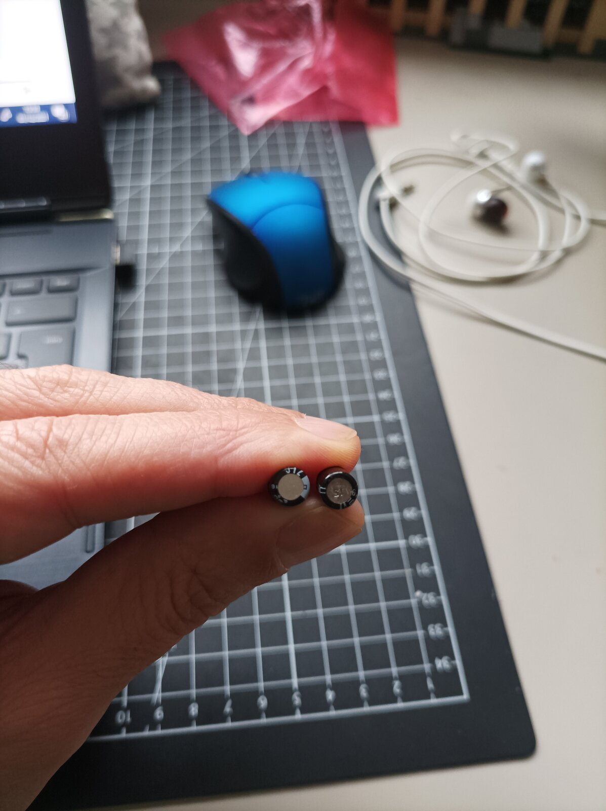

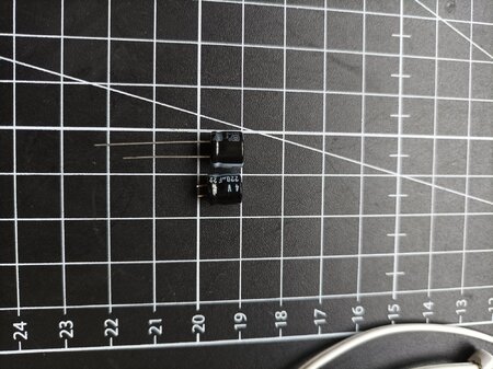

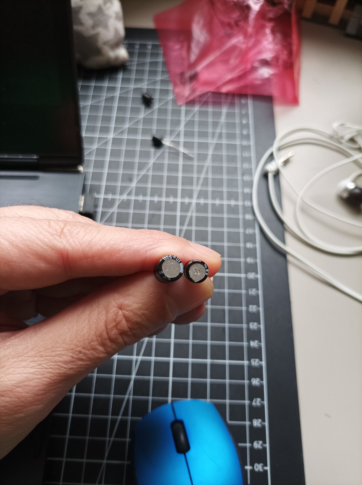

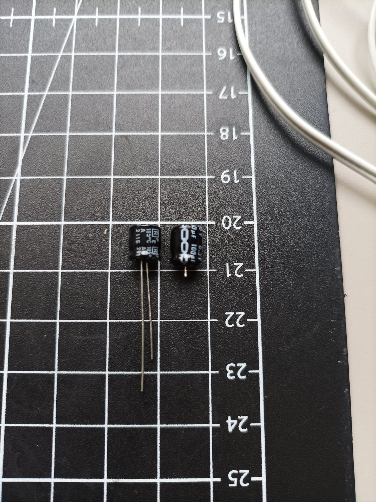

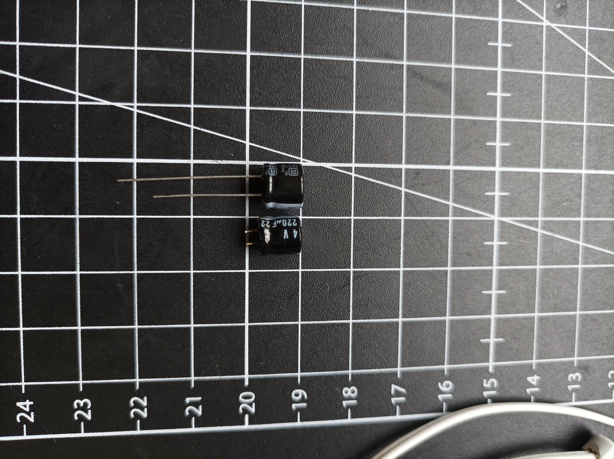

    IMG_20211201_154443.jpg IMG_20211201_155050.jpg IMG_20211201_154637.jpg IMG_20211201_154734.jpg Old a new caps
  9. JUAN ANDRES MONTIEL DIEZ
    JUAN ANDRES MONTIEL DIEZ Active Member
    199
    Spain
    Old and new caps. 220 uf newer little bit shorter but significantly thickers, 100uf little bit shorter and similar thicknes. New are Rubycon, no mark printed on the older ones, I thought was Rubycon but not see any evidence of that
  10. Valentin
    1,956
    @JUAN ANDRES MONTIEL DIEZ Old caps are Nippon Chemicon by the looks of it. Check the picture attached with their logo. On the actual caps, since they're very small you will find just the logo without the writing inside.

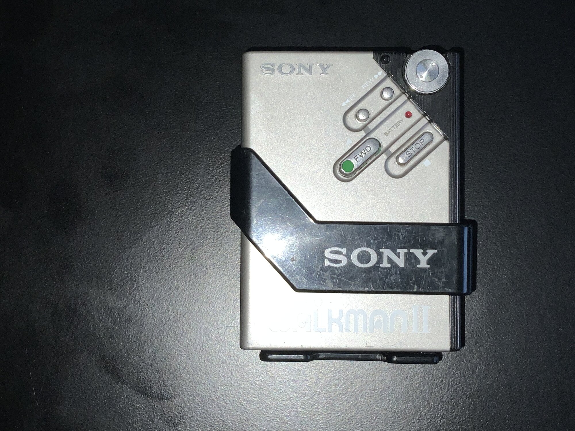

    I have worked on a few of the WM-2s. My observation has been that the 1981 models have the Walkman logo on the front (not Walkman II), the "play" button is labeled "FWD", the plastic base beneath the capstans are black (instead of the off white), and the mother board wiring is different. The WM-2s with the differences mentioned are the 1982 models. Anyone else see this in their travels?
