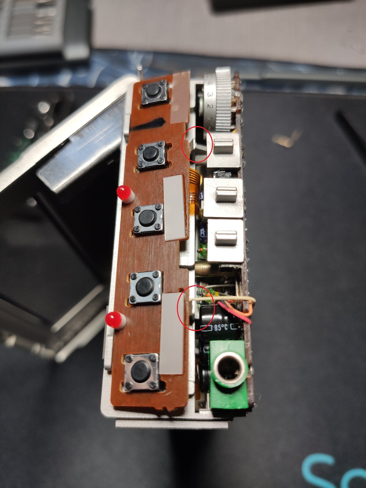

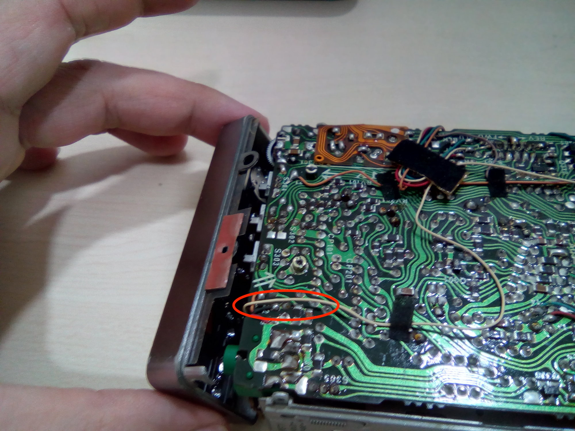

    I just found this forum while searching for information about replacing the drive belt in my WM-7.
    In removing the circuit board, I inadvertently pulled off one of the wires that I think connects to the control panel. It's the gray wire that I've highlighted in the attached image (borrowed from an earlier post in this thread). Does anyone know where it should connect?
    Thank you!

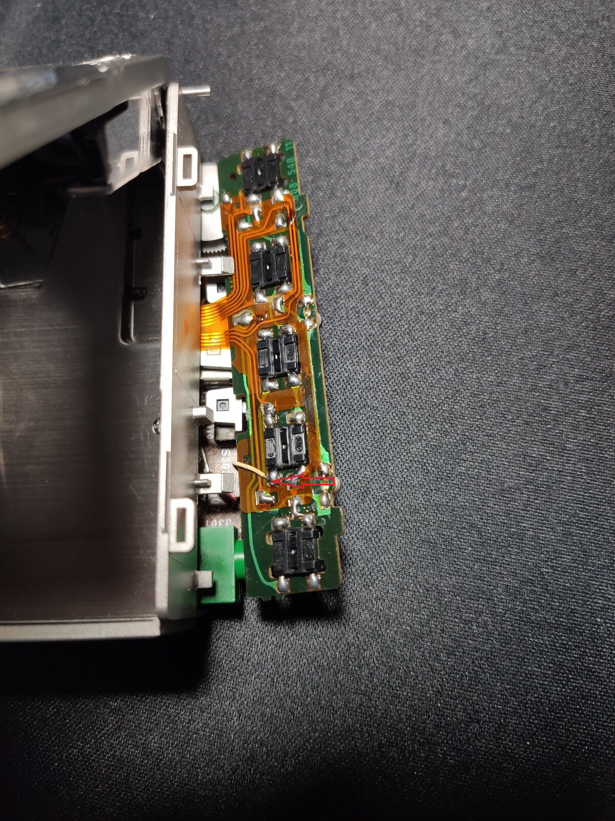

    If you are talking about the white wire, note that the tape holding it onto the board needs to be removed when flipping the board.
    It connects to the buttons PCB, I took a picture for reference. When taking out that small PCB pay attention to the marked hooks that need to be pressed.
    Also note there is a ribbon cable connecting to the board from underneath, care must be taken not to damage it.
    Boodokhan and nigels like this.

    Thank you, @Valentin. That's very much appreciated. Yes, that's exactly the wire I was referring to. I'd examined the underside of the control panel, but couldn't see where the wire had been soldered. Unfortunately, I discovered the tape removal tip after I'd broken the wire.
