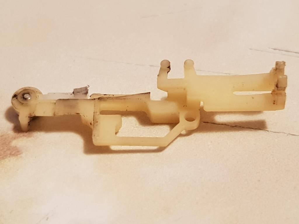

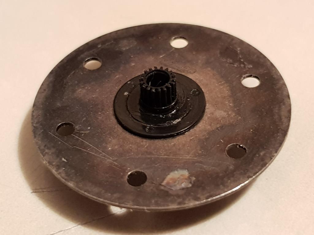

    Well it all went well enough. i followed the guide to the letter but it looks like the little white lever that lifts the heads had already broke as there was a little piece of it floating around inside, that didnt seem to make too much difference but the tiny gear on the reverse side of the centre gear bracket looks like it snapped off (or it hasn't but i cant figure how it goes on. Either way i realised i was way over my head with no experience of the centre gear repairs. The new gear did look great tho.
    I'm gutted as it was a gift from Auto, I should of sent it off to Sergi or something :(
  10. mrp32Dave
    mrp32Dave Well-Known Member
    276
    United Kingdom
    Oh those head lifting assemblies are very delicate, I have spares if you need one, the small gear the one on the centre of the disc? This gear is not removable it is molded (pressed) into the disc, if you have just the gear it has snapped off .

    Yes thats the two pieces, the small cog you show was just loose in mine not attached to anything so i guess it had come off. If i could buy those two bits i would be grateful, I might send it to Sergi for reassemby :thumbup::thumbup:
