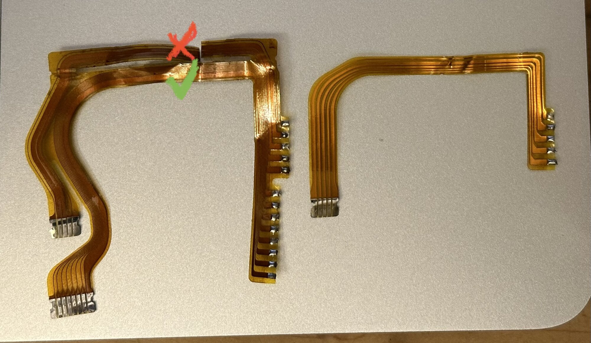

    Well well well! Lookie what we have here then!
    I just took both these units back apart a bit more.
    The original one to inspect what ribbon bit was broken and I’d tried to repair previously, and to remove the damaged ribbon from the new unit to inspect closer and see if I can do anything.
    So then I realised it turns out the snapped part on original unit was the biggest ribbon part with 8 terminals. And that one had 3 separate ribbons.
    The new one has two ribbons as one is a combined double ribbon (left part of pic), and the bit that is broken on the first unit is actually good on the new one (right part of pic)!
    I’ve done continuity test on both the good bits and appears all ok, so in theory at least, this means I have a fully intact set of ribbons when I remove the bad part of the combined one, and use the separate good cable off the old unit.
    Easier to show with a pic obviously but I’m prematurely excited about this now!

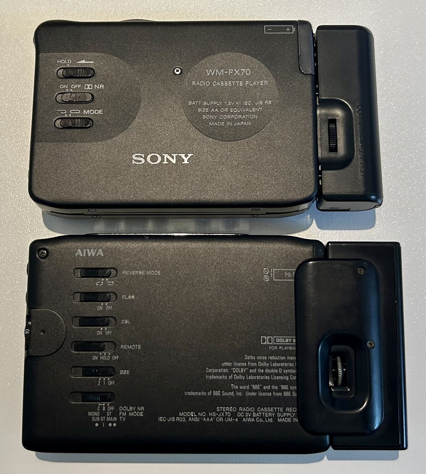

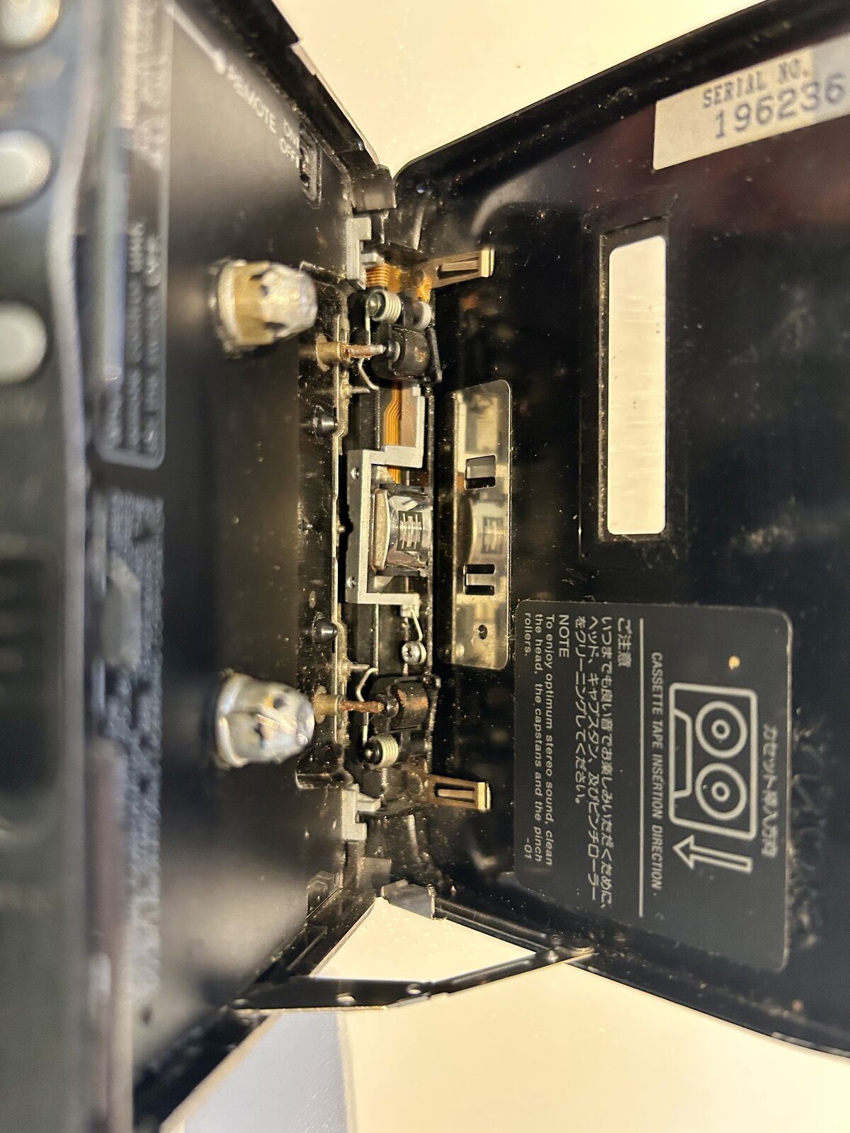

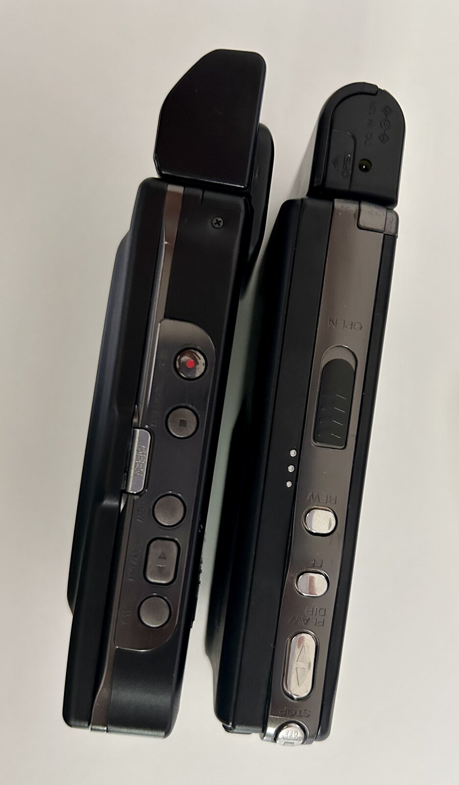

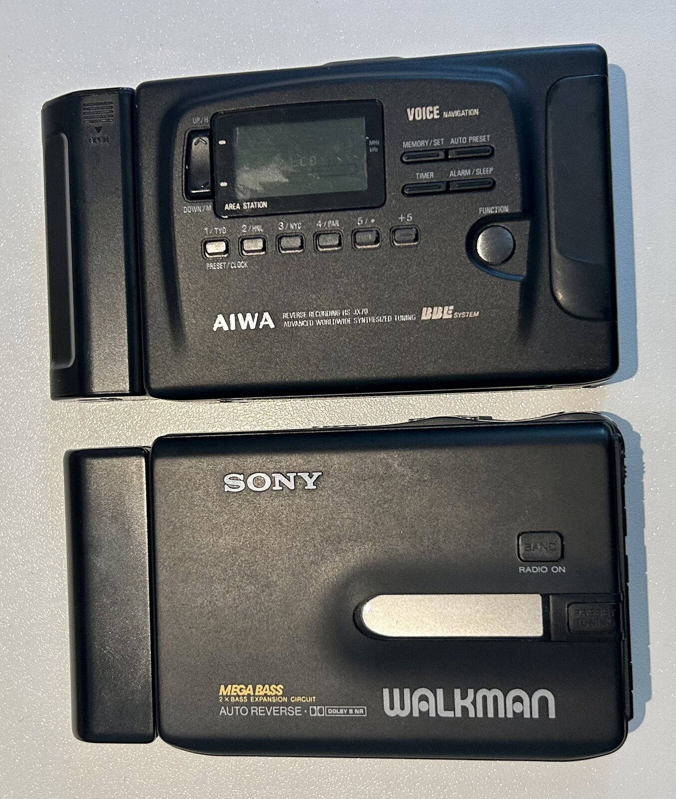

  12. Emiel
    1,115
    I just checked mine, and the rev pinch roller is also dented. Looks like the exact same issue the DX100 has, when the mechanism does not return to center for some reason.
    While I had it out, it struck me as visually close to the Aiwa HS-JX70. Pictures to support my thought. It only shares 2 ICs, had to look it up: servo and remote comparator.
    Unusual for Sony but not for Aiwa, a TRRS connector for the remote is used for the EX and FX70 , also for the EX and GX90 and perhaps very few others.
    The EX55 though uses the rarer 8 pin green connector (like the 700 series, DX100 and a few others) but not the more common 3.5 jack + 4 pin (7 pin) green connector that was often used, also for MD remotes.
    Need to go through my box of really broken ones to see if I have a spare EX or FX70, although the ribbon cable will not be the same most likely.

    Edit: it is an EX70 with apparently some water damage, judging by the capstans. The ribbon cable seems to be intact though:
