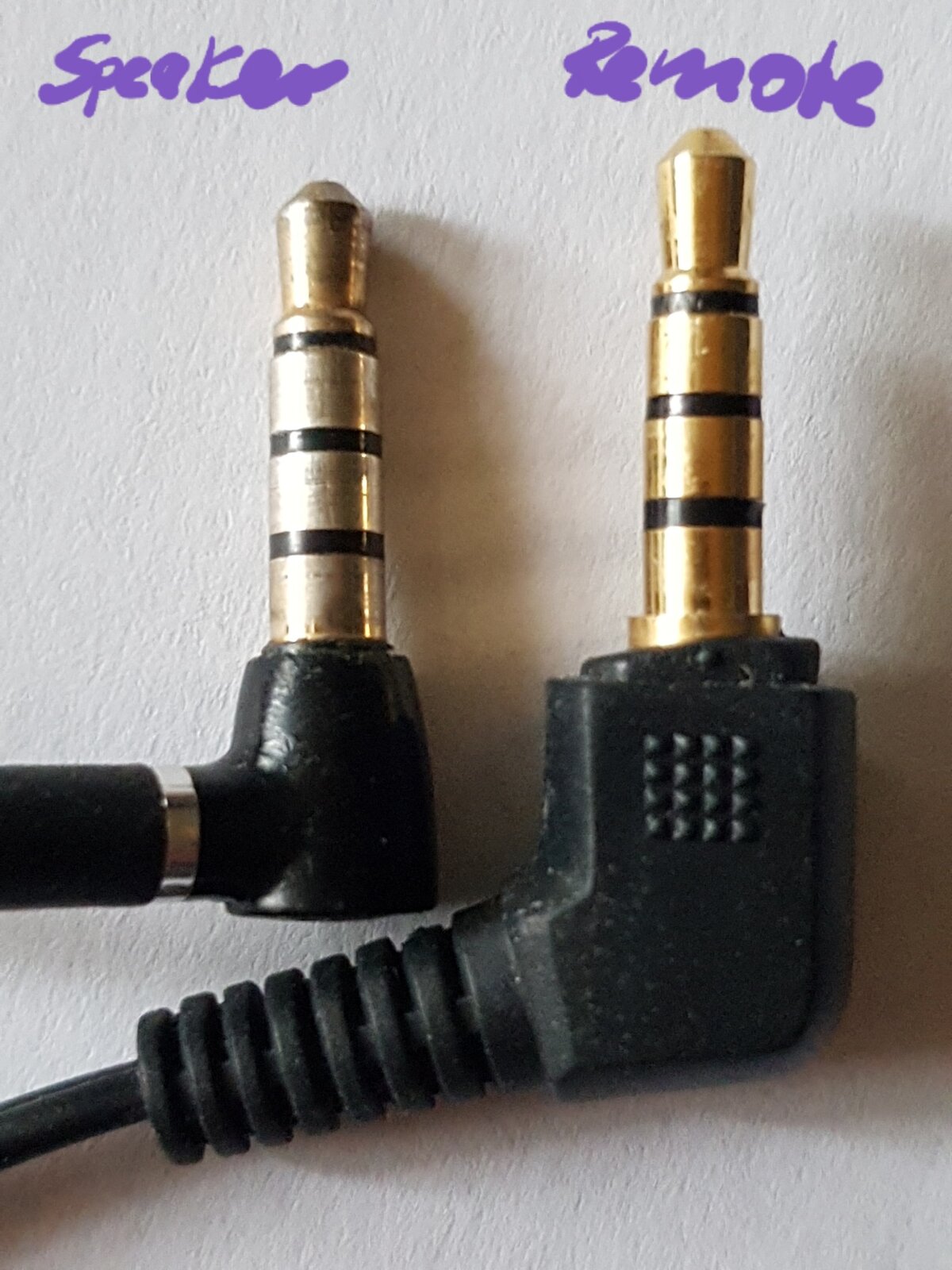

    When i plug in the 4-pin-3,5 mm - Jack of my Sennheiser - In-Ear-Headphones directly in the walkman the cassette begins to play immediately without pushing `Play`, and it doesn`t matter whether it`s activated the HOLD-function on Walkman or not.
    This doesn`t happen, when the 4-pin-3,5 mm - Jack of the Panasonic Remote is plugged, then the HOLD-function works accurately. Both Jacks seems to have same configuration and measures

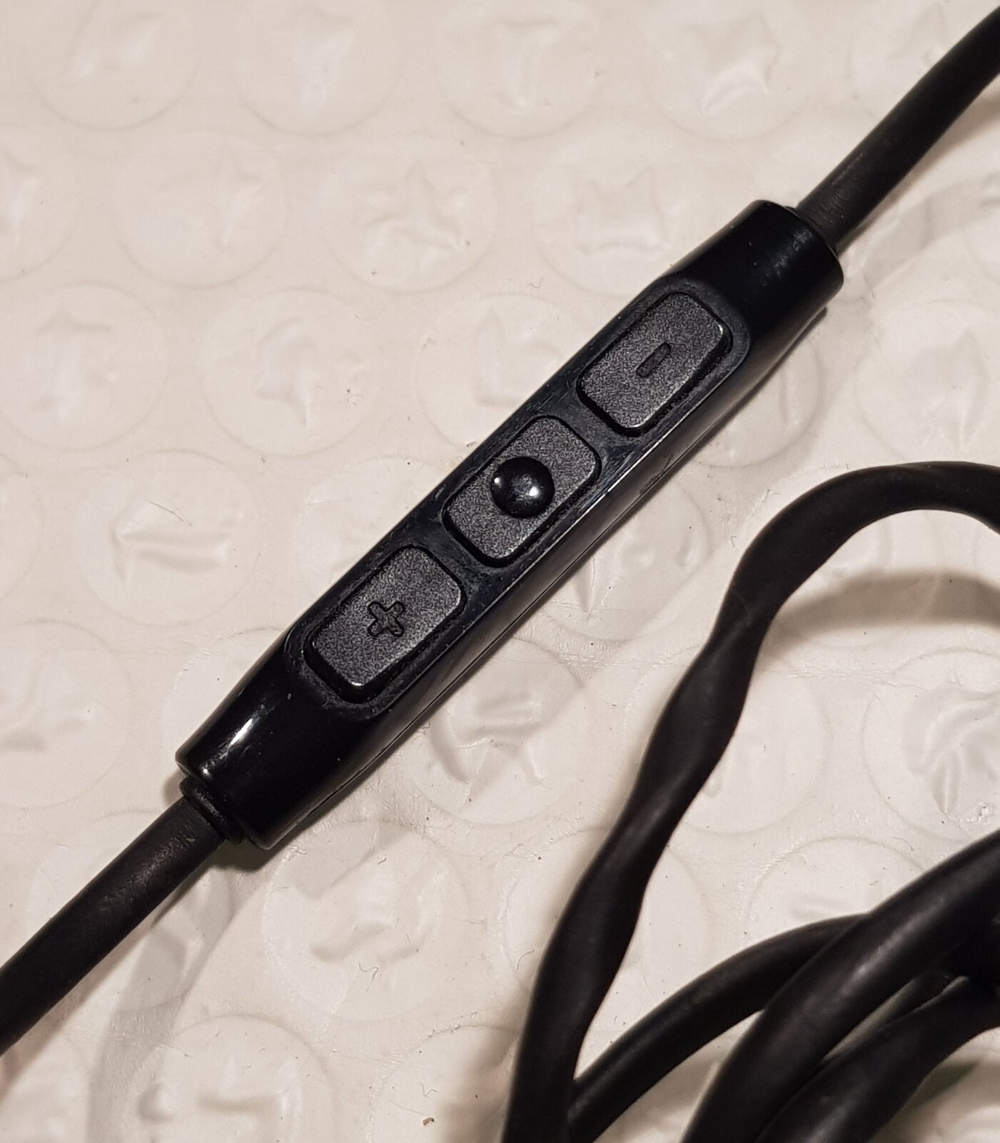

    I suspect the Sennheiser remote control.
    Additionally i can say, that there`s no other function of the Sennheisers Remote when plugged in.

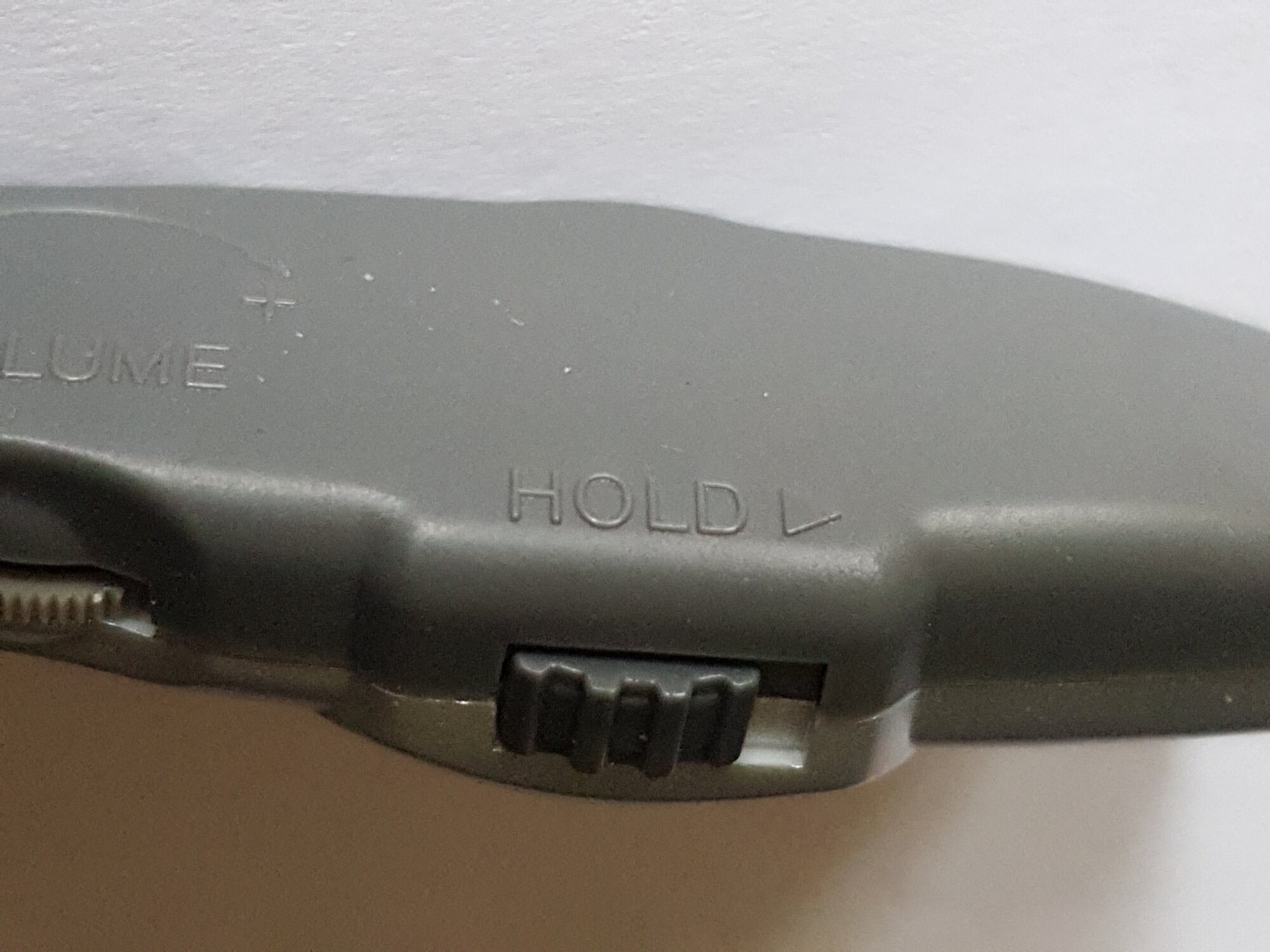

    And this only happens with the 4-pin-Jack, - when i use 3-pin-Jacks of other Headphones, the walkman works OK. And there also is no difference in behavior when you plug a 3-pin- or 4-pin-Jack in the Remote, - the HOLD-function of Panasonic Remote only works mechanically. It lockes the buttons without any electronic.
