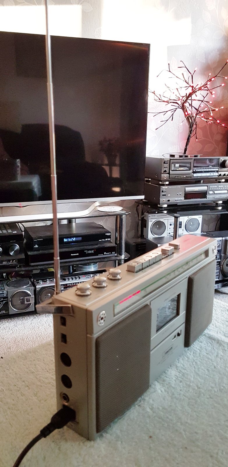

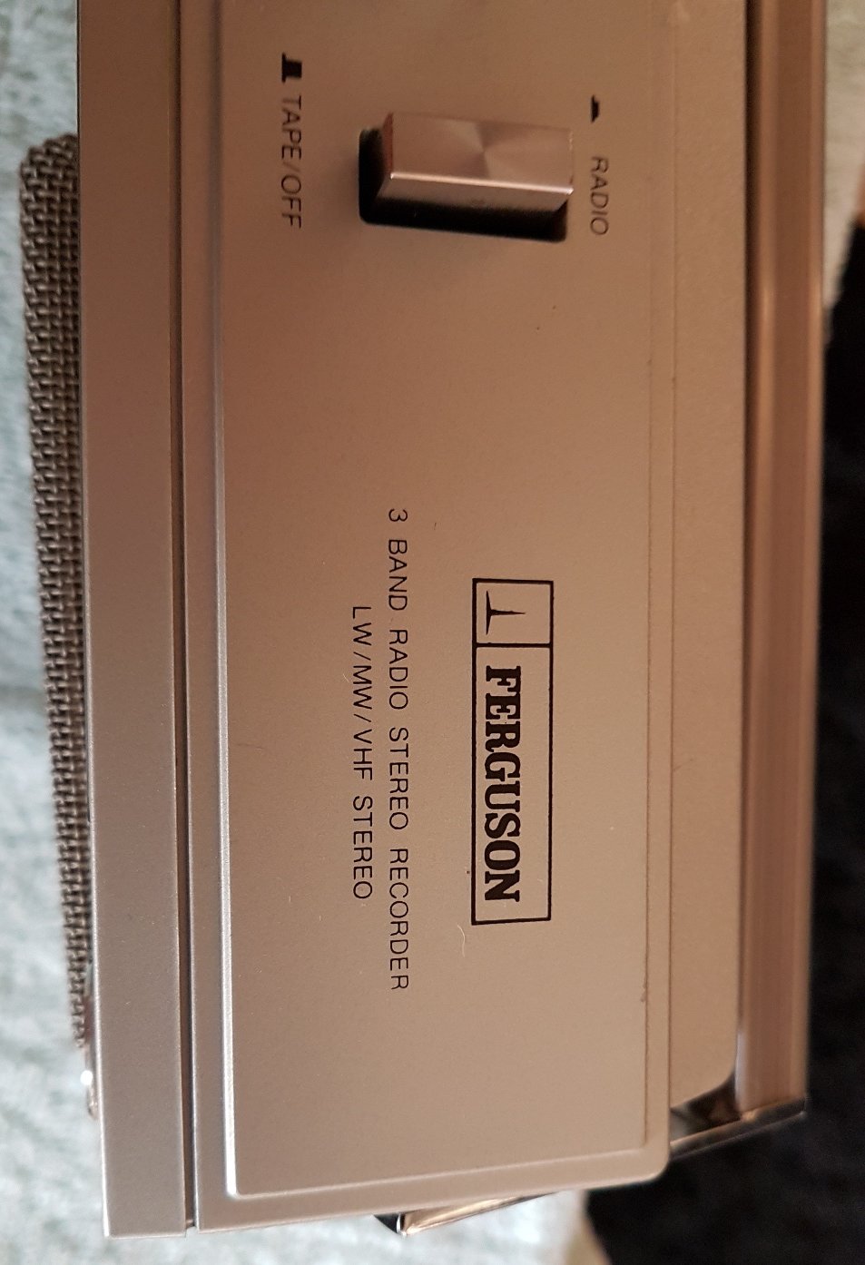

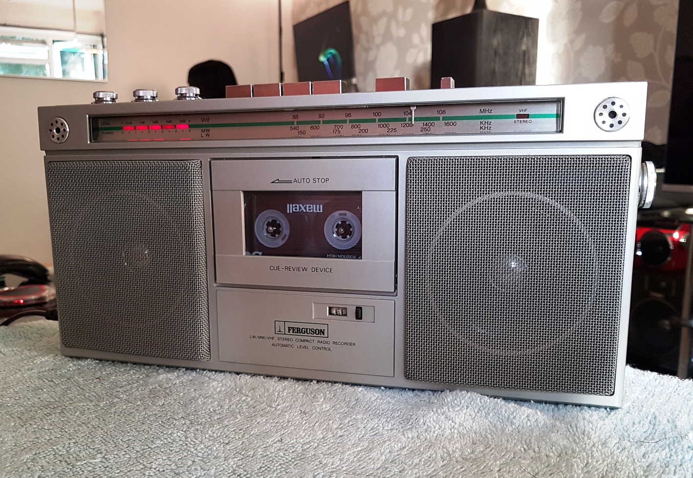

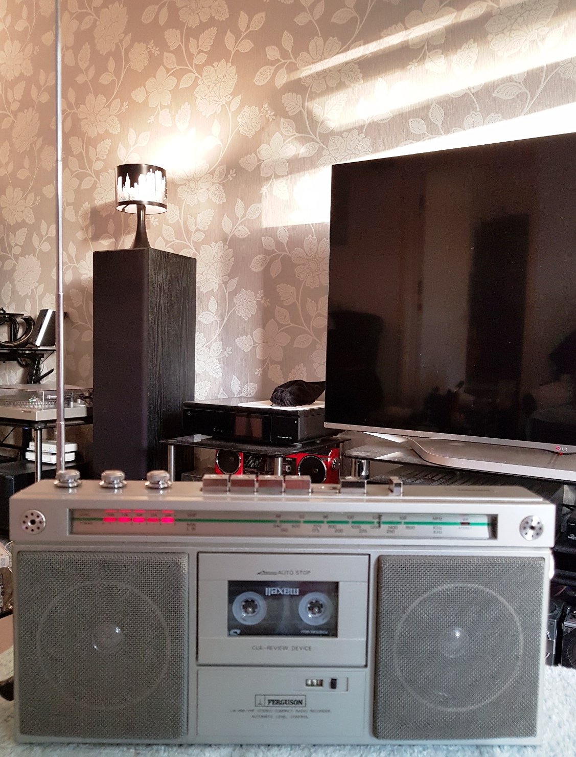

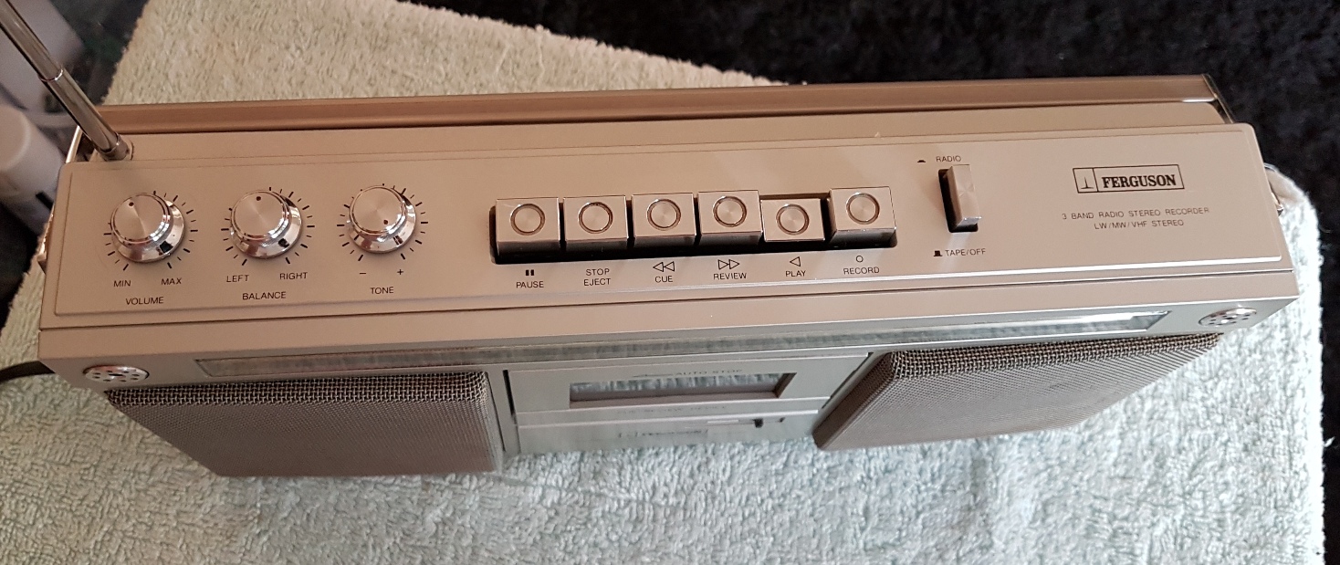

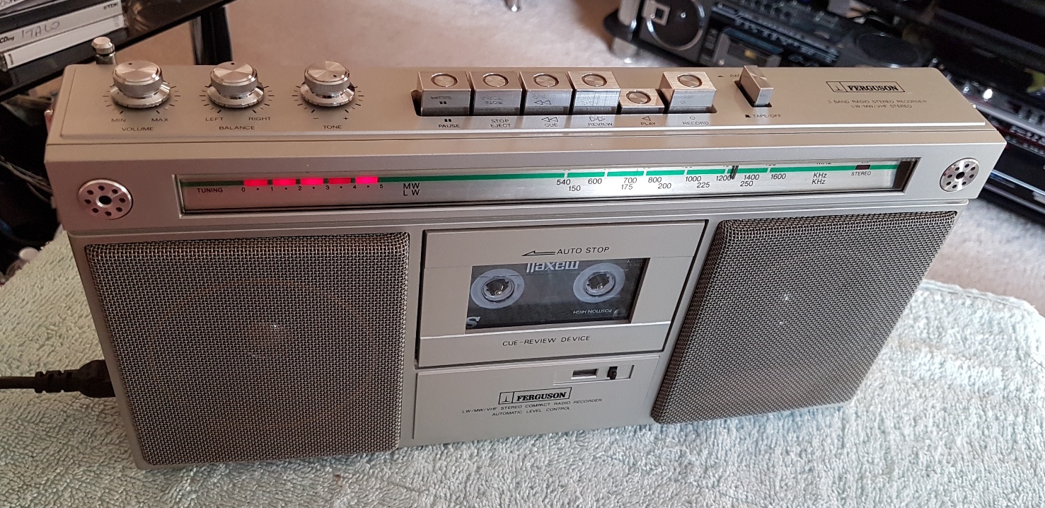

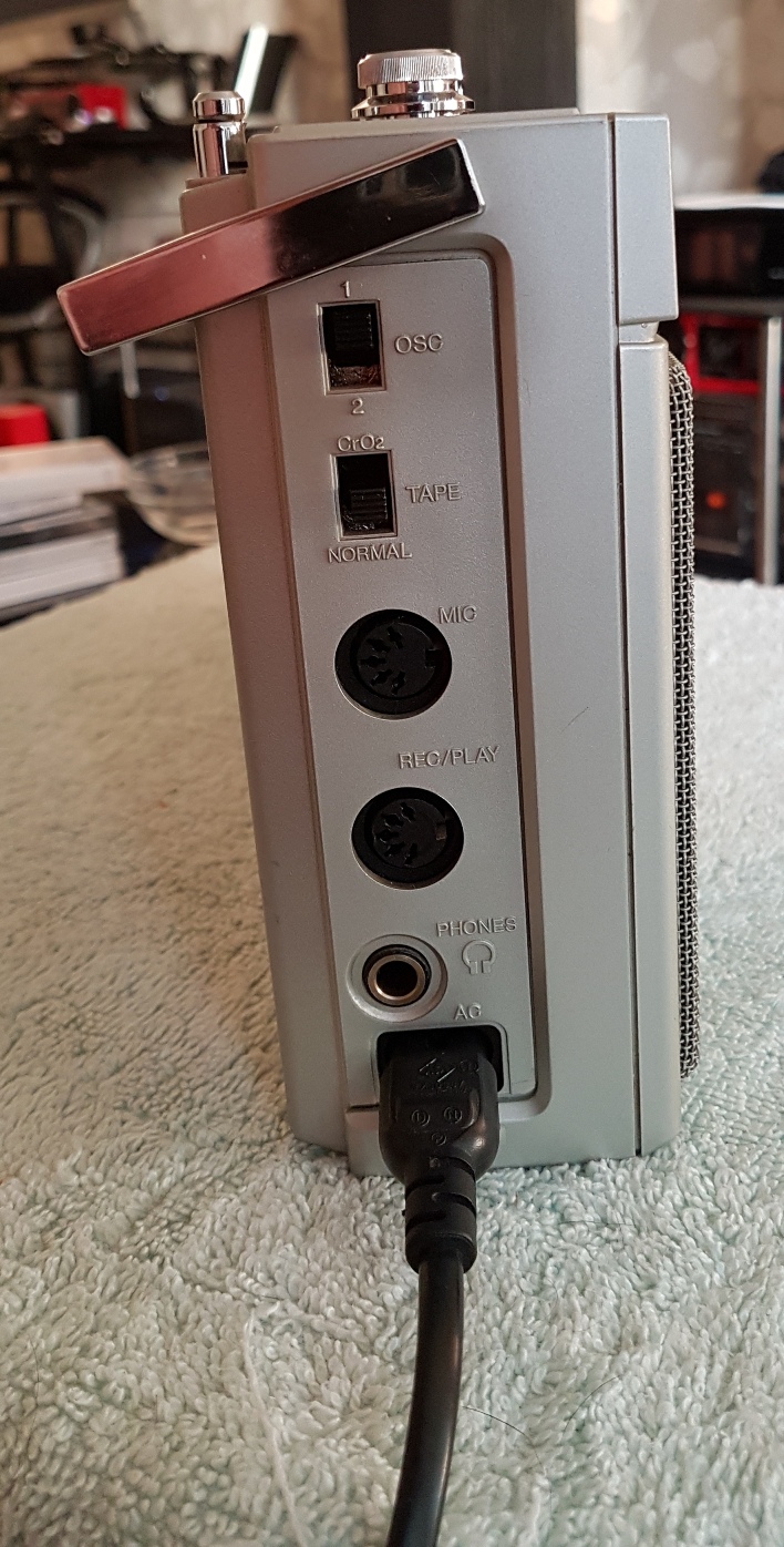

    I have been looking for a nice example of this mini for a long time........

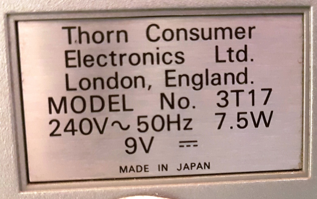

    I am still curious as to who actually made these stereo's - JVC made the 3T13, a clone of the JVC RC-656LB minus a couple of features!

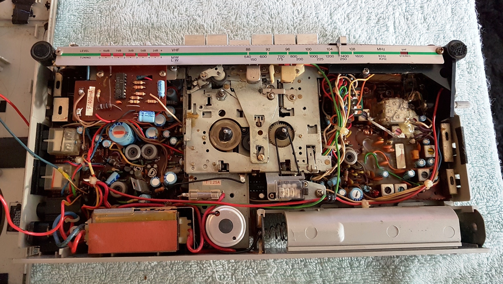

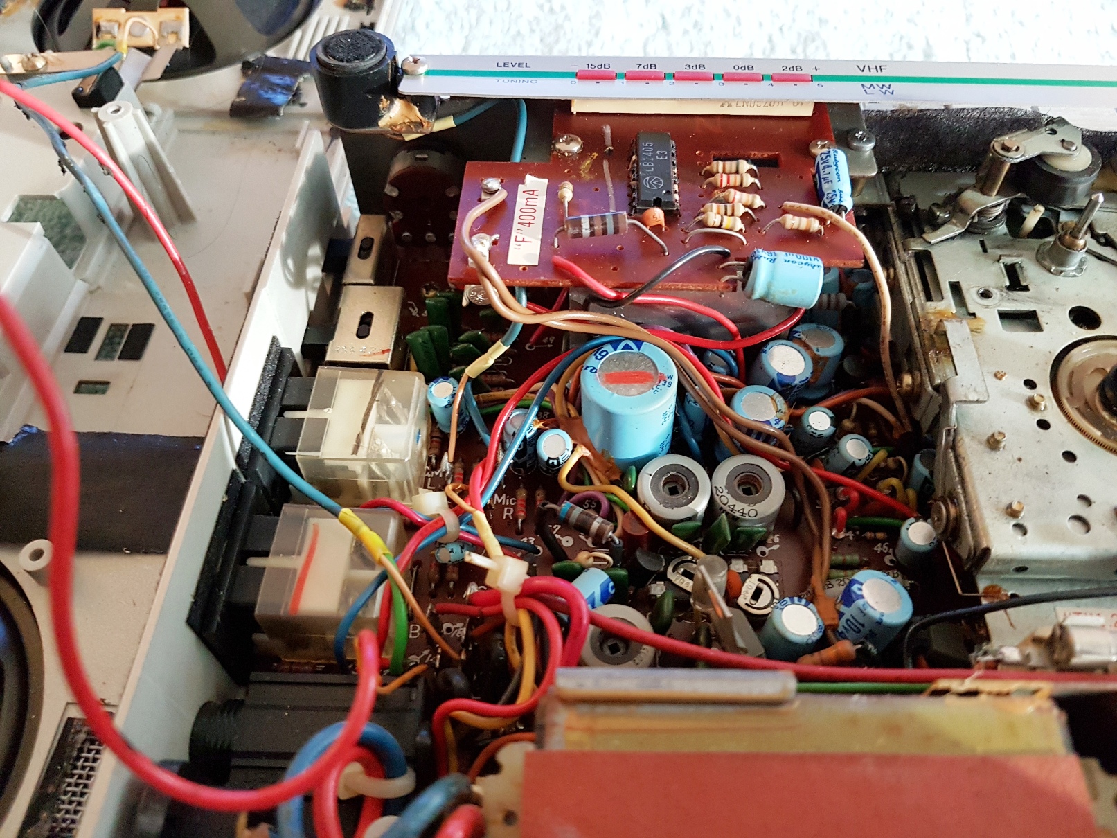

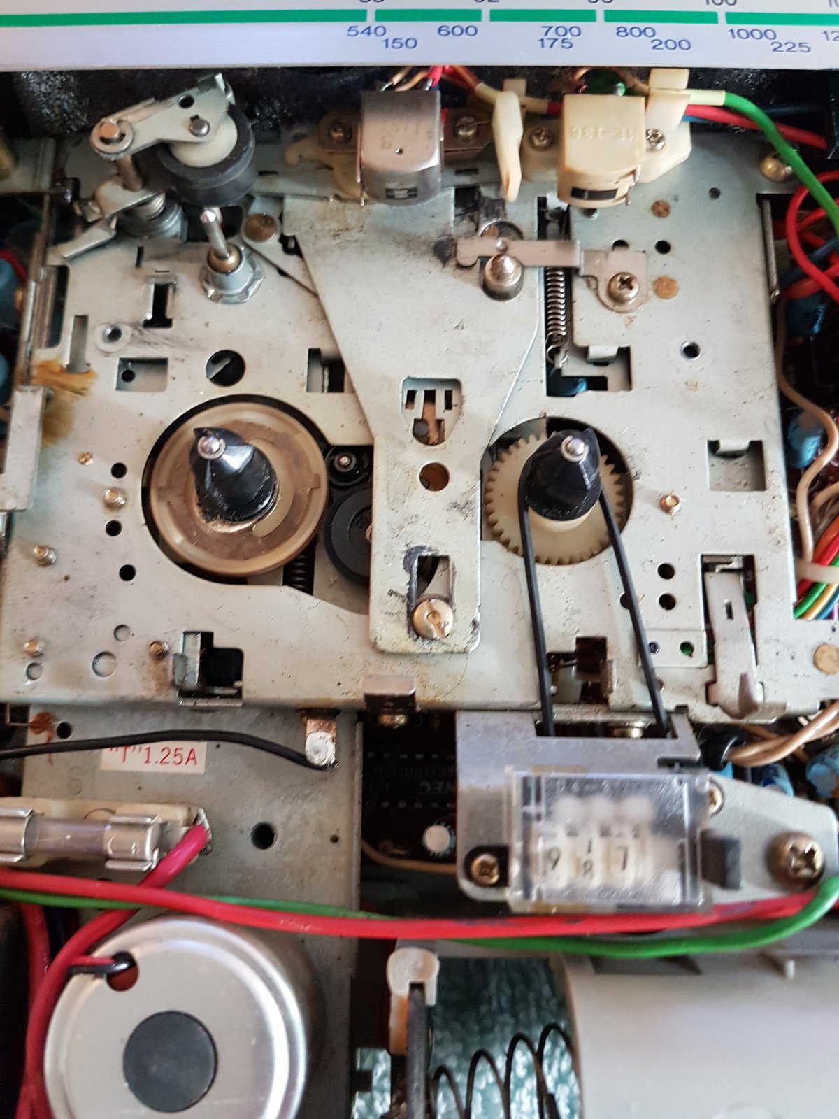

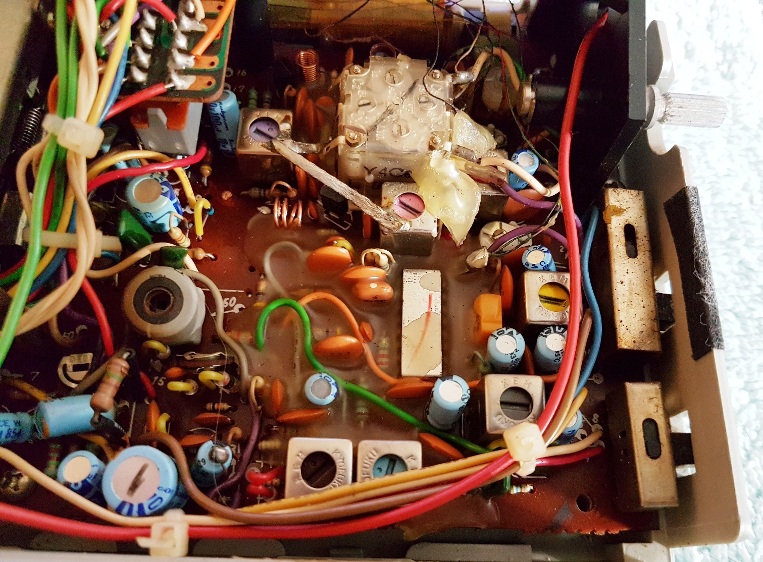

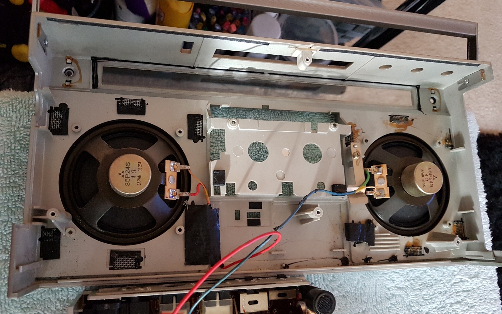

    This mini is very well built but it's also not easy to re-belt or work on despite it looking relatively easy!
    So onto the clean up.........all switches & pots were really gummed up & the side switches seized solid...........A good dose of Servisol sorted them out eventually........
    Next the heads & reel idler tyre were filthy so a good half hour was spent to get the roller back to black, the heads shiny again & the reel idler that was covered in gunk restored to black :)
    Lastly before reassembly, check tape azimuth - This was a good one, it was way out in fact 3 & a half turns of the head adjustment screw!!

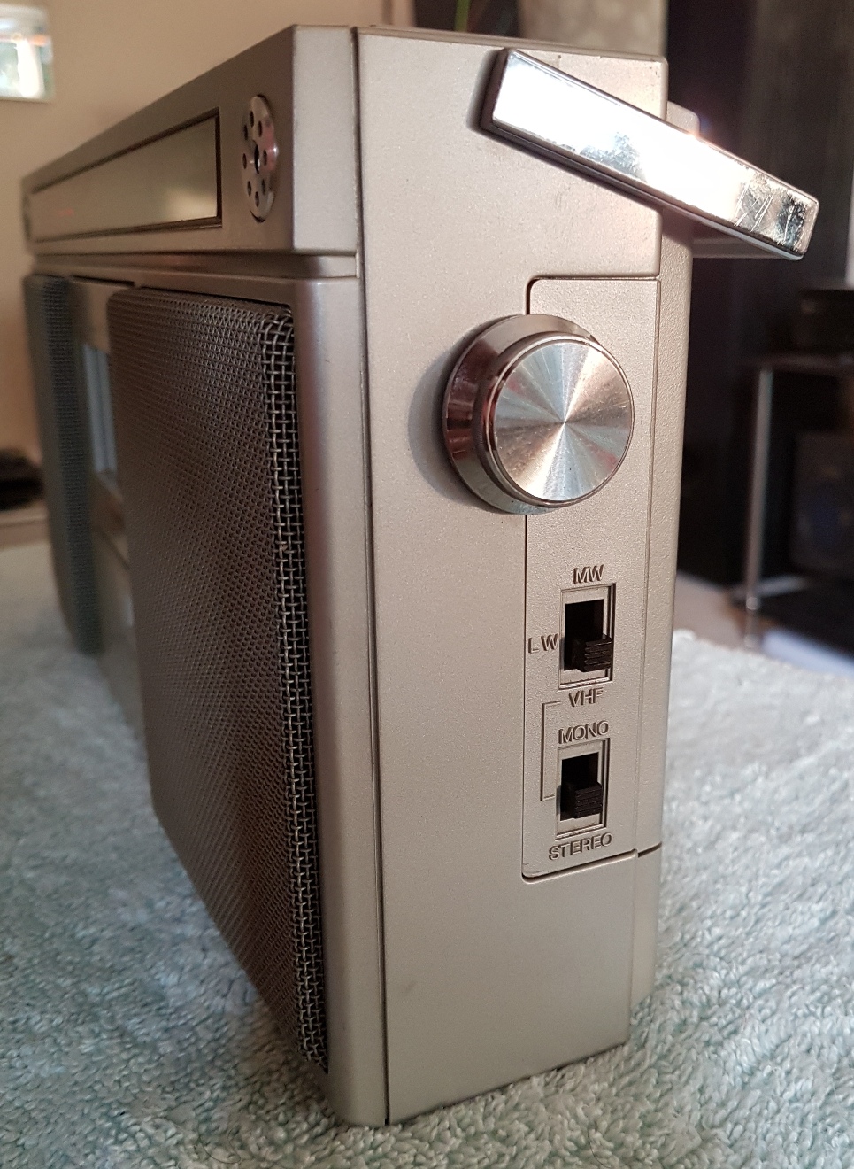

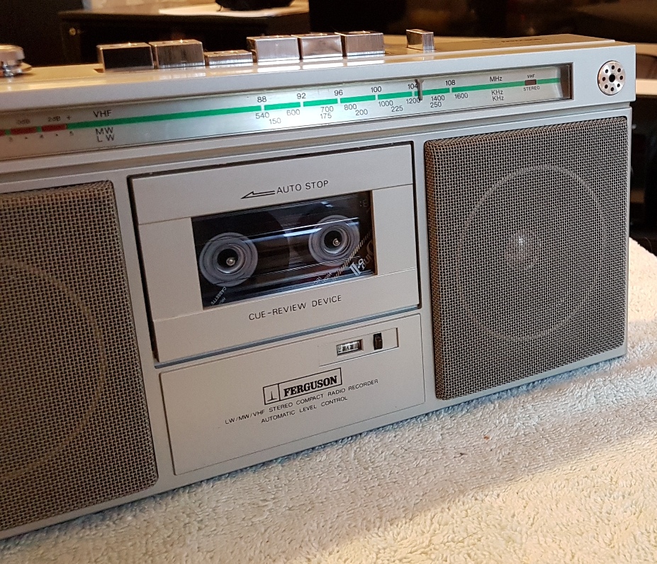

    The Result is a really nice & very heavy radio which despite the speaker magnet size, it sounds very good for a tiny little unit!
    Glad to have found my 3T18's little brother............
    Et Viola:
    Ferguson 3T17 Stereo Radio Recorder - June 2018 (1).jpg Ferguson 3T17 Stereo Radio Recorder - June 2018 (2).jpg Ferguson 3T17 Stereo Radio Recorder - June 2018 (3).jpg Ferguson 3T17 Stereo Radio Recorder - June 2018 (4).jpg Ferguson 3T17 Stereo Radio Recorder - June 2018 (5).jpg Ferguson 3T17 Stereo Radio Recorder - June 2018 (6).jpg Ferguson 3T17 Stereo Radio Recorder - June 2018 (7).jpg Ferguson 3T17 Stereo Radio Recorder - June 2018 (9).jpg Ferguson 3T17 Stereo Radio Recorder - June 2018 (10).jpg Ferguson 3T17 Stereo Radio Recorder - June 2018 (11).jpg Ferguson 3T17 Stereo Radio Recorder - June 2018 (12).jpg Ferguson 3T17 Stereo Radio Recorder - June 2018 (13).jpg Ferguson 3T17 Stereo Radio Recorder - June 2018 (14).jpg Ferguson 3T17 Stereo Radio Recorder - June 2018 (15).jpg Ferguson 3T17 Stereo Radio Recorder - June 2018 (16).jpg Ferguson 3T17 Stereo Radio Recorder - June 2018 (17).jpg Ferguson 3T17 Stereo Radio Recorder - June 2018 (18).jpg Ferguson 3T17 Stereo Radio Recorder - June 2018 (19).jpg Ferguson 3T17 Stereo Radio Recorder - June 2018 (20).jpg Ferguson 3T17 Stereo Radio Recorder - June 2018 (21).jpg Ferguson 3T17 Stereo Radio Recorder - June 2018 (22).jpg
