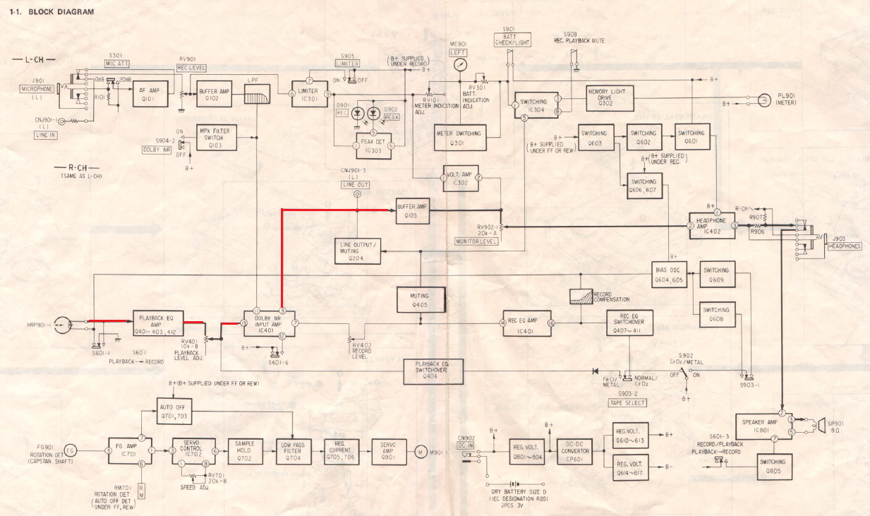

    I suggest to start by looking at the block diagram signal path. From my understanding you said that the line out is fine, but you have no left channel on headphones out and no VU-meter movement.
    If we look at the block digram of TC-D5M (don't have the manual for D5 but should be very similar), we can see the line out is taken directly from the CX174 Dolby IC. So that we know to be good.
    After that we have the Q105 buffer amplifier which drives both the VU-meter circuit and the headphones out. I would look in that area, especially cold solder joints on the small PCB near the speaker.
    In regard to the continuity test, you need to measure the actual resistance. Below 40 ohms does not mean a short circuit.
    The outputs have some load resistors, on the D5M they're 100 ohm, so some resistance is normal to be there. Question is how low it is.

    Thanks for the help and schematic!
    No luck yet sadly, Q105 looks fine and so do the surrounding components

    The fact Q105 looks fine visually doesn't mean much. You need to check the signal path from point to point (with oscilloscope or multimeter):
    - is there signal at the base of Q105 ? What about the emitter ? Compare to Q205: is the signal level similar ?
    - after Q105 you have the volume potentiometer, do you have signal at the cursor ? Compare L with R: are they similar ?
    - after the potentiometer signal goes through R451 & C437 straight into pin 2 of the headphone amp (IC402, IC502). Do you have signal here ?
    - output of headphone amps are at pin 3: do you have signal here ?
    If you don't have a scope, feed the line in with a sinewave (can be from a DAP, computer), put the unit in record mode and measure the AC voltage with a multimeter.
