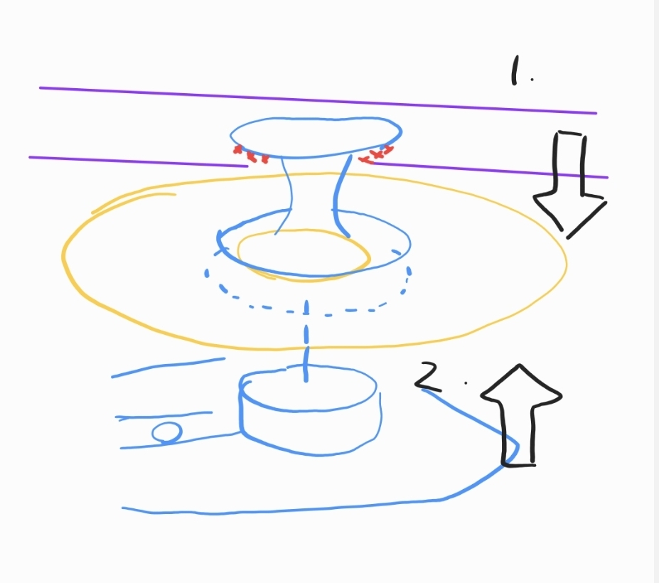

    My Panasonic SL-S700 had cracked plastic and several broken screw mounts. I tried repairing them with model putty, but it still wouldn't read CDs. The situation was just as described here—it made a terrible noise, yet the CDs showed no signs of physical wear.
    Thanks to Jorge's tip, I tried pressing down on the top cover and was surprised to find it could read CDs again. Since I couldn't lower the cover's height any further, I decided to raise the optical pickup instead. The advantages of this approach are: first, it’s much simpler; and second, it maintains the correct distance between the laser lens and the CD. As a result, it can read discs properly even without recalibrating the Tracking Balance (TB) or Focus Balance (FB). Now, I can finally enjoy its wonderful music again.

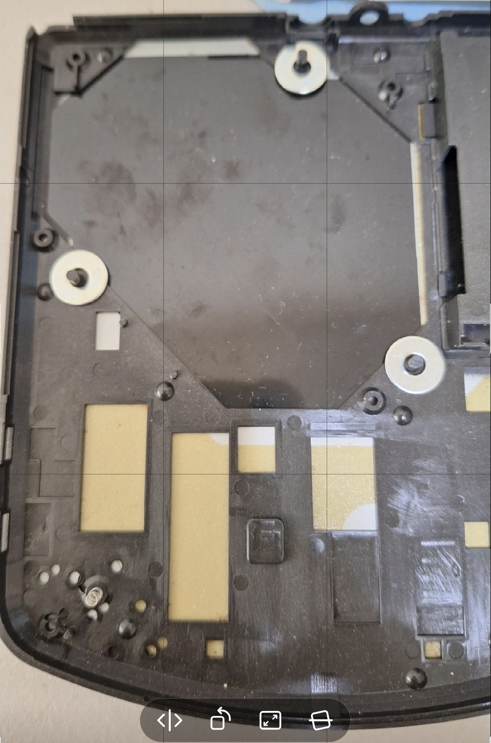

    Hello and good day. Thanks a lot for the reply and the pictures, they are worth a 1000 words. After fiddling a lot with the player, I realized that the turntable has been pushed in, which brought the CD too close to the laser. Before any modifications from my side, the turntable was at around 0.5 mm from the motor. After several adjustments, I settled on 0.65 mm (this after completely rebuilding the ABS middle frame and restoring 7 out of 9 screw posts that were completely gone). With 0.7 mm, the CD ended up too far away from the laser and I had to slightly push the CD down for it to focus. With 0.6 mm happened the opposite: the CD was too close and I had to lift it a little (or push on the side opposite to where the laser is) for it to focus. At 0.65 mm the player sometimes focus successfully, while other times it needs a very light tap on the player's case for the focus to work. The eye pattern looks very noisy and I can hear the tracking working quite a lot, but the player works. I know that the motor. I compared the lateral play on the SL-XP700 vs my working SL-XPS900, and they feel very similar.
    Nevertheless, considering the very poor condition this player came to me, I am glad that it works at all. I will risk it and open it again to test your solution with the shims (3D-printed PLA parts with self-tapping threads do not like being screwed very often). Did you happen to measure the distance between the motor and the turntable on your player? It would be interesting to know what the factory distance is.

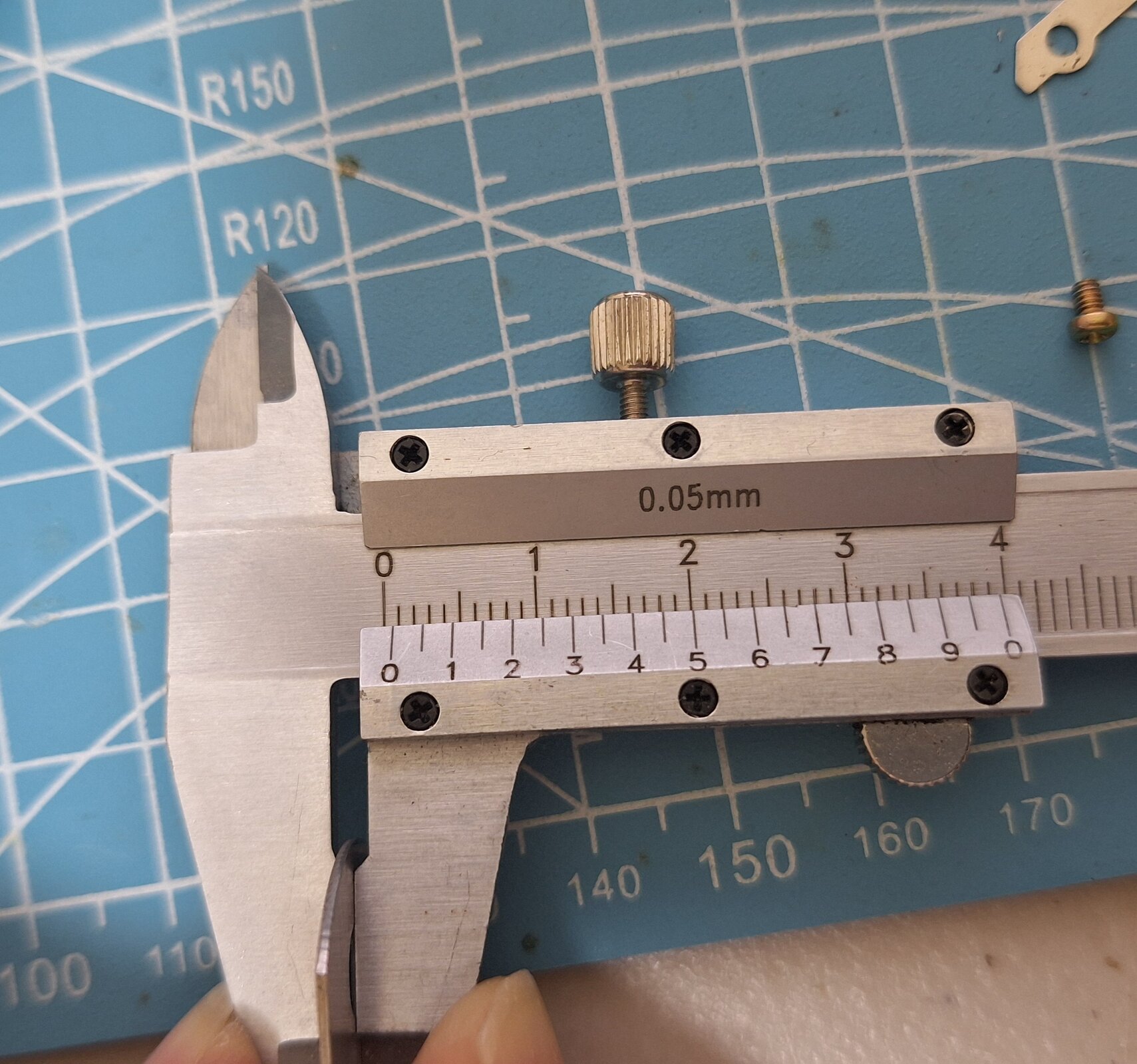

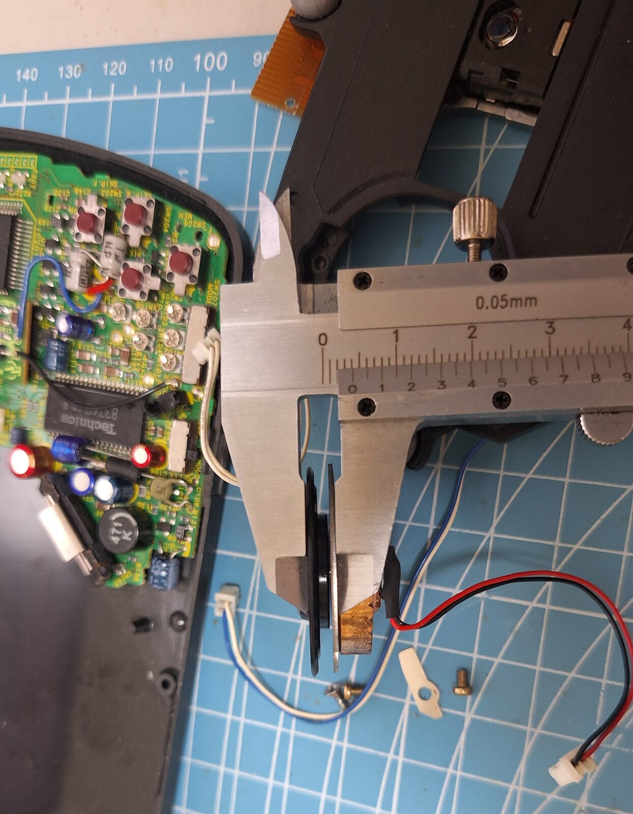

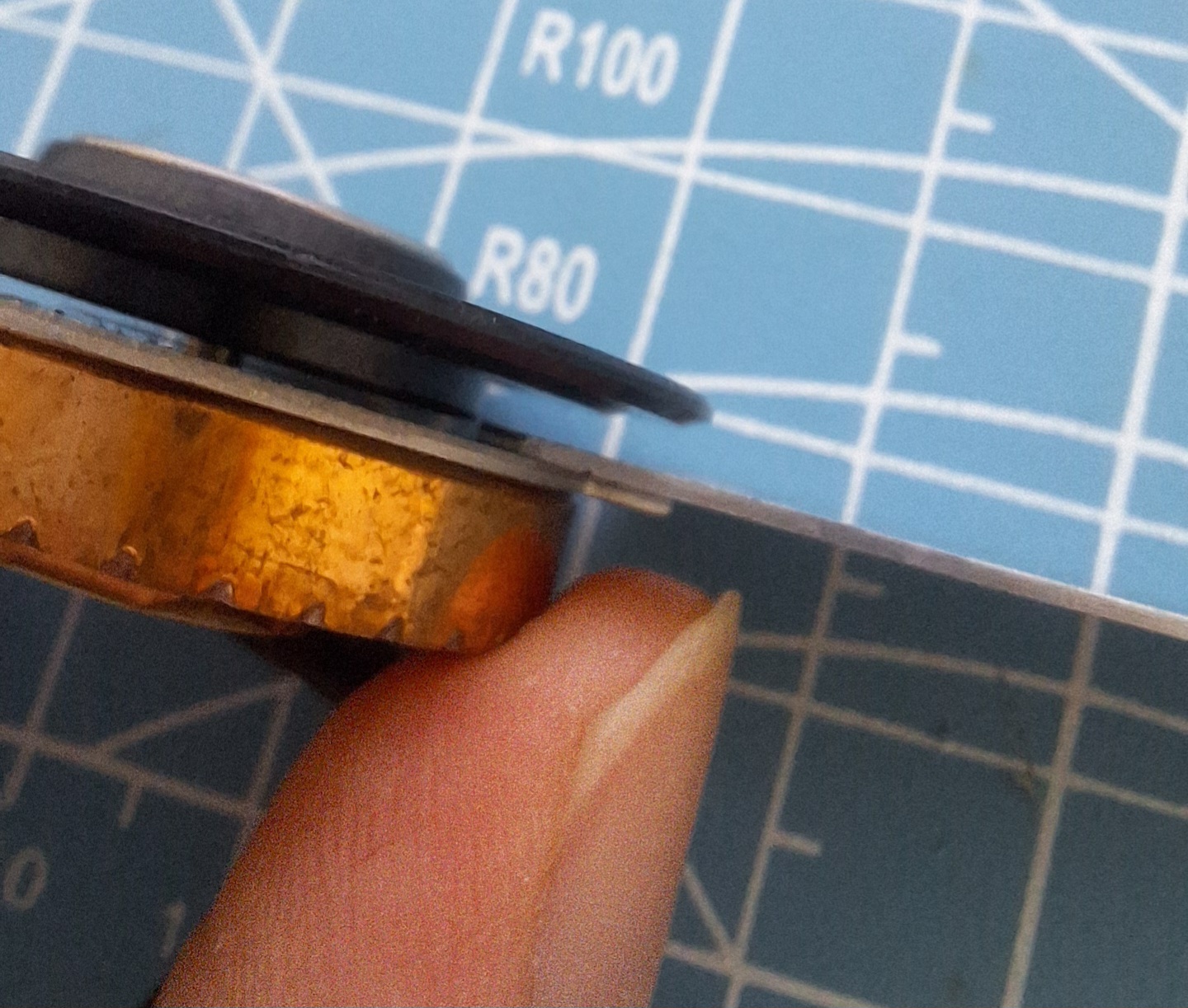

    I couldn’t get my first XPS700 to work, so I’ve removed the top cover to investigate further. I’ll organize the photos and post them later.
    In the meantime, I can provide the measurements you requested. Regarding "the distance between the motor and the turntable," from what I recall, there is no noticeable height difference between the two units I have.
    I’m not entirely sure which specific distance you're looking for, but a ruler with a thickness of 0.65mm barely fits into the gap underneath. This means the clearance is less than 0.65mm.

    Hello again! The measurement you did with the ruller thickness is exactly what I meant. From my experimentation, I found that the gap should be something between 0.6 mm and 0.65 mm, and your measurement corroborates my results. Thanks a lot for that bit of info.
