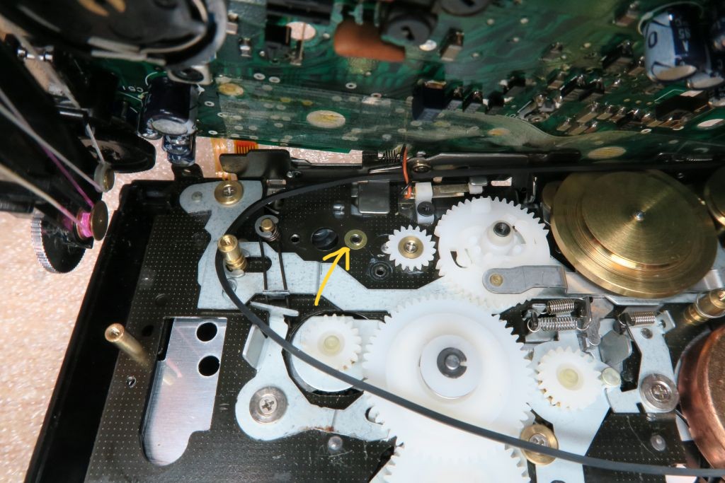

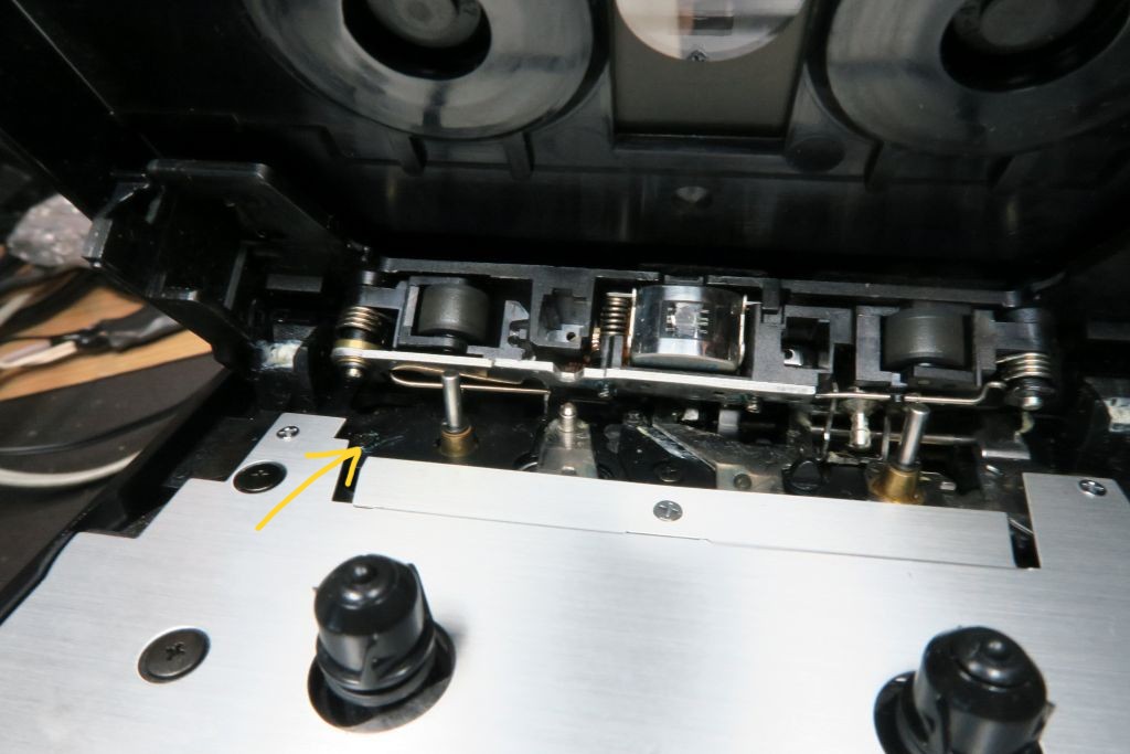

    This is, presumably, why Toshiba included a feature in (at least some of) their auto-reverse models to allow the angle of one capstan to be adjusted. The mechanism is easiest seen in the KT-4168, below - the adjustment screw for the angle of the reverse capstan is arrowed, and is accessible through a hole in the rear panel.

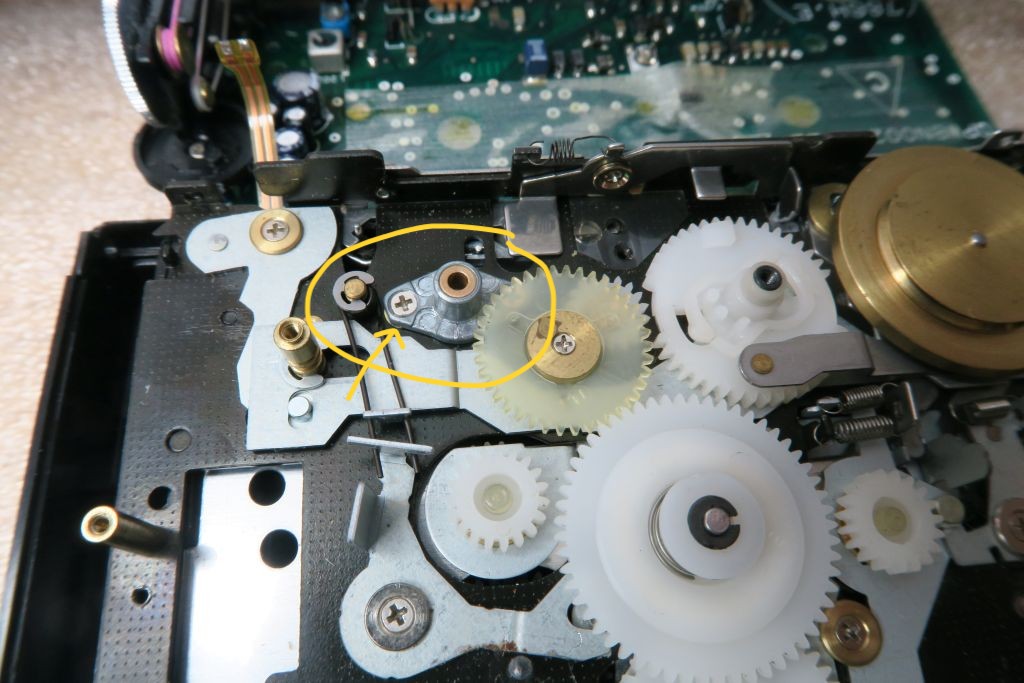

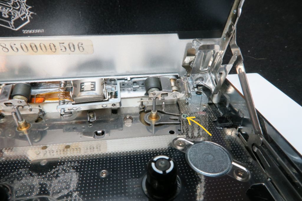

    The same type of adjustment is also possible, this time on the forward capstan, in this KT-4035 (not a great photo, but the arrow is pointing to a black screw head):

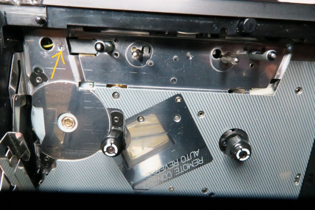

    Also featured on the KT-4177 (KT-GS3) below. The azimuth adjustment procedure is actually specified in the service manual for this model. The head azimuth is first adjusted in reverse playback mode, then the forward capstan angle is adjusted in forward playback mode to optimise forward azimuth. And it works!!

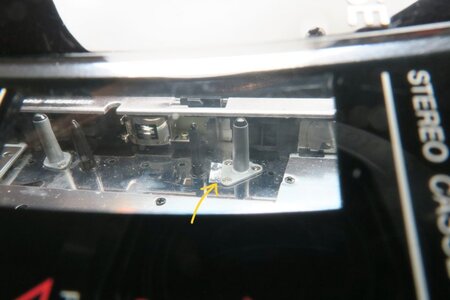

    One of the units in my collection that was suffering alignment issues was a Panasonic RQ-JA2. This model has the capstan bearing housings screw-mounted to the chassis. I did some azimuth measurements in each direction, and worked out that the capstans must have been angled very slightly inwards towards each other. So, with a bit of trial and error, I adjusted the angle of the reverse capstan outwards a little by slipping a few layers of kitchen foil under the inner edge of the bearing housing. And this worked, too! I now have perfect azimuth alignment in both directions! Pic below...

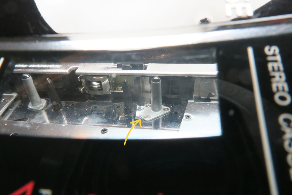

    Similarly on a Sharp JC-785 - this one already had a thin spacer under one side of the capstan bearing housing (presumably factory-fitted), and I got just the right amount of adjustment by moving the spacer to the opposite screw. Again, it worked!!

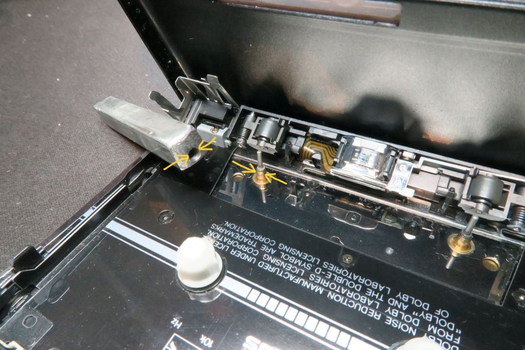

    More recently, I've extended the idea to align couple of Panasonic RQ-S series models... these do not provide any adjustment, so I've made a tool for the job. It's simply a metal bar with a hole drilled in one end, equal in diameter to the bearing shank, and deep enough to accommodate the height of the capstan. I slot the bar over the capstan so that the hole is a close fit over the bearing, and use gentle force to bend it in the required direction. The brass bearings are press-fitted into a thin steel backplate, which bends easily enough with a little pressure. Both the units I've restored have needed the forward capstan bearing tilted slightly inwards towards the head.
