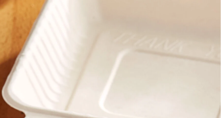

  7. euroflash
    euroflash Member
    62
    Oregon
    Thanks, Steve!
    Is this the natural fiber clamshell you suggested? I am sure I can dig one out and will follow your directions. Does the DIY fiber washer need to be oiled? My original "survivor" washer looks like it has a bit of oil or lubricant on it. I want to make sure I don't gum up the capstan shaft.
  8. Steve Grant
    Steve Grant Active Member
    225
    Vancouver British Columbia
    No, the material I meant is clear plastic, like a soda or pop bottle. Only flatter. Shaped like the picture you posted.
    None of the players I have worked on have washers that I would describe as "fibrous". They do have tan-colored opaque washers. I haven't cut into one to see if they are fibrous inside. I think the clear plastic would be an entirely suitable replacement and would not be affected by lubricants.
