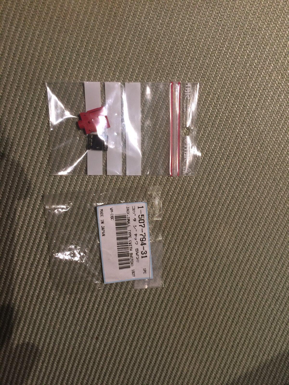

    Here is the jack I took from my other WM-D6C and the partnr from the new I bougth. I´m not sure what You mean with metal back pandel and the metal spring You mentioned. Only thing I associate with ground is the litlle copper thing screwed on the mainboard.

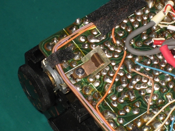

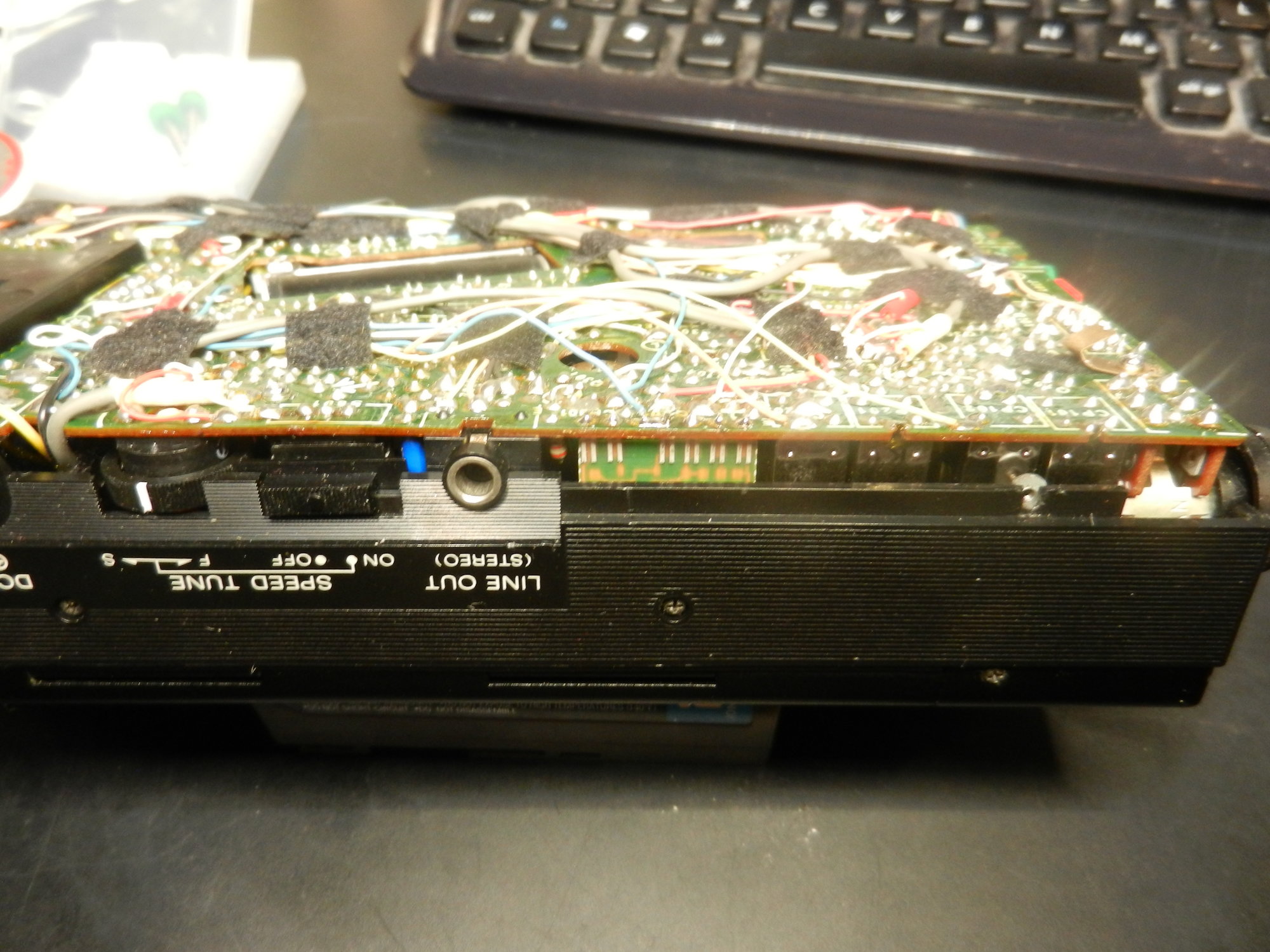

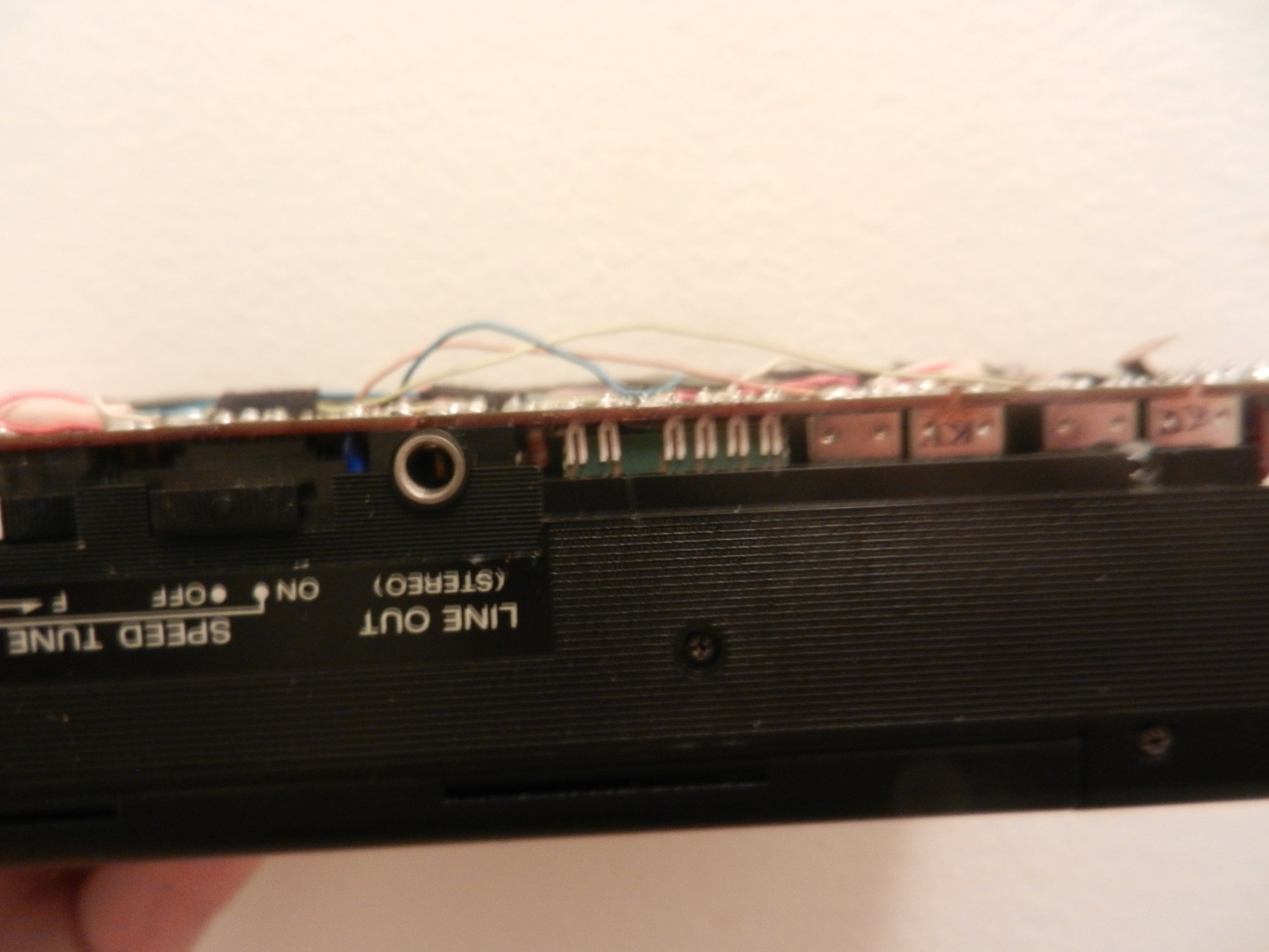

    By the metal back panel, I mean the back cover. The metal spring is this; I take it that this is the little copper thing screwed on the main board. When the back cover is fitted, the copper spring makes contact with the metal cover through the round hole in the clear plastic insulating sheet inside the metal cover. The grounded metal cover shields the main board from radio and electrical interference.
    You were very lucky to find a genuine Sony mic socket on Ebay, they must be quite rare now.
    If you are still getting scratching noises with the "new" mic socket, then it may be worth cleaning the contacts on the jack socket and switch assembly on it as the "new" socket may have been in storage for up to 33 years.
