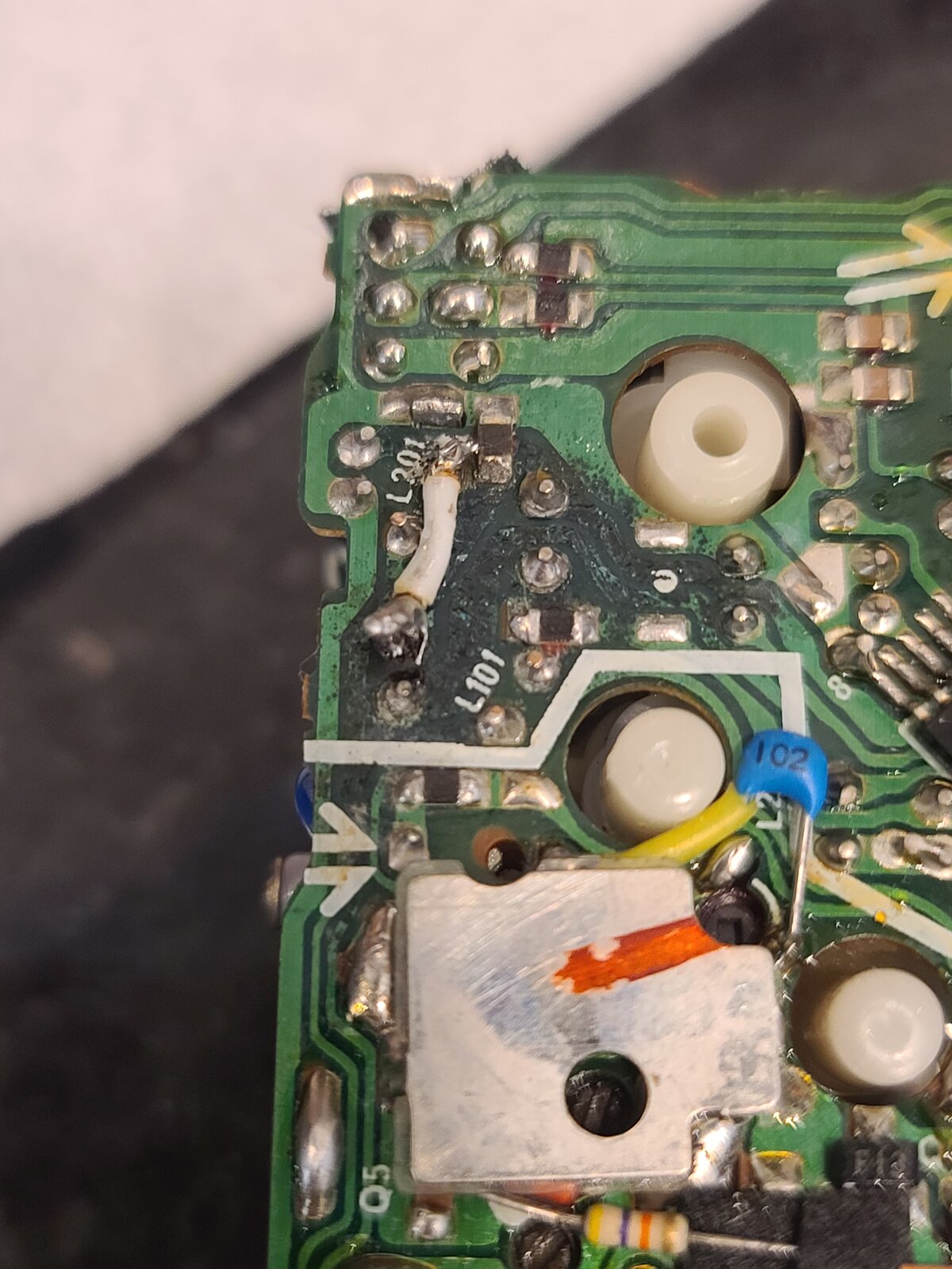

    I know this is an ancient thread but I had the exact same problem on a wm-f5. No audio through the right channel on both headphone jacks and on radio and tape playback.
    When I opened it up, there was some minor corrosion damage by the volume pot. I checked continuity on the trace paths following the service manual schematic and shockingly, only one trace was actually severed. One real pain soldering a tiny section of wire in and now it has both channels again.
    This is just what worked in my specific case of course.
    Edit: I actually did not see that stray strand of exposed wire until I uploaded the picture! Took care of that. And yeah, my soldering skills are not good with small tight spaces.
