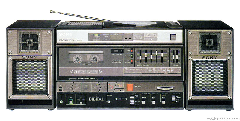

    ...I always said the shop-bought "musicassettes" were poorer quality than the likes of TDK & unfortunately for my Sony CFD-5, I've been proved right.
    While giving this excellent auto-reverse deck some exercise (it has 'quick' reverse, music search, Dolby, metal, all on a portable - now there's posh), having happily played many old TDKs, a musicassette copy of Down To Earth by Rainbow (bought by me in the 80s) jammed it :(
    Taking it apart: when screws are removed (boombox screwdriver required) the front panel wants to come off but requires the tape door to be open. Some gentle easing led me to discover that the front of the tape door unclips upward & off, revealing a mechanism on the left to override the locked eject button. They actually designed that in, knowing at some point in the future it might be needed. Tape removed, giving access to the screws holding the deck mechanism in. The engineering inside is exquisite - no wonder these were so expensive.
    Once I had the deck mechanism out (bit nervous by now), I could manually turn the servo wheel to 'park' the deck in stop mode. I then noticed the culprit: the main belt from the motor (which goes 'round two large flywheels) was rather loose, so I need to hunt down my copy of the service manual to find a replacement belt. Then I'll need plenty of courage to attempt a fix - there are wires everywhere for me to accidentally break...
    I originally got this boomer out with a view to possibly selling, but it's such quality, I don't think I can now...:rolleyes:
