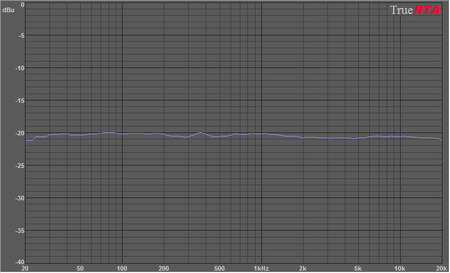

    So I opened my RTA software and generated pink noise (which a noise that has the same energy distributed in all the frequencies). I connected the Line out of my sound card to the Line IN of the DS45 (thanks that it has one). Right without recording I connected the output from the DS45 to the Line In of my card, and without XBS at all this was the result:
    I had to adjust the treble to -50% because at zero there was simply too much treble. So, you see: it has a not so flat response. So if I can reach this response with a particular cassette, that would be nice in this case.

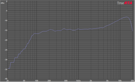

    So first I tested a simple TDK D from 1992 and recorded the pink noise at -20 dB (which is the standard volume for these tests, to avoid distortion at higher levels). Pretty plain, huh?
    From 100 Hz on, the response is more or less flat, with a deviation of +/-2 dB until around 17kHz, which is not that bad for a boombox. The bass is weak under 100Hz with a heavy fall off which goes up to 20 dB from the highest level at 500 Hz. Reason why it includes the XBS system...

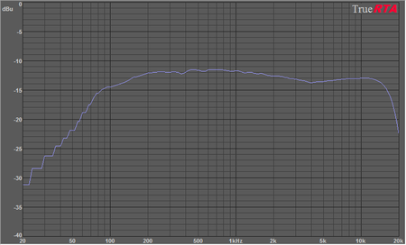

    Then I put a TDK CDIng II from 1990, a basic chrome tape. I have lots of this particular one, that I used to bought back then. Chrome tapes need much more bias and, if not properly biased during recording, the highs rise up noticeably. As this case:
    So with this tape the sound will clearly suffer and will become much more brighter. As much as 6-7 dB, which is not small...
    Conclusion: avoid using chrome tapes in a boombox. They are simply not prepared for them (as always, there are exceptions), and the resulting recording will be heavily underbiased, thus ending up in a very bright recording.

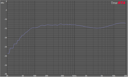

    As a reference, this is how it performs a reference deck: my Technics RS-B965, highly improved by ANT Audio. This time using a high performance tape: the TDK SA-X from 1995, accurately calibrated.
    I think nothing is left to say...
