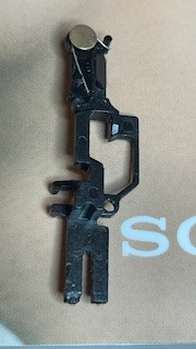

    Hello
    I manage to broke teeth of a rod in a Sony DD player and need a spare part. Anyone?

    I suggest posting here: https://stereo2go.com/forums/forums/2hand-gear-you-want/ and ask for it, there may be members who have extra pieces and are willing to give/sell one to you.
    Or buy a donor unit in poor condition, that would be a second option.
    As a general recommendation, when removing this plastic slider you should do 2 things to avoid breaking it:
    1. Have the carriage in the open door position;
    2. Instead of pulling it upwards (you need to fully compress the claws with a pair of tweezers before pulling), rotate it left.
    It will come out much easier by rotating than by pulling up and there's no risk of breaking it.

    Thek you. I am a nub here. I red lot of rulles, but still get wrong. I did this job several time and it went as you describe it. But this time it just went wrong. I eill try to rebuild it if I dont find the replacement.

    As far as the slider itself, let us know if you manage to fix it. I think such information would be useful, I've seen people breaking that slider before.
    In my opinion, if you think you are going to repair a few such DD units, it's a good idea to buy a cheap donor unit (which can be found in bad cosmetic condition), as you may find yourself needing parts in the future.
    For example, I had situations where I needed to swap the motor which is unobtainium without a donor unit. I also remember a headphone jack with internal short-circuit, case in which a donor can come in handy.
