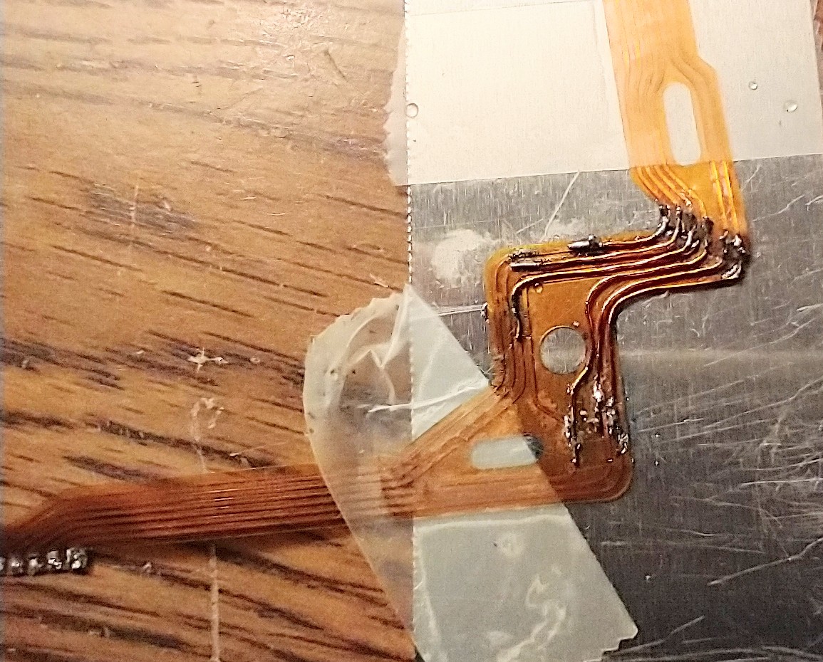

    IMG_20240524_222733757~2.jpg Transformer winding wire is solid core but very thin, and by necessity, insulated. Any half decent electronics supply store should have it.
