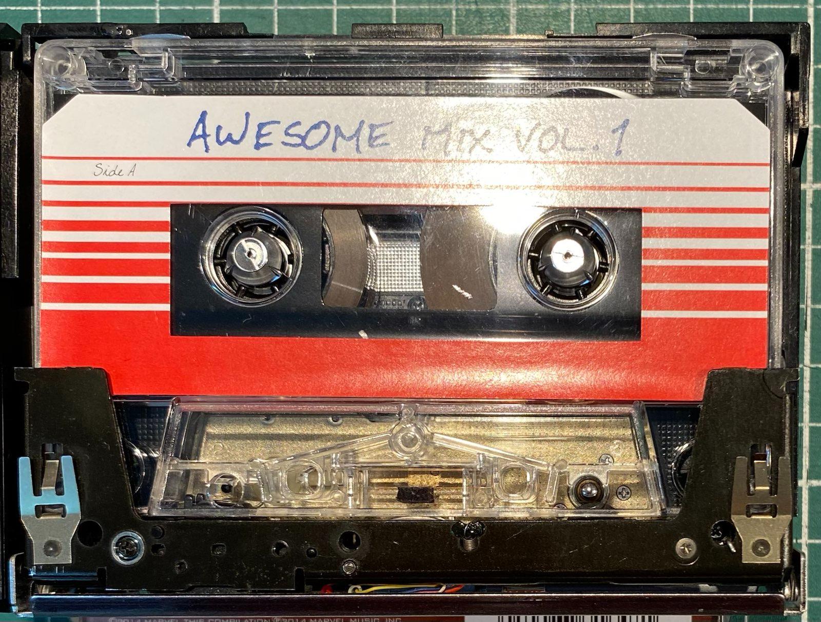

    Ok, what I can say is typically when I adjust these WM-D3s (and it's pretty typical to SONY ones in general) the right channel trimpot needs to be set significantly higher to obtain equal levels.
    Yours seems to be more or less in the same position. What tape have you used exactly from the set for this adjustment ?

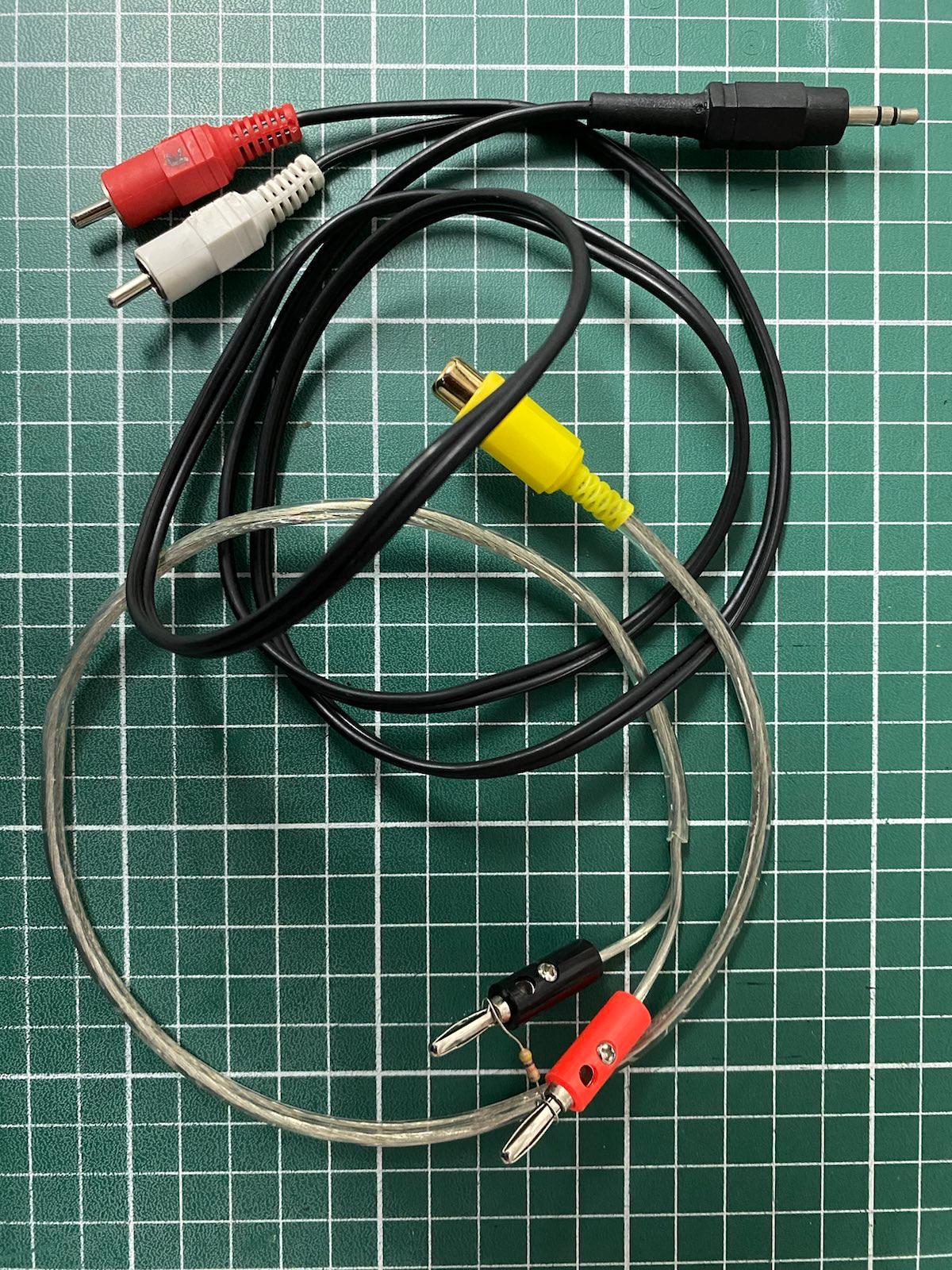

    I've also checked the cable I'm using for measurements and it's definitely a TRS :rolleyes:
    Should I also share a recording of this tape from both my WM-D3 and WM-DD 33 (line out and phones out) - if you have a doubt on the tape itself?

    I think it's a good idea to make recordings of the tape itself in both units, curious of the result. Also, try to see if setting the EQ to 120us makes a difference in the balance situation.
    Is the seller specifically asking to set the EQ to 70us ? Cause the fact tape itself is chrome doesn't necessarily mean it was recorded with 70us EQ.

    About the cable and measurements, when I do these adjustments I double check the loading by selecting resistance range first and then move the multimeter to AC voltage.

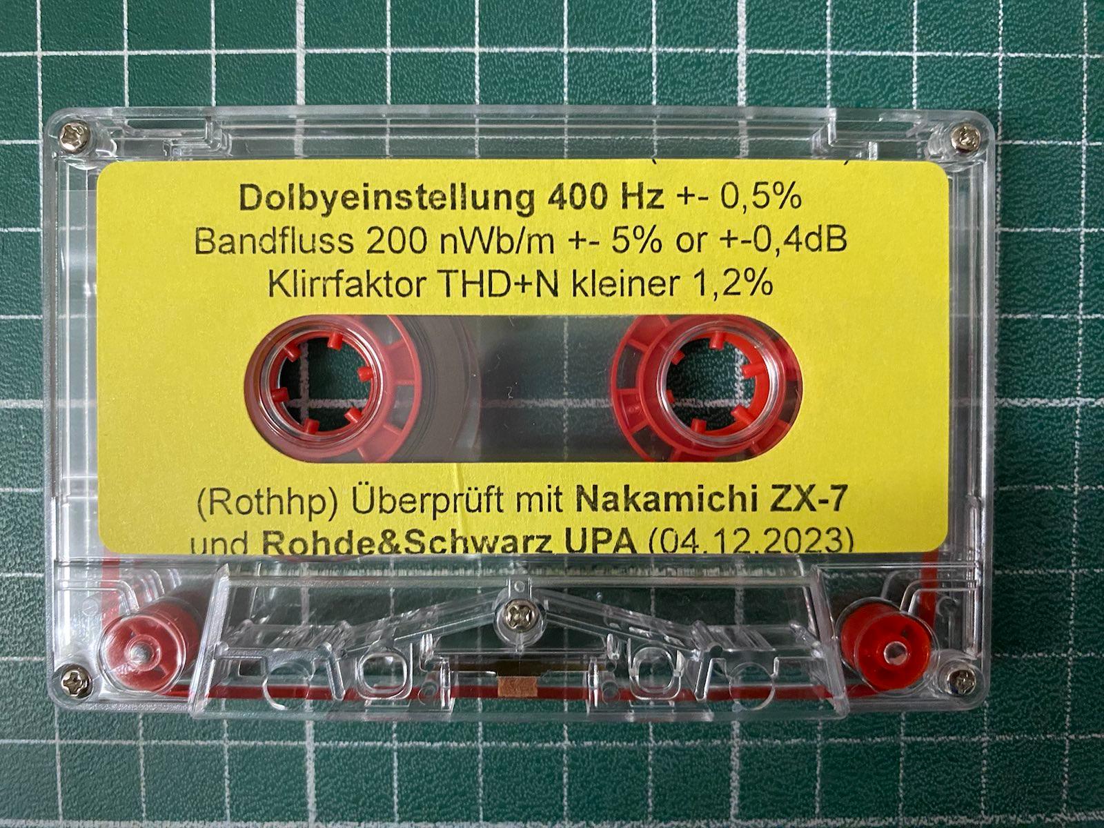

    I have uploaded the captures. Dolby Test Tape, set to CrO2 and DOLBY NR OFF on all 3 samples.

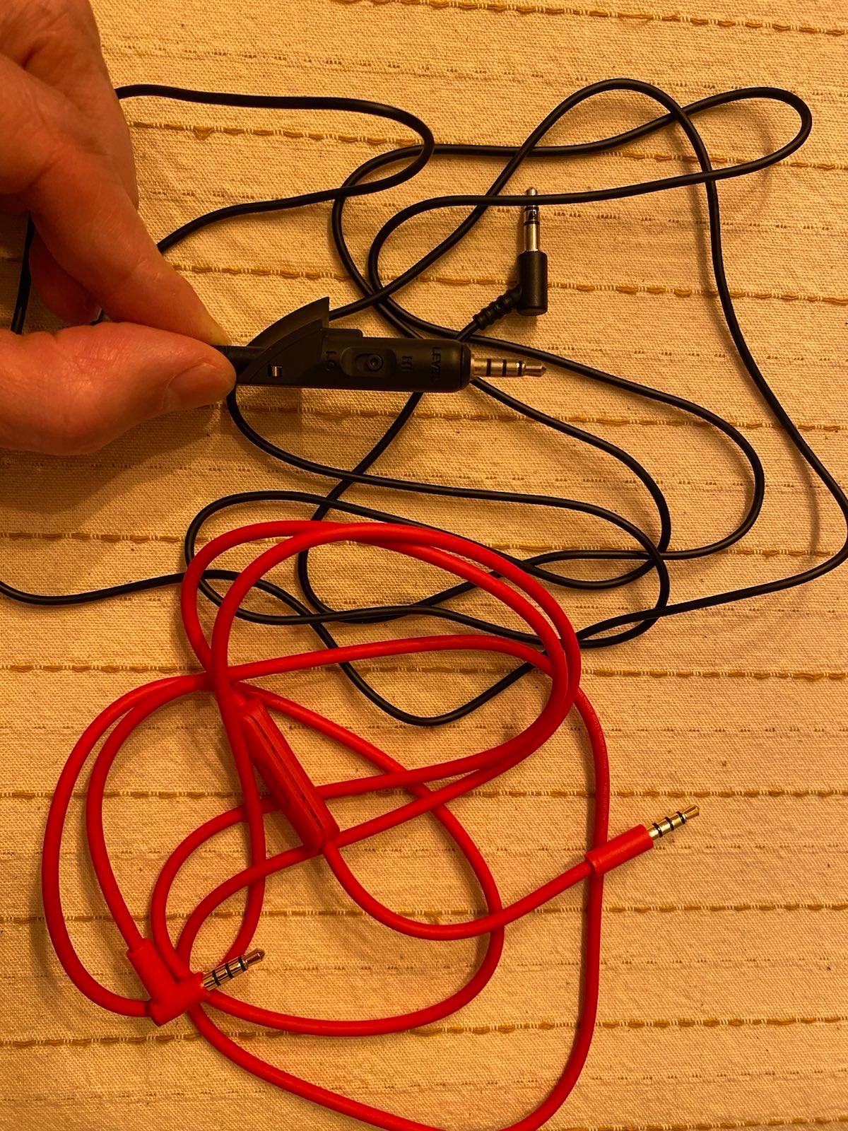

    You were right! :confused: I've now tried with my daughter's headphones, which is a Beats Studio 3. It even has a 4-pole jack. And surprise - no difference between Line Out and Phones Out, and no connection issue at all... So the difference I hear between the 2 outputs is totally to blame on my cable with the Bose headphones - can't really understand how/why.
    The Bose cable is the black one, the Beats cable the red one. What I can imagine is that the Bose cable seems to have a pre-amp incorporated, must be the culprit...
    I'll re-measure the PB levels now, with and without 47k load.

    Can't draw any conclusion at this point as the test tape does seem to be good: on the DD33 there is a small imbalance but it's below 1dB.

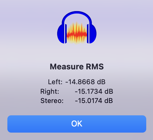

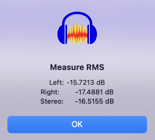

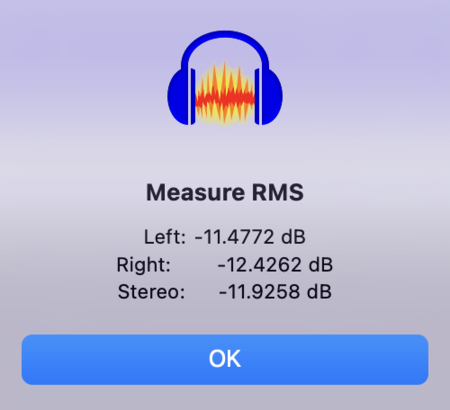

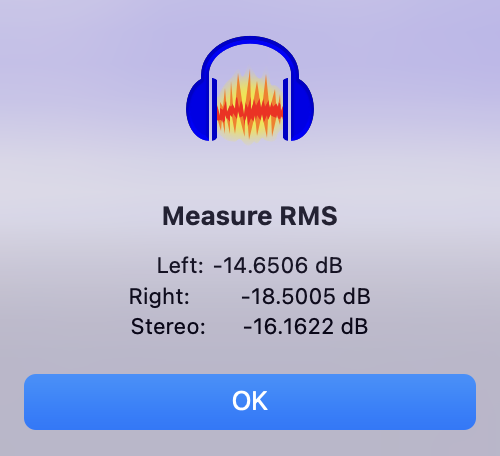

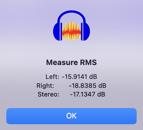

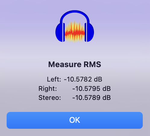

    I've installed Audacity and tried to replicate your measures (as part of my learning curve and understanding your analysis). I see the following:
    Known Good Cassette
    • WM-DD 33: Left -15.7213 dB, Right -17.4881 dB, diff 1.7668 dB
    • WM-D3 Line Out: Left -15.9141 dB, Right -18.8385 dB, diff 2.9244 dB
    • WM-D3 Phone Out: Left -14.6506 dB, Right -18.5005 dB, diff 3.8499 dB
    Dolby Test Tape
    • WM-DD 33: Left -14.8668 dB, Right -15.1734 dB, diff 0.3066 dB
    • WM D3 Line Out: -10.5782 dB, Right -10.5795 dB, diff 0.0013 dB
    • WM-D3 Phone Out: -11.4772 dB, Right -12.4262 dB, diff 0.949 dB
    I guess the way I calculate the differences is not the correct one (just substracting one number from the other) but the way I understand this is:
    • there is always a difference between Line Out and Phone Out on the WM-D3, Phone Out seems to amplify any issue
    • the Dolby Test Tape is spot on on all units (no noticeable difference between the 2 channels)
    • the recorded tape however shows imbalance - as well on the WM-DD 33 ???
    I must say I'm a bit confused now :(
    I'll look at your other article and revert.

  7. Valentin
    1,676
    There is a difference because of the stereo potentiometer which adds a little bit of imbalance, but as we can see it's pretty low at just below 1dB. Wouldn't really consider this an issue and it's definetely not the cause of what you are hearing in the audio.
    Yes the Dolby test tape does seem to be spot on, which is good news since this is the only one available at the moment.
    The known good tape does seem to have some imbalance itself, but that imbalance seems to be much higher on the WM-D3.

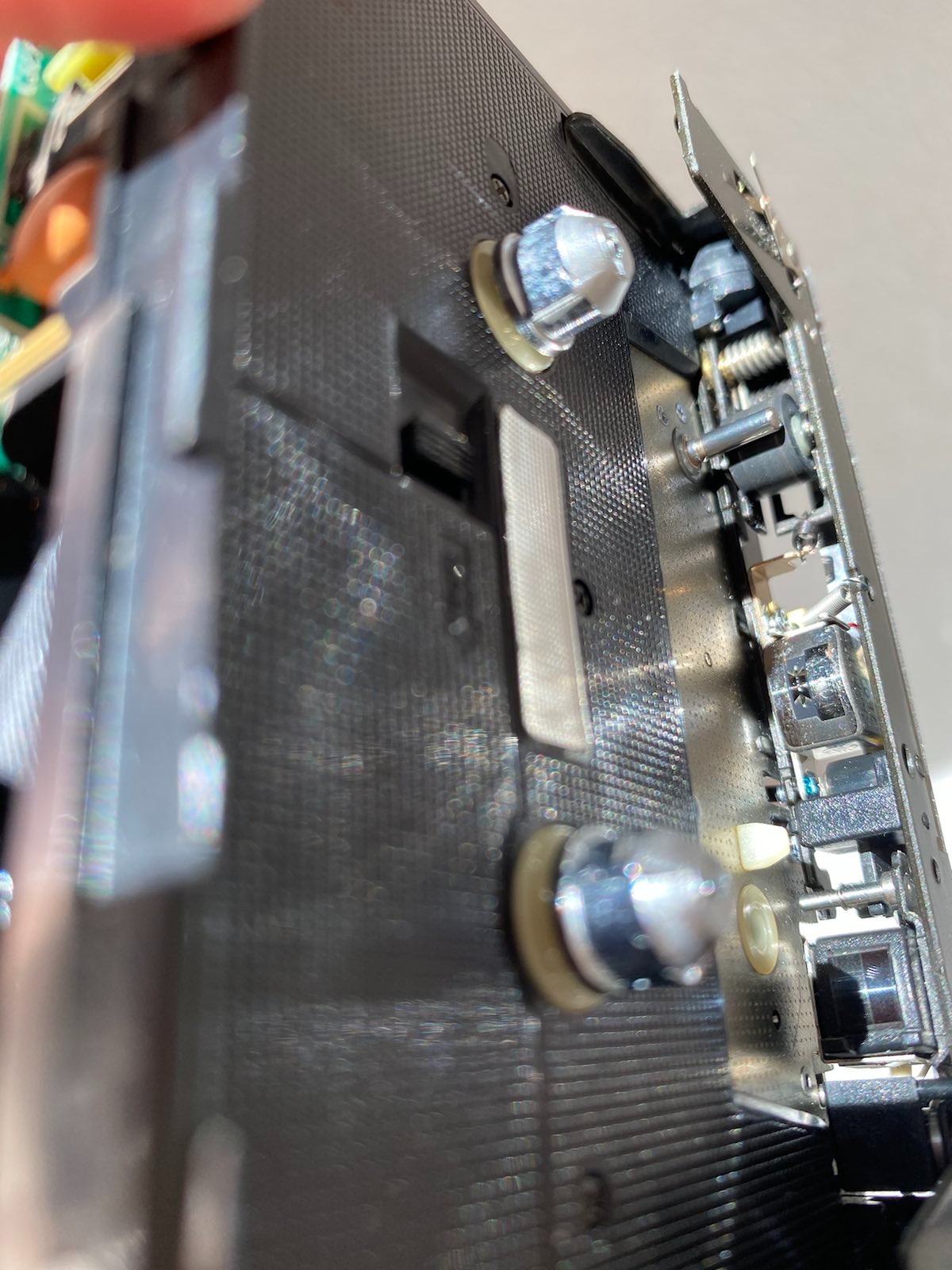

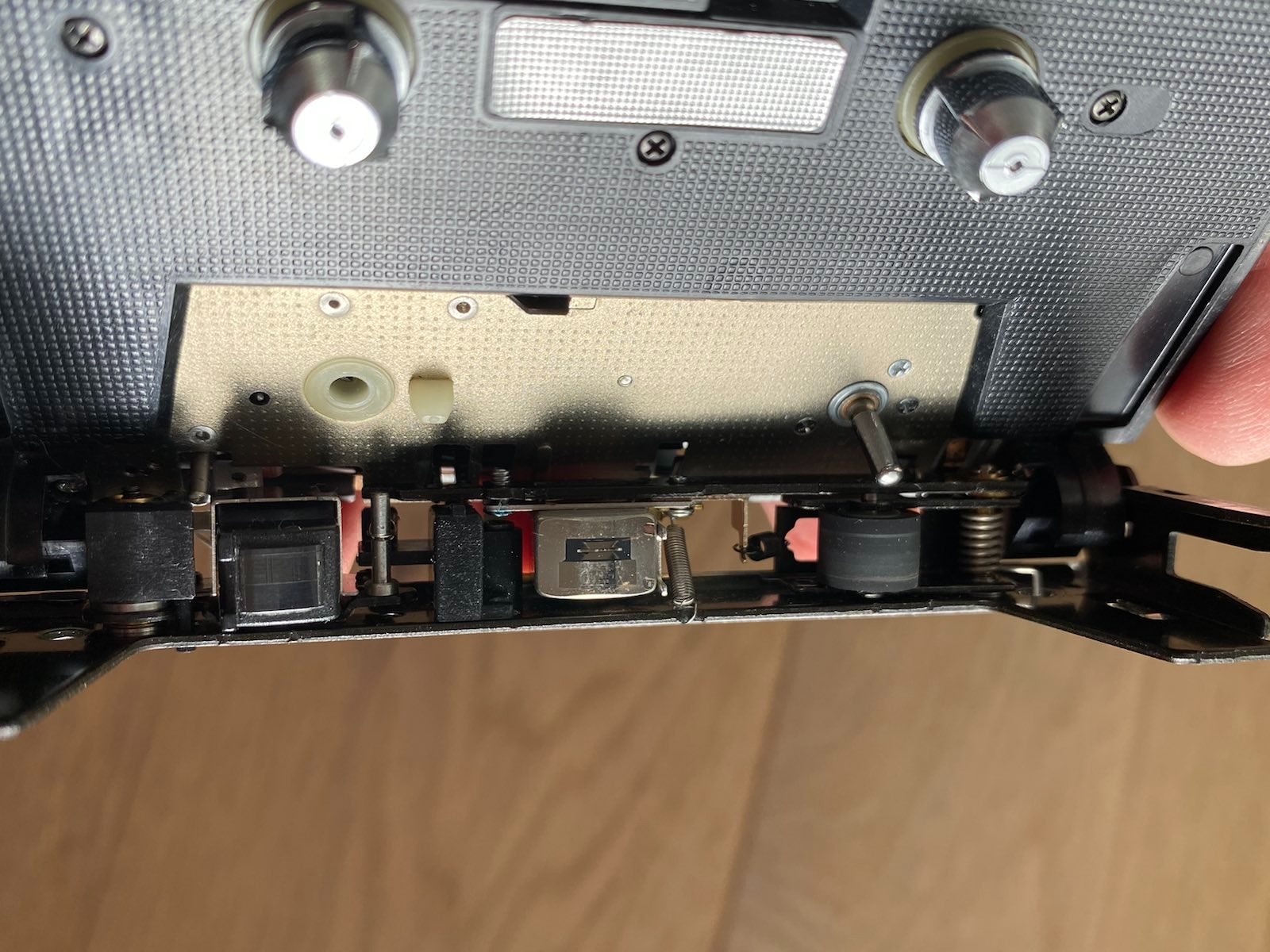

    What I do notice in your picture of the unit, however are 2 things:
    - the pinch roller defintely sits at an angle relative to the capstan, typical problem as I have already mentioned in previous post.
    It can be seen by 2 different oxide marks, one above middle of roller which is much more pronounced.
    - think I see some pittings on the head. Some more clear pictures where the middle of the head is not in a shadow would be helpful.
    As for springs, you're not missing any the one near the head is there.

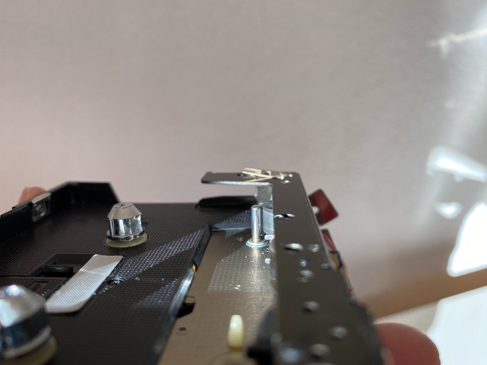

    Strange, I don't really see this:
    I see what you mean, but since the capstan seems indeed to be parallel to the pich roller how is this possible?
    Sun is shinning a lot today :cool: I hope this picture is good enough:

    Indeed the roller seems mostly parallel to the capstan, there is a very slight misalignment, but it's small enough that I won't bother to adjust it.
    It may be due to the tape itself, some new pre-recorded tapes can do that.
    In regard to the head, there seems to be some wear but it's impossible to tell if that is actually causing the imbalance. It's possible, but unlikely.
    Only test you can do now is to observe the tape with door removed. Does the pinch roller tend to pull it up or down during playback ? Even if just very slightly ?
    The fact problem appears with some tapes but not others (test tape) is an indication problem is in the tape path, not in the electronics.

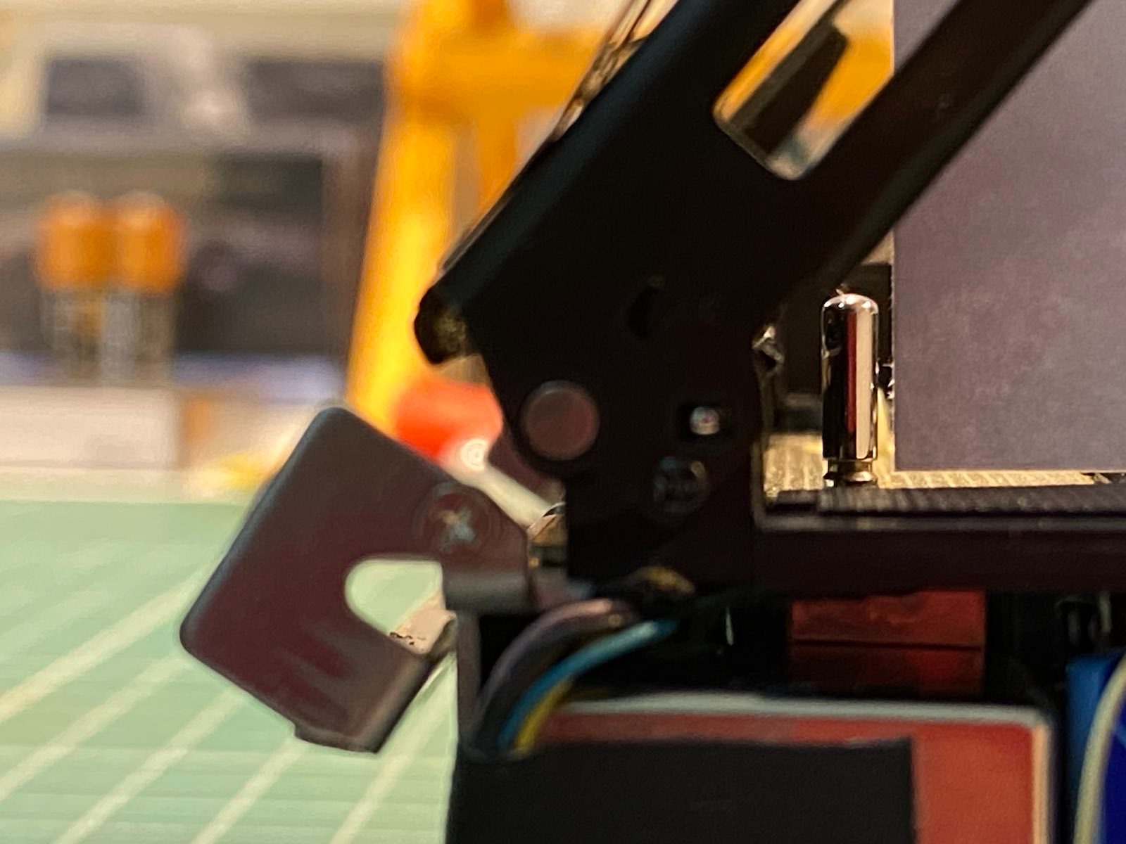

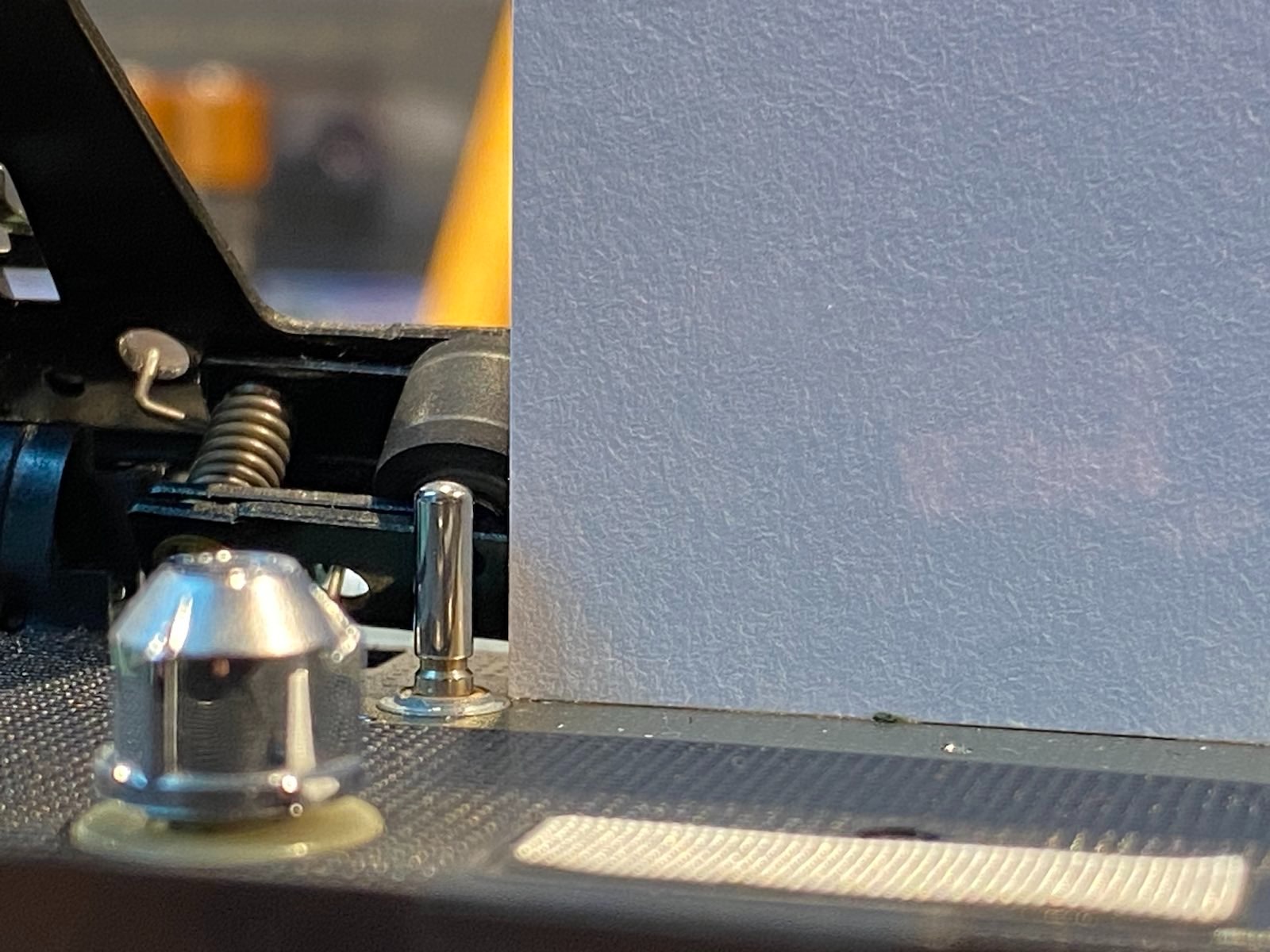

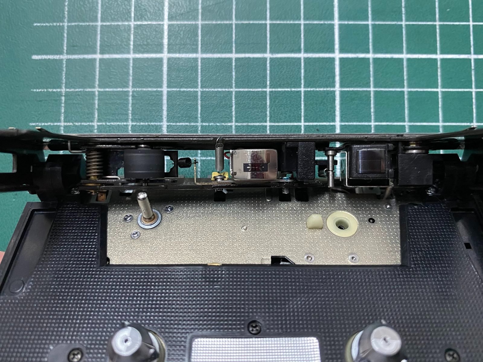

    Pretty sure I didn't miss any shim when replacing the central gear though :( The washer was on the capstan axis, I did check as this was an issue I faced with my WM-DD 33 (lost it and replaced it with a home made one from PTFE film).
    I've tried to make a couple of pictures - to me it would seem in the middle, maybe slightly leaning towards upper-right corner (probably your eagle eye will see better). Difficult to take a good picture given the sort focal (lens barrel distortion).
    Shouldn't I try to tweak the tape path alignment screw (from your WM-D3 tutorial)?

    In the case of the WM-D3, that "tape path alignment" screw is for something else, specifically for adjusting the height of the erase head. Recommend not messing around with it, especially because it seems the original lock paint is still intact.
    What you can do for peace of mind is observe the tape (use a transparent shell cassette like the ones above) at the erase head and see if there are any curls where the guide is.
    However, your issue is in the pinch roller area and that's where the focus should be. Given you say you didn't lost any shim, you will have to add some yourself.
    So proceed in removing the capstan, then the FG coil and add one some small pieces of paper (80g/m2) to the right edge (the one towards the center gear) of the coil assembly so you lightly tilt the capstan to the left (towards the head).
    Of course you might need to repeat this process and add one or two more pieces of paper until the problem goes away. You can use another material if you want, but I recommend paper since it's very thin (0.1mm).
    After each such process, be sure to put the unit in FF or REW and clean the capstan of residual oil before using it with a cassette.
    Indeed from the pictures I can't see any obvious misalignment, but thing is the cassette itself has some left-right play inside the cassette compartment, so it's pretty hard to make a diagnosis just on visual inspection.

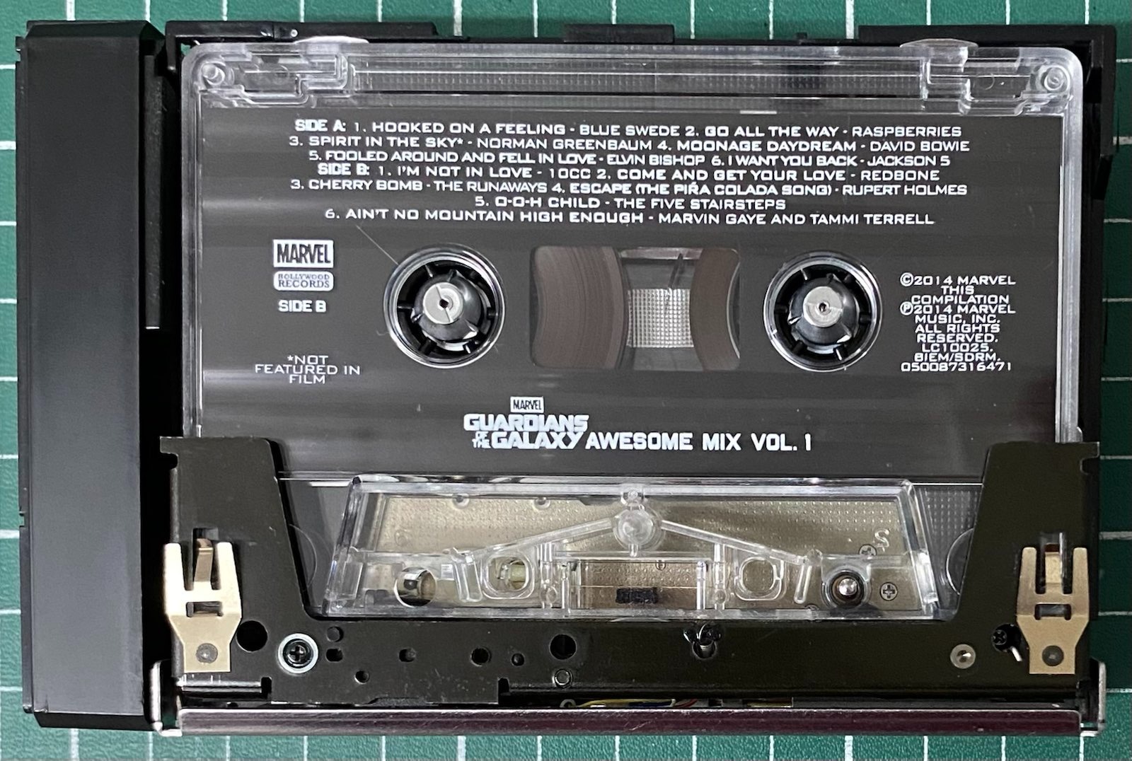

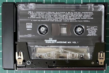

    EDIT 1: before embarking in the shims journey, I've just tried to measure how tilted the capstan is compared to the deck, and took a couple of pictures. Actually it doesn't seem to have any tilt at all...
    I have also filmed the test of moving the pinch roller towards the capstan: https://www.swisstransfer.com/d/c0b8da1f-c4e9-4c64-8285-87bc457c2815
    It would seem the issue is indeed with the pinch roller, as you hinted before. I can see that it's not really barrel shapped as you mention, and it would seem that the bottom part is touching the capstan first (although barely discernable, at least to my eye, on the video).

    It's been a while but I finally received my new pinch roller and managed time to change it on the unit, following your tutorial which was very clear and easy to follow (thanks for it).

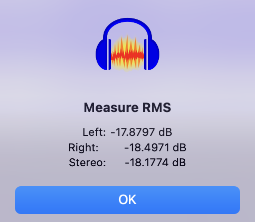

    Having made a first visual check on the tape path, it looked like the tape was not being pulled down anymore so I was full of hope when I made my test recording... Although the imbalance seems far less (1 dB max as per the RMS measurement in Audacity, but still present to the ear), I now have awfull wow & flutter.
    I'm now close to desperation and of throwing everything through the window :mad:
    I've captured the recording, the RMS analysis, and uploaded the visual tape path check: https://www.swisstransfer.com/d/dca59085-fe10-4168-aa62-4779a291ca5b
    All springs are back to their location, pinch roller was oiled, I followed everything... Any idea what I'm facing now?
    EDIT: I forgot to tell that I went through the whole adjustment procedure as well (PB & recording levels), and adjusted the left channel, before my recording attempt.

    Have you thoroughly cleaned the pinch roller and capstan after replacing it ? How does the roller look now relative to the capstan ? Are they parallel ?
    Watched the video, indeed can't see any tape pull but there's a catch. What cassette have you used ?
    As from what I remember, it didn't have any pull with the test tape even before, but it did with pre-recorded cassettes.
    Personally, I'm skeptical just replacing the pinch roller solved the misalignment problem... hence why I would test visually with 5-10 different cassettes before drawing the conclusion.
    The RMS analysis isn't that relevant if it's only valid for that specific tape. If we look at the measurement, imbalance is below 0.5dB yet something is clearly audible (at 0.3dB it won't be).
    Have you re-adjusted the playback levels ? Azimuth may also need some small adjustment.
