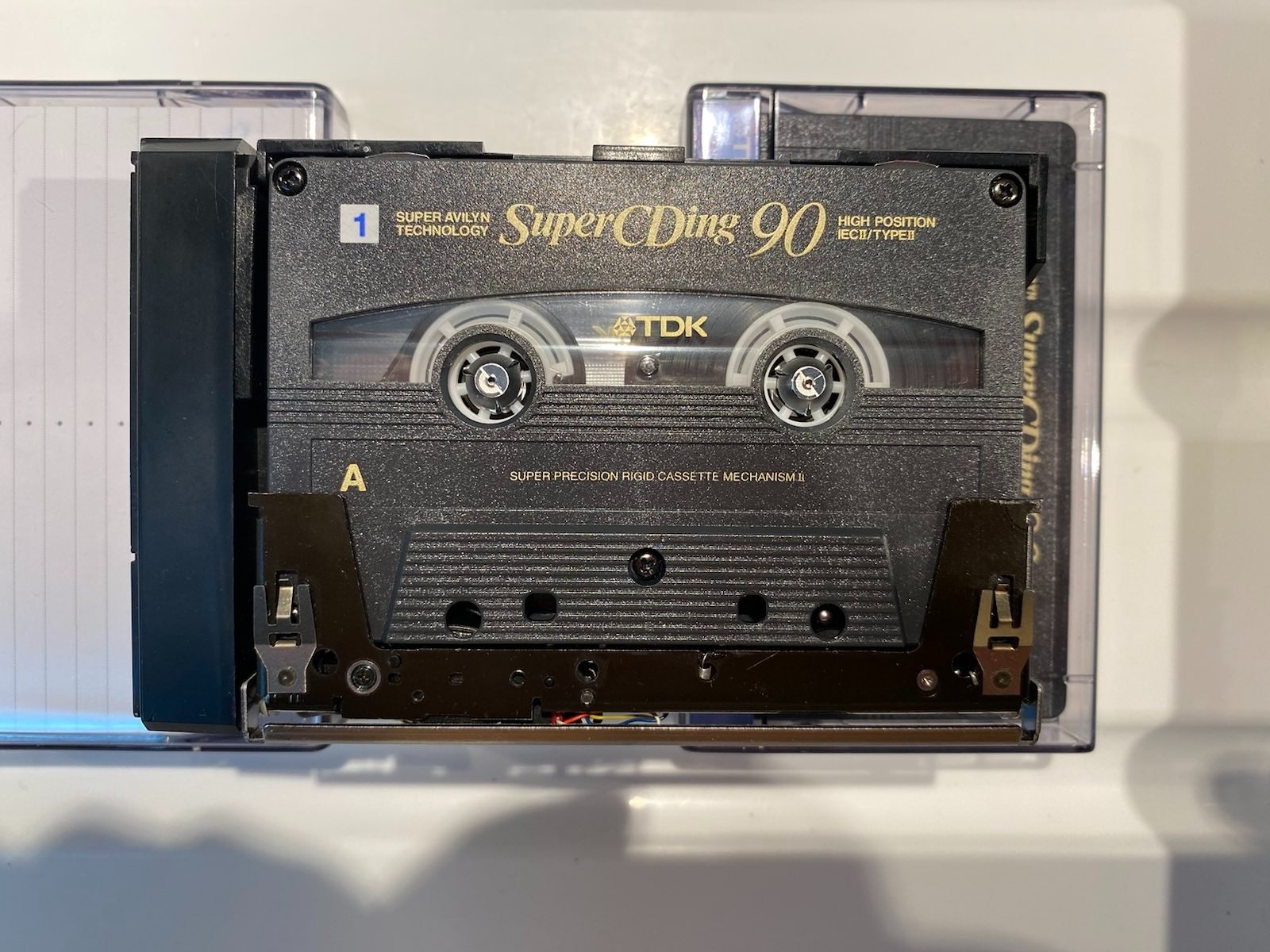

    Eventually, I managed to narrow down the issue to only that of wow & flutter - at least I believe so.
    Indeed, when recording at the beginning of my brand new tapes (TDK Super CDing 90 Super Avilyn), i.e. take-up spool empty, I've managed to have a pretty good balance (see attached RMS analysis of the recording of a 315 Hz signal through Line In) - so I believe that my issue was indeed coming from the pinch roller and has been solved by its replacement.
    I am therefore left with the wow & flutter issue - which gets worse and worse as the tape advances, up to a point where the tape will simply stop while recording.

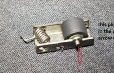

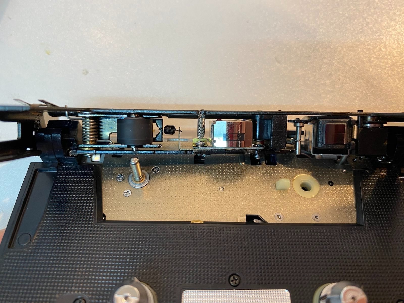

    I suspect the issue is with the frame that holds the pinch roller, or the spring that hooks it to the head carriage, which create too much pressure on the tape.
    I've identified that if I slightly press on the frame holding the pinch roller, that wow & flutter effect disappears - see video: https://www.swisstransfer.com/d/43d3dbe2-b6b2-4a84-b4bd-16ff33acda4e
    Does that make any sense? The big spring looks symetrical to me, could it be that when I put it back I switched it and that it created the issue?

    That is something only you can tell, but if that imbalance is not present while playing the same tape on the WM-DD33, it's pretty obvious the problem is not in the recording.
    Pretty unlikely that there's an imablance in the recording done on purpose, but of course it's not an impossibility.

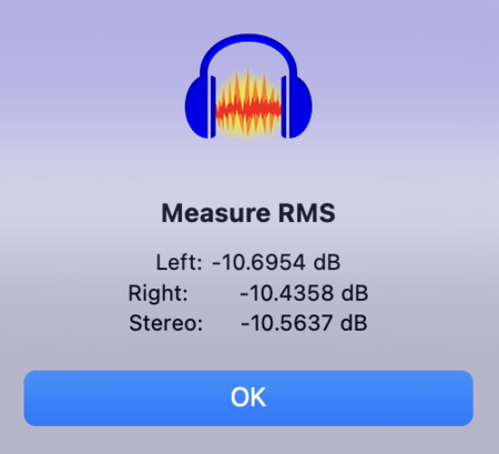

    The attached RMS measurements is near perfect if you ask me. What I would be concerned with is not so much the value itself, but if this values is consistent with all tapes and at every playback/recording.
    W&F - too much pressure or too little pressure on the capstan can create high w&f.
    If the pressure is too high, it will load down the motor too much, making the servo unable to maintain a constant speed. This has to be extreme though.
    If the pressure is too low, the tape will simply slip between the capstan and the roller, as the takeup reel will put more force on the tape than the capstan.
    Watching the video, it seems like you increase the pressure, so it's the second scenario (which is the most likely).
    As for the springs, the black one is symetrical doesn't matter which way you put it. However I believe something else might be going on: somehow the head bridge cannot fully move into position.
    So you need to check everything as you most likely put something wrong given the problem didn't exist before replacing the roller.

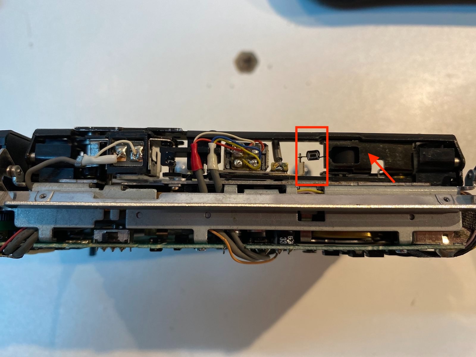

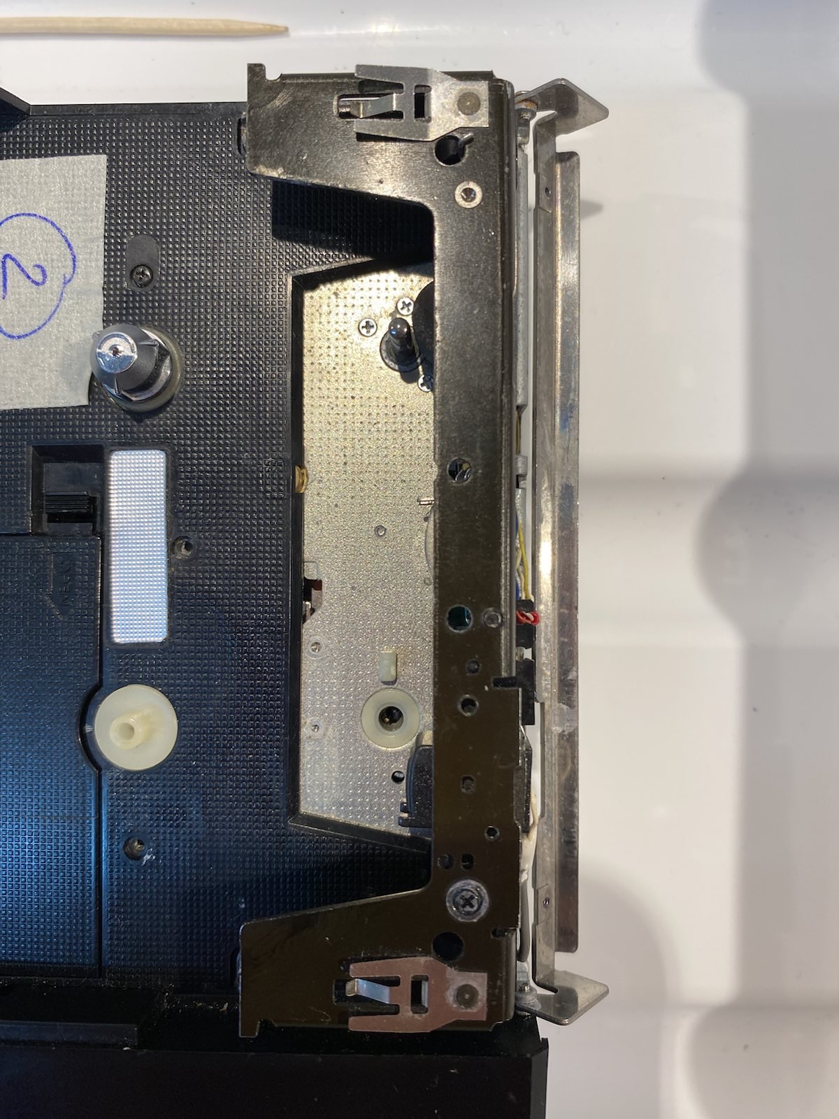

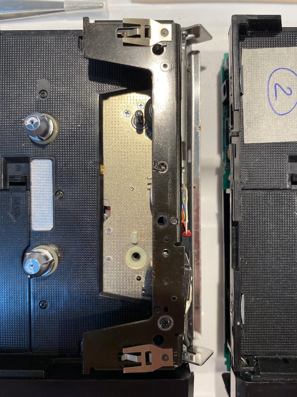

    I've managed to get another WM-D3 unit for very cheap (I was super lucky) that I will repair later on. I can use it as comparison point for now, since I didn't touch it yet. It was sold as non-functioning and only for spare parts, but I believe comparison is still valid.

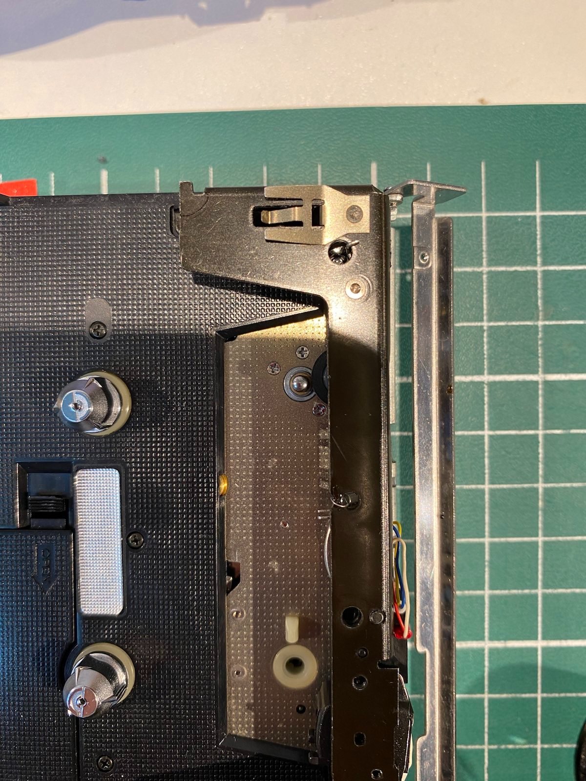

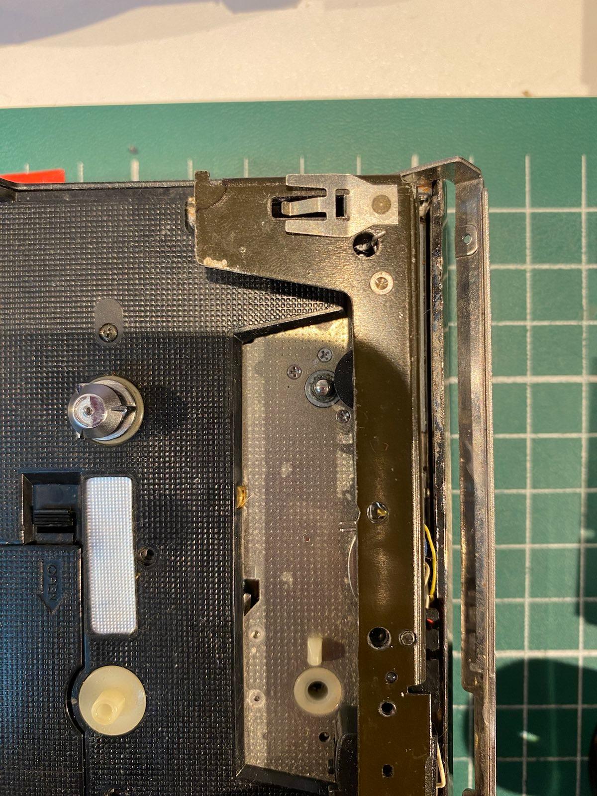

    What I see is that the distance between the pinch roller and the capstan is higher on my under repair unit, than on the comparison one... That's weird, because I've checked the original pinch roller diameter with the new one (I've bought 2 from FixYourAudio shop so still have a new, spare one) and they're the same at 8.7 mm (that said the precision of my caliper may not be enough to actually show the difference) - still I can see a difference, which is visible if you zoom in on the 2 images below.
    I've also filmed the movement of the head carriage, which seems normal to me: https://www.swisstransfer.com/d/c58ec4a3-75cf-401b-a79b-07cb41dc2dc2
    I suspect the wider gap between the pinch roller and the capstan is my issue, but I really don't understand where it can be coming from, as the head carriage seems well assembled and the pinch roller diameter is apparently the same...:eek:

    I can see the small difference you mention in regard to pinch roller position. Can be related to the position of the roller assy or the dimension of the roller itself.
    In regard to the measurement, a caliper is more than enough to measure the diameter. Differences of less than 0.05mm (which is a typical resolution for a caliper) are completely irrelevant in this case.
    Looked at the video, with carriage in opened position I can see it can extend beyond the normal loaded position, so apparently it seems to be working fine at least in opened position.
    However, there are still some things to be checked: note that the head bridge has a stop point on the plastic part (see picture attached). Does the head bridge extend up to that stop or not ?
    Also, when in PLAY, does the small black spring get more tensioned compared to stop ?

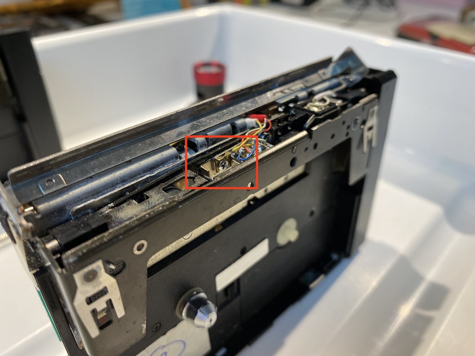

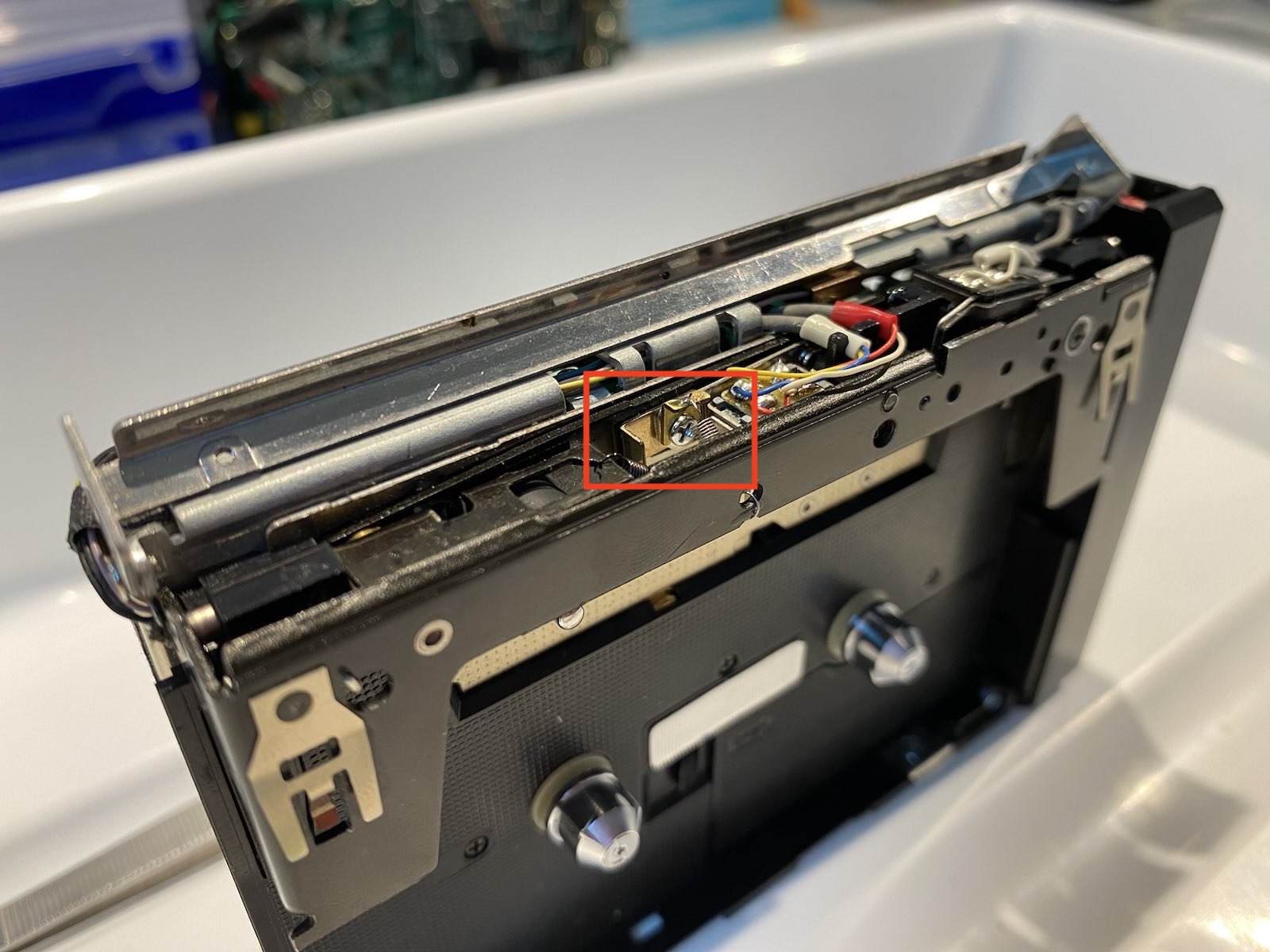

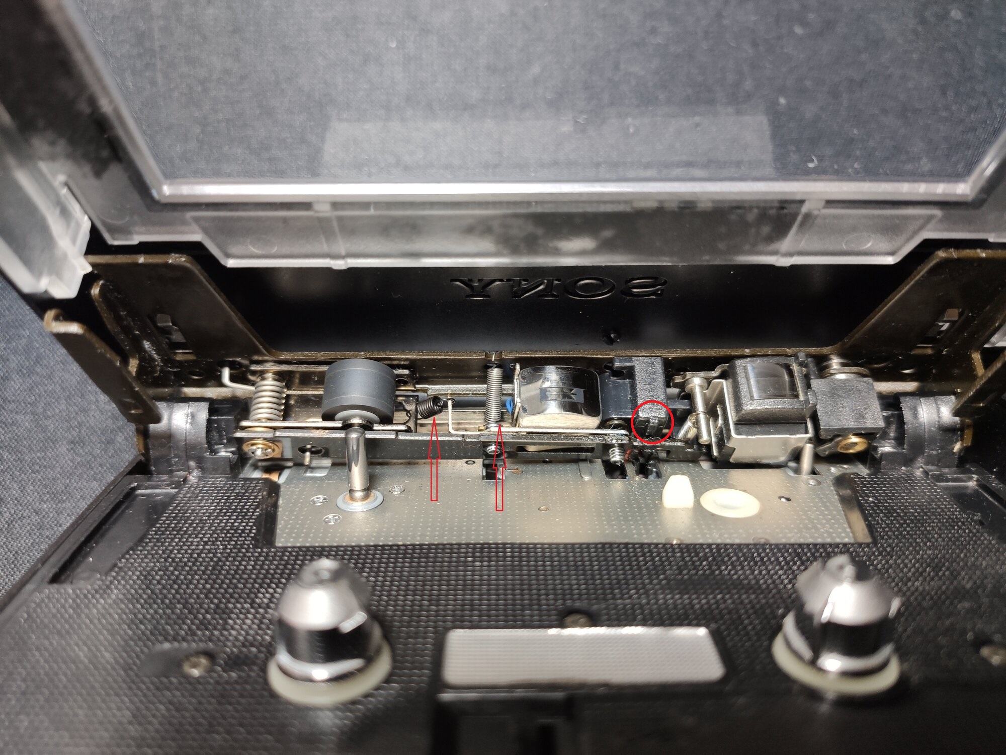

    I've been scratching my head for the past few days, observing everything and trying to identify the root cause...
    I understand from our exchange that my W&F issue is coming from the too low pressure the new pinch roller is exercising on the capstan - right? Then, I believe it is due to the higher gap between the roller and the capstan than the one I can see on my spare unit - also given the fact that if I put some slight pressure on the roller assy it is correcting the issue.
    What I can't understand is where this wider gap is coming from. Roller diameter is the same, springs hook as they should, can't see any difference between the 2 units in that respect.
    The one thing I suspect somehow, is that the playback head is protuding a bit more on the spare unit, which in turn would make the pinch roller closer to the capstan due to the small black spring - see first set of pictures. Then, I tried to understand where it could be coming from, and noticed a very slight difference in the plate holding the screw in the second set of pictures, with the one on my unit slightly protuding backwards - see second set.
    Yes, I have uploaded a new video to show: https://www.swisstransfer.com/d/fcf57f50-009a-4246-b30d-305631d6f288
    Yes, it does.
    Would the PB head position explain my problem - and if so how can it be adjusted? I don't see how I could have changed anything with that plate when changing the roller, so I'm wondering if I'm not looking in a completely wrong direction.

    Looking at the video I see nothing wrong, but question still remains: does the white plastic slider move the head bridge into fully extended position ?
    Because you may have a problem with the plastic slider/play button not fully latching. The fact the bridge is moving freely is just half of the check.
    Another thing to check is to put the unit in play and retract the roller from the capstan: see how much force it takes.
    Then also try to stall the roller without retracting it. Are you able to put load on the motor by doing that or the roller is just slipping ?
    This may suggest something else: that on the reference unit the head bridge is not fully retracting to that stop point, hence why roller is closer to the capstan. If that's the case, the reference unit has a problem not the other way round.
    In regard to the plate that holds the head spring, that can be moved forward: just get the screw a little loose, push it forward and tighten the screw back.
    However that would affect head bridge position only when the door is installed and only in stop position, not with door removed.
    Also, have you checked the motor is turning freely in both directions ?
