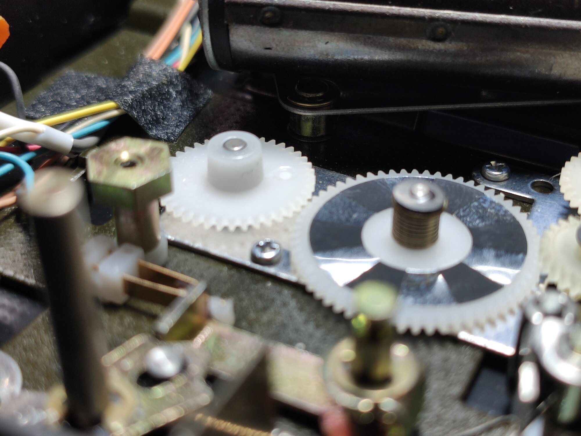

    This thread covers a problem found in WM-D6/D6Cs.
    Problem manifests as follows: the supply reel rotates while there is no cassette inserted, but as soon as load is put on the reel (a cassette inserted) a loud gear noise can be heard and reel stops rotating.

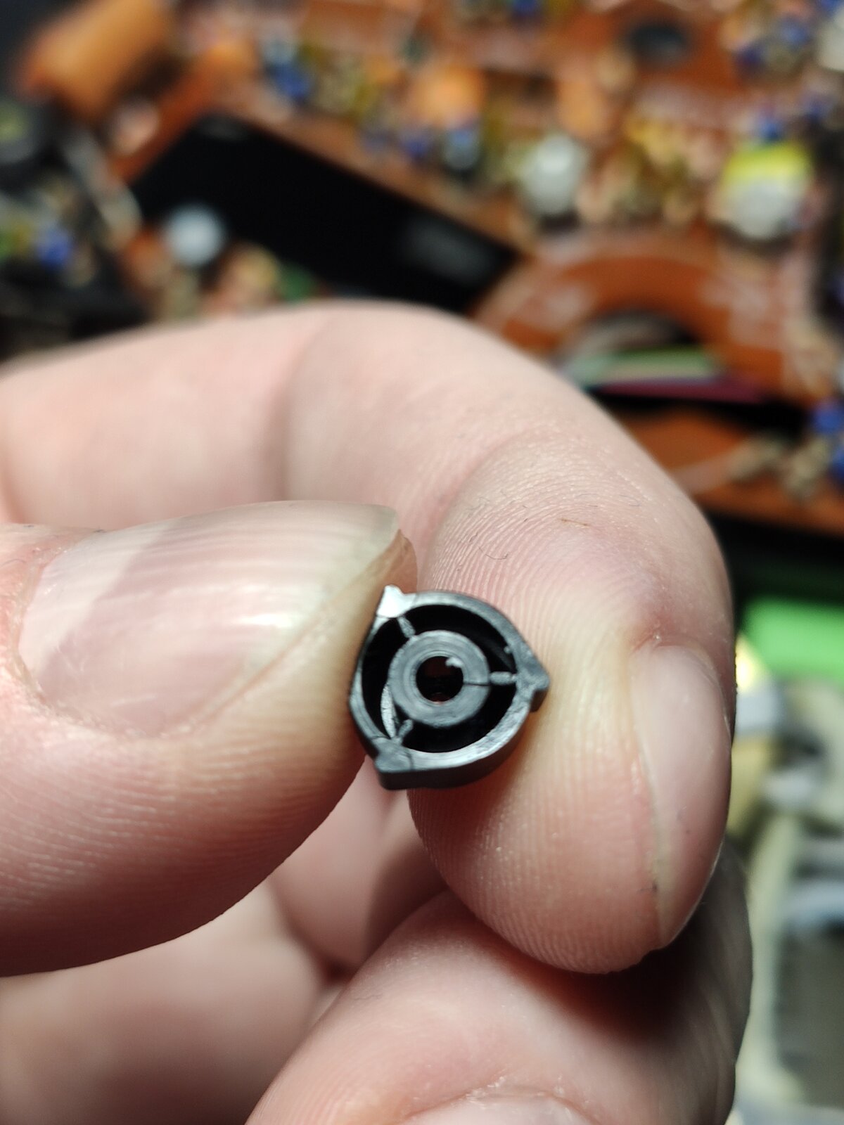

    The root cause of this problem is a cracked table reel.
    What happens is the shaft becomes loose in the reel hence creating up-down play in the drive gear as seen in attached picture.
    Solution is to glue the shaft to the reel with super glue.
