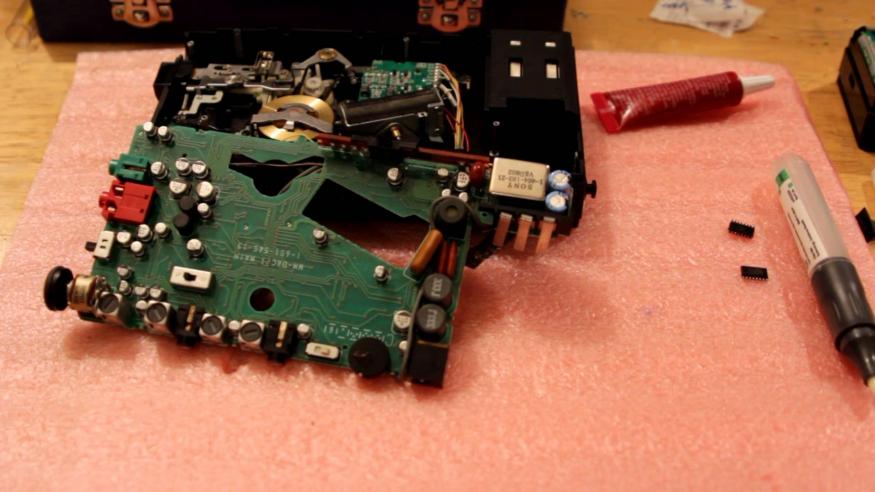

    I could not find any grey wires jumping the board next to h/p connectors, and then realized that mine is D6, not D6C. Here is D6 photo before restoration:

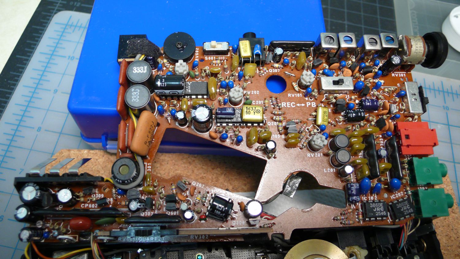

    D6C went through quite a few "upgrades" with the first ones looking like D6, then like this:
    and finally like this (these two photos got "borrowed" from the tapeheads thread):
    And then there was Light!... sorry, iPod!!! ;)
    So... unless you post the photo of your D6C folks won't know what to look for

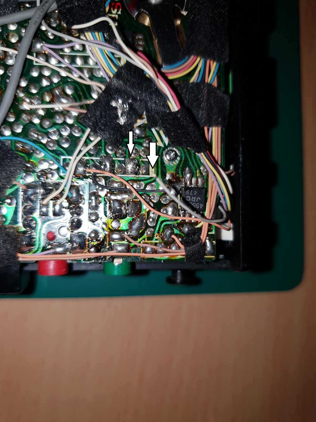

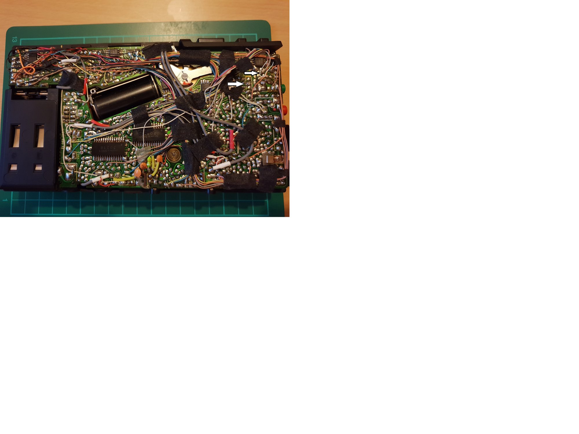

  6. lupogtiboy
    lupogtiboy Well-Known Member
    468
    Right, a couple of images of the cable and where I've soldered it to. I've studied the wiring diagram til I'm blue in the face and this is where it looks like it goes to, doesn't affect its operation whether its attached or not! Shown with the white arrows....
  7. Deb64
    296
    Leicestershire, England
    I think the grey wire is the one which connects from the tape type switch (Norm, CrO2, Metal) on the LED board to pin 2 of the CP302 record EQ switching module. This won't affect the sound on playback but will make a difference to the equalisation when recording. The wire is shown as No.8 on the layout diagram.
    This wire is nothing to do with the motor drive circuitry. Unfortunately the speed stability problem not something which I can diagnose remotely. I would need to hear the problem and check through the circuit with an oscilloscope. If you would like me to take a look at it, please PM me.
