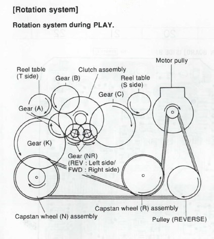

    I attached a picture from the WM-EX1 service manual: if the side problematic is one driven by left capstan (that will be forward play), then I suspect something in those gears.
    Do you have some periodic mechanical noise when that variation of wow&flutter occurs ?
    Now that I think about it, despite this model does not have the problematic magnetic clutch, there might still be a problem with the clutch on this unit (Gear C on the diagram)
    If it's on the other side (right capstan, reverse play), it's either the new roller or it is possible that the capstan itself is bent.
    A forum member sent me a private message with this phenomenon some time ago. Look if the flywheel on the problematic side has any wobble while it rotates (although I doubt it).

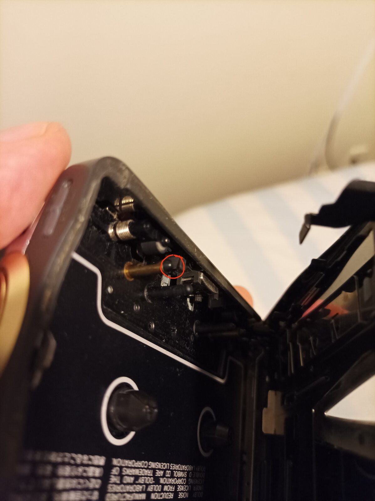

    I remember years ago that problem, It was due I lost the washer that locks the capstan, I put another similar but the wow & fluttter was increased. There is a plastic cap covering the washer, you have to remove It to see the washer, check both washers holds firmly the capstan, and there is no an excess of movement up and down
