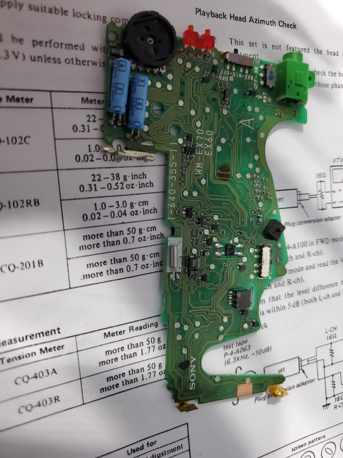

    Original capacitors measured: (1) 200µF, 2.1 Ohm ESR, (2) 220µF, 1.8 Ohm ESR. Either way it's out of specifications (20%).
    For example, new organic polymer electrolytic capacitors had a capacitance of 308–310µF and an ESR of 0.15 Ohms.
    I think it is clear that the original capacitors must be replaced. At least they weren't dead, which is a good sign for 30 year old capacitors.
    In the next few days, we'll see what measurements with a digital caliper tell me about the free space under the board for installing new capacitors.

    There is only 5.00 mm under the board, at best. Well, it's going to be tough. Of course, I will have to use a capacity smaller than the original one. Hopefully I can get these 270uF 5x11mm later.

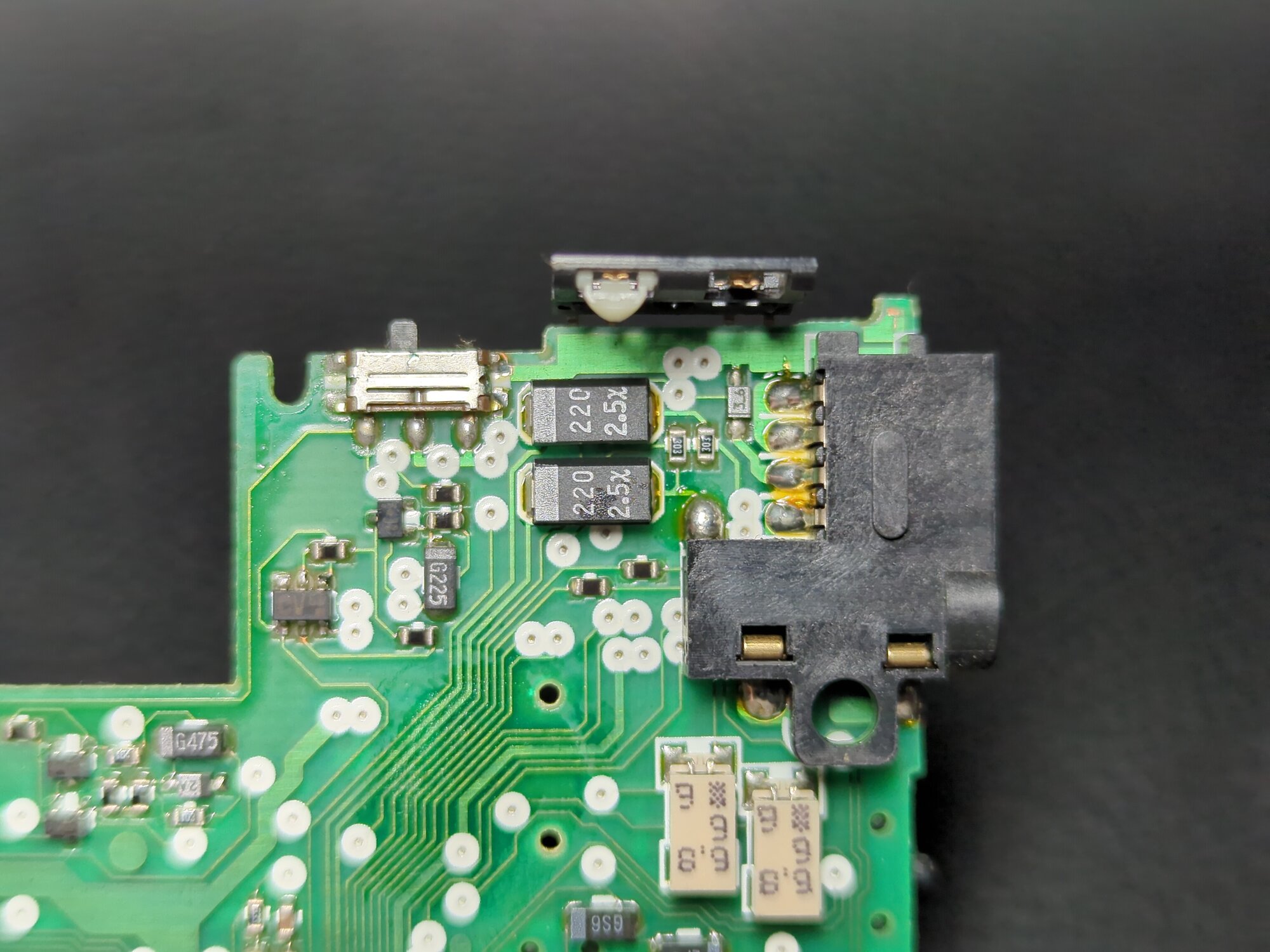

    20240604_233112.jpg John, I guess I should've posted the other side of the board last week, then you would've seen. You have better quality Headphone Amp caps than my EX60/70 board!! Going to check my ESR on this one. As I know one of my has a crackle that comes and goes.

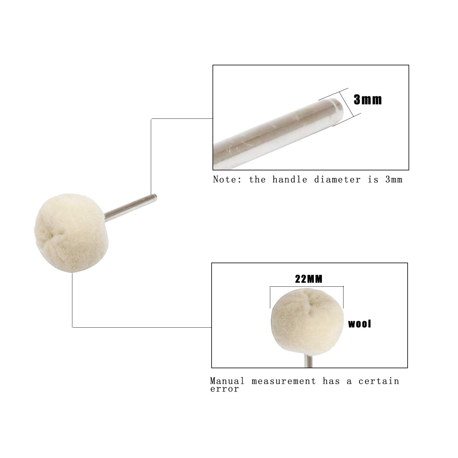

    In the meantime, I'm waiting for spare parts for electronics, I have a question:
    Are these cotton polishing wheels suitable for polishing the tape head?
    If so, I have a Dremel tool with a wide RPM range (5,000-35,000).
    What speed would you recommend?
    What polishing paste is best for this?

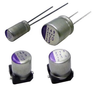

    Usually new small SMD capacitors can be used as substitute. Removed from their plastic base and legs folded out etc,. E-bay is also a source for older stock Nichicon and Elna in smaller sizes.

    If you're talking about aluminum organic polymer (solid state) capacitors, then yes, they have more choice in package sizes of 5mm+.
    Also, the capacitance is not high enough (<100 µF) in sizes 4-4.5 mm. For example, Panasonic 2SEPC330MZ (330µF, 2.5V, 5mm dia).
    But I have read that their high leakage current characteristics (~500µA) compared to conventional aluminum electrolytic capacitors (~3µA) will cause distortion when used in an audio path.
    They are ideal for power circuits (don't dry out, don't leak), but not as coupling capacitors in audio circuits.

    In regard to polishing the head, recommend using cotton swabs (those used to clean ears) cut in half since those typically have finer texture than polishing wheels.
    As paste, use fine automotive paste of your choosing. For speed, I think 5000rpm is too high for this application. Would rather use a cordless drill than a dremel.

    On the photo posted by @Duey71 there's an R in a square logo, which is the manufacturer.
    Seen that before and someone did mention here on the forum who was the manufactuer, but can't remember.
    Think the only solution to keep the original capacitance of 330µF is to use SMD tantalum caps, like T491C337K004AT. These have a 0.9Ω ESR and a leakeage current of 13.2µA.
    However this implies a bodge solution like glueing them upside down and add some wires to connect them. Not ideal, but it will work.

    In many portable devices there's only so much space for capacitors, hence why electrolytics may not be a suitable option despite having some advantages.
    For example many MD portables and even later WM-EX walkmans use SMD tantalums as output coupling capacitors. See picture attached.
    Also many new portable audio devices (DAPs, DACs/headphome amps, etc.) use SMD tantalums for output coupling.
    As far as opinion goes, I have recapped quite a few walkmans (especially AIWAs) with SMD tantalums because electrolytics in the original footprint were hard to find.
    Have been very satisfied with results, as far as listening goes. It may be interesting to do a comparison of aluminium electrolytic vs tantalum in the future, including measurements.
