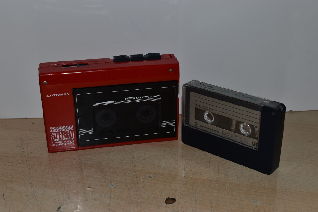

    Let's try that again, here's a few of my favourites :)
    Sony Walkman WM-D6, very nice condition though currently it is broken. Mute audio and plays too fast so I'm suspecting a problem with the internal power rail as has been mentioned online. I have the service manual so it should just be a case or checking for bad joints and or cracked tracks.
    My Toshiba collection, KT-R1 and KT-S3 with the FM tuner pack, both nice players, both require belts annoyingly.
    Now from the other end of the spectrum! Nice cheap Lloytron, works fine and in great condition other than the volume, play, stop and FF markings being worn off.
    You've probably spotted that I'm a fan of big boxy units by now! :p
